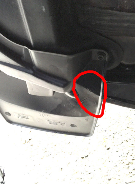

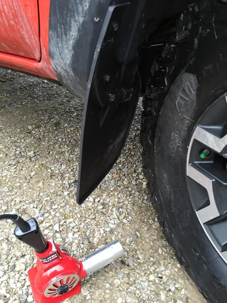

    image.jpg So I put BFG KO2 265-75-16's on my Taco and like many on here have posted my WeatherTech mud flaps rub. My solution was to carefully warm the area circled in the photo with a heat gun and bend it back away from the tire. You can do this with the mud flaps installed. Make sure you wear some gloves because you'll have to hold the hot mud flap away from the tire for about 3-4 minutes until it cools. The end result looks perfect and there's no more rubbing.image.jpg
