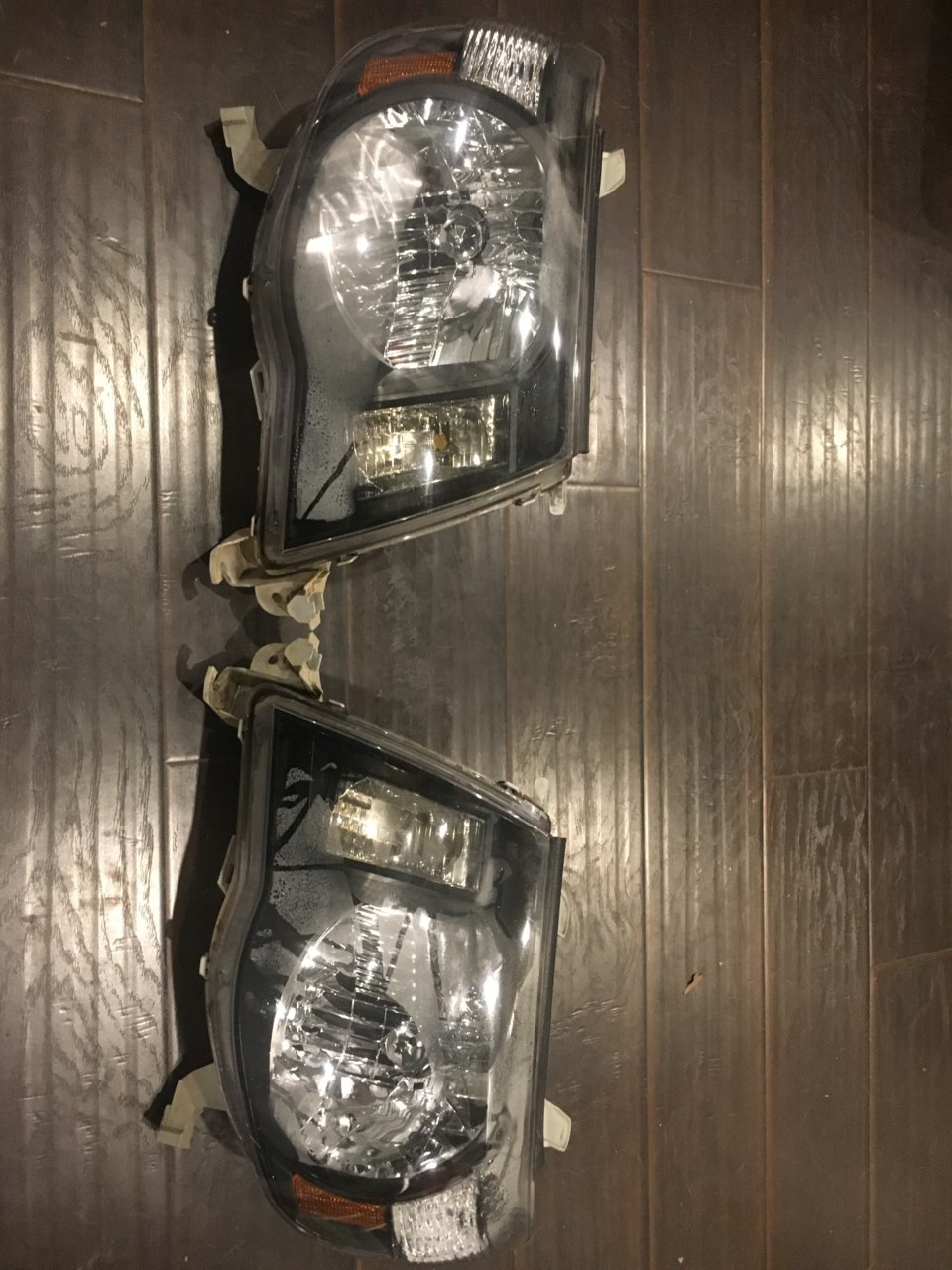

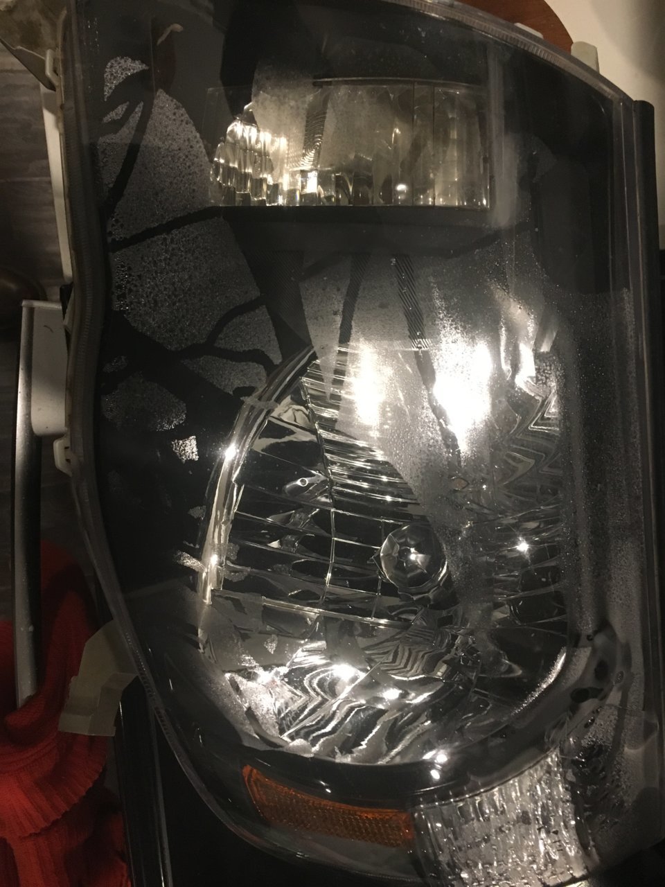

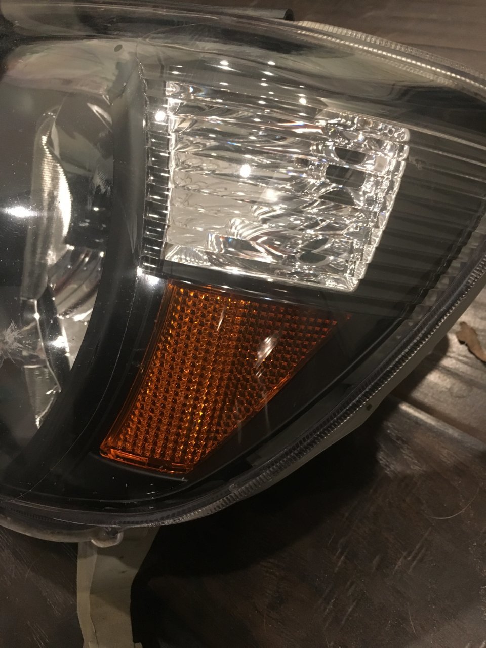

    Oil change complete. Now onto the headlight fogging issue. Upon removing the headlights I see why there is condensation in them. The silicone I used failed around the body of the headlight and where the lense connects to the body. I have cleaned them up and am now in the process of drying them out before I re-seal and re-install.

    All cleared up and ready to be sealed.

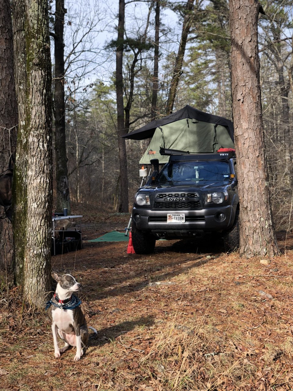

    Here are a couple of photos I do have of the tent deployed. My brother-in-law sewed all new material as the original materal unfortunately molded due to it sitting so long. His sewing skills are incredible as he did a great job and also added on a built in awning which you can see in the first picture. I don't have a great photo of the inside but the 3rd photo shows you a little bit of the wood work he has inside there. His dog's name is Townes in case anybody is wondering.

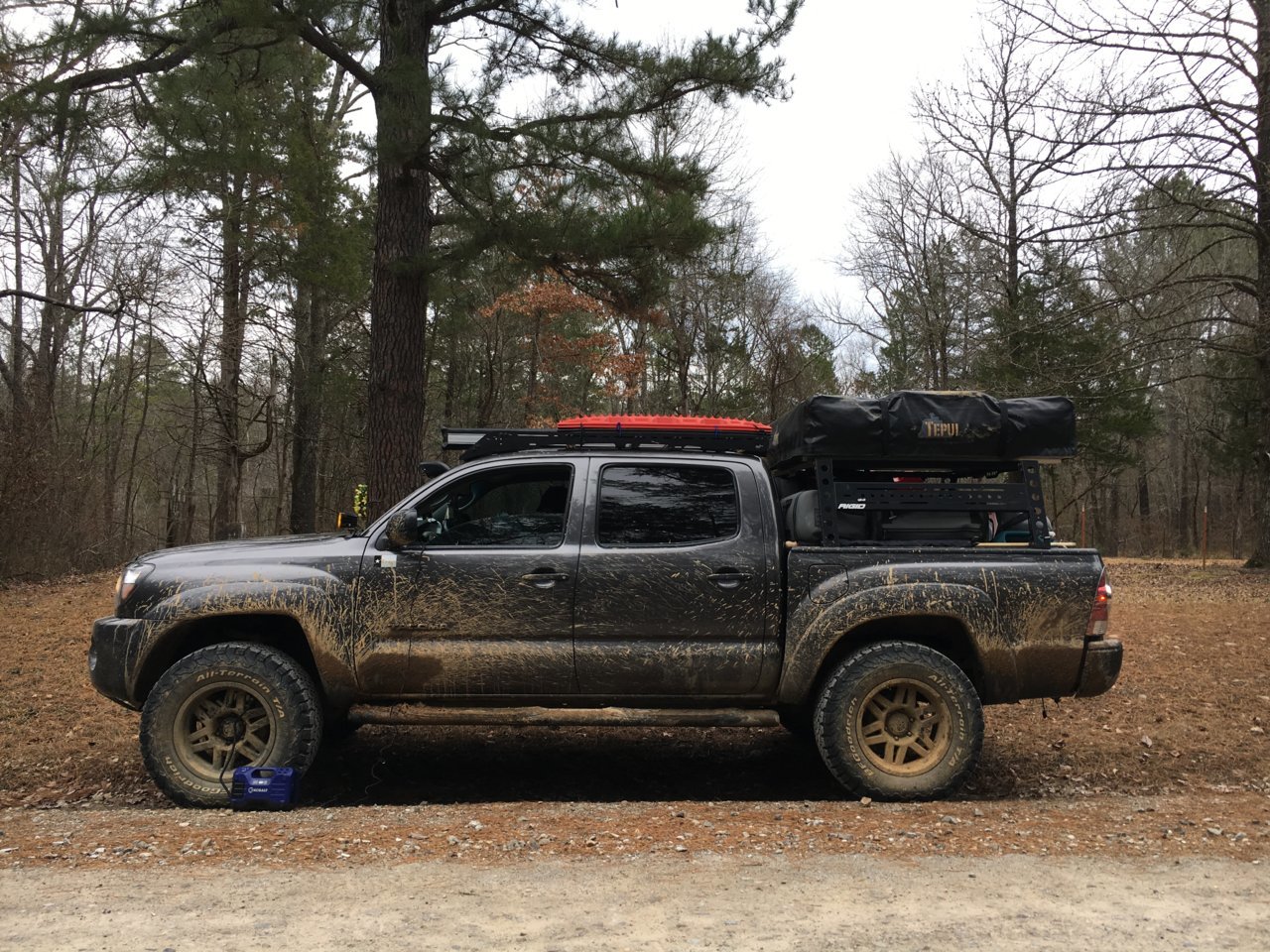

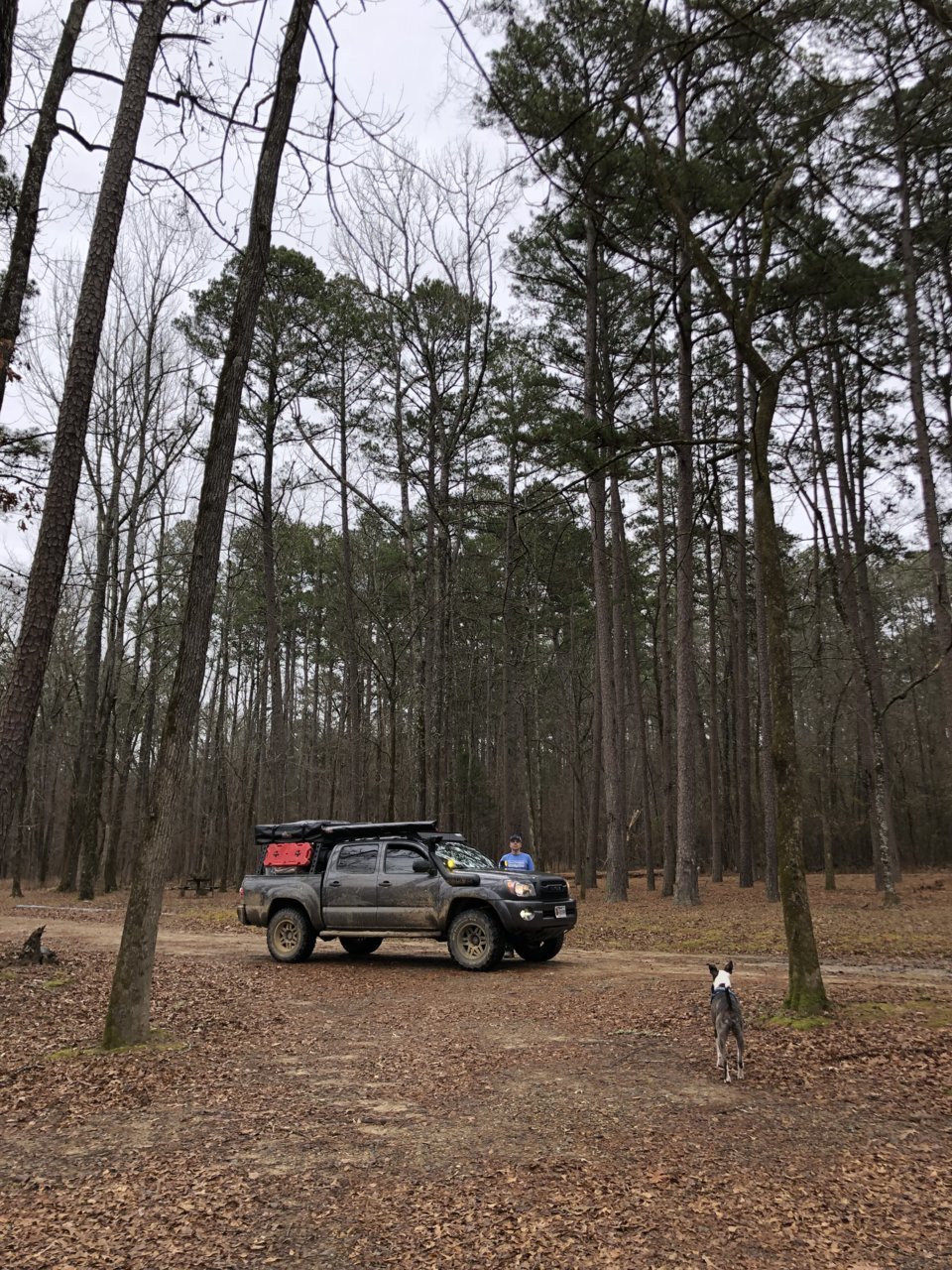

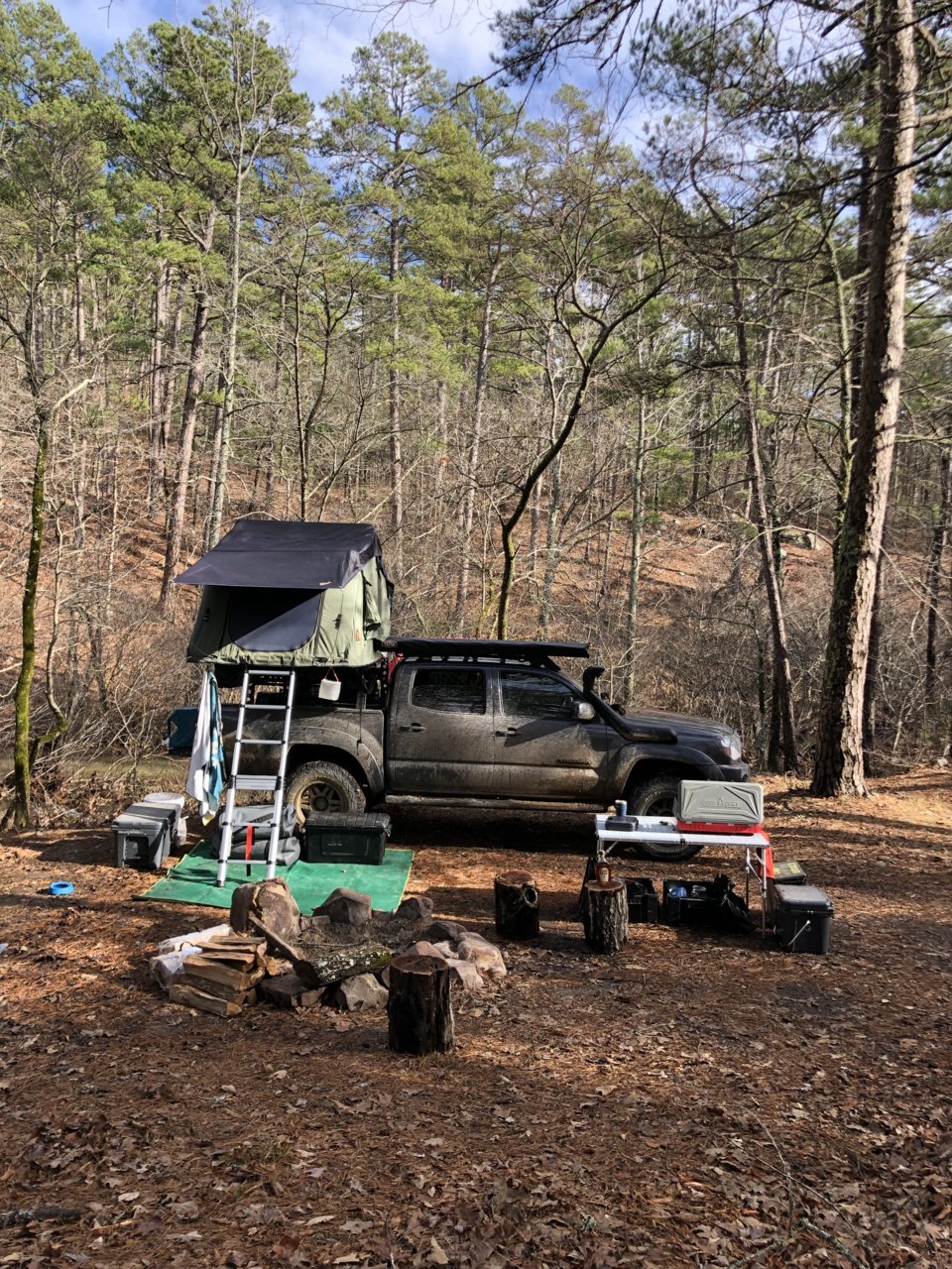

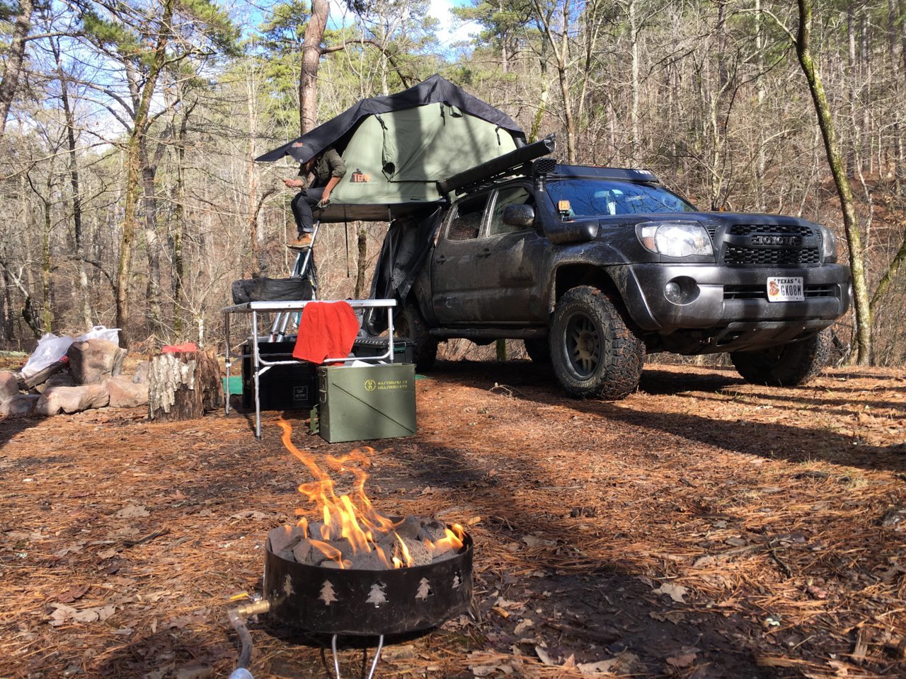

    We had a great trip into the Ozark’s. We explored dozens of forest roads and enjoyed all that the forest offered. We put just over 1,000 miles on the rig. The snorkel paid for itself as we crossed several streams a few feet deep in some spots I wouldn’t have attempted without it.
    MPG’s with all the gear really suffered (about 9.5 - 10 mpg). A hard north wind certainly didn’t help. However, my wife and I discussed the entire way home different ways to save on weight on the next trip. Some of our camping gear is heavy and some of our storage containers (covered ammo cans) really add up in weight the more we talked about it.

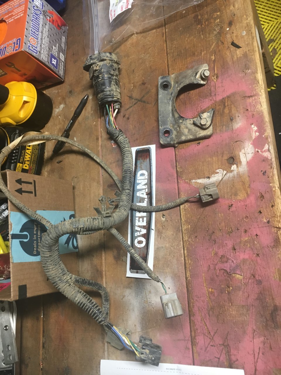

    Overall the rig did its job well. We did suffer some minor damage. I drug the rear bumper going down a steep incline where at the bottom the factory 7 pin towing harness got nearly ripped off. It pulled the wires out of the connector itself. This had a lot to do with the angle I took the truck at and the weight I was carrying in the rear. I’ve already ordered a replacement since I tow a boat and our OverLand trailer.
    Part number for the factory harness is: 82169-04010

  15. Jan 10, 2019 at 11:31 AM
    #135
    WebberLander
    WebberLander [OP] Well-Known Member
    Apr 1, 2014
    #126706
    1,877
    Mark
    Colorado
    2011 SR5 4x4
    Overlanding Rig

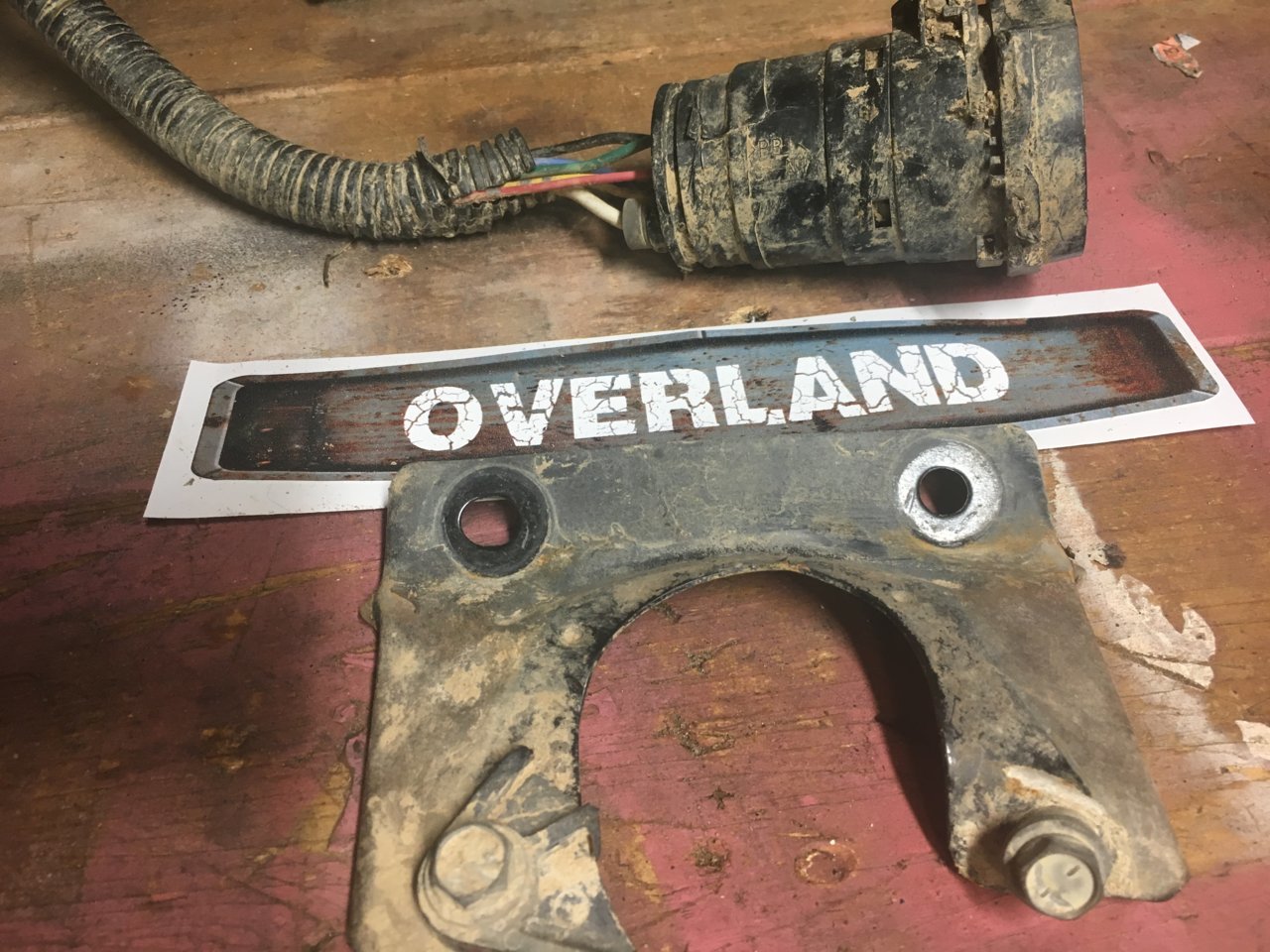

    Got my trailer harness replaced last night. Took about 20 - 25 minutes. Pics of the old one. You’ll see how the faceplate that the 7-pin connector is mounted to pretty much got ripped off. Also the wires got stretched out, but it still works. If anybody wants the old one, just PM me or reply here.
    5942DD39-75BE-463A-B9BC-6B37FAF77BF5.jpg B43A9CC1-57F6-4359-B229-41ECA84EE14C.jpg

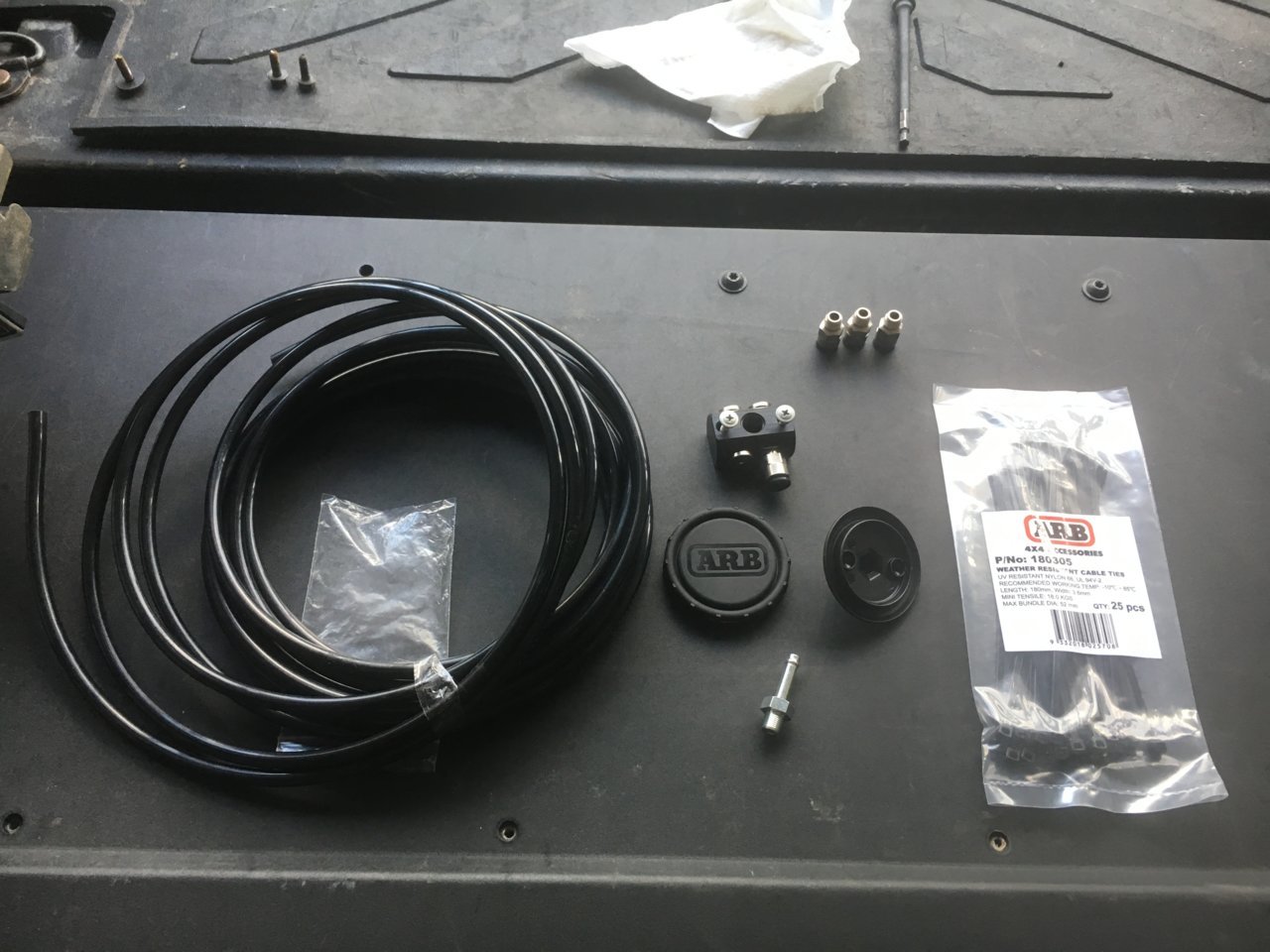

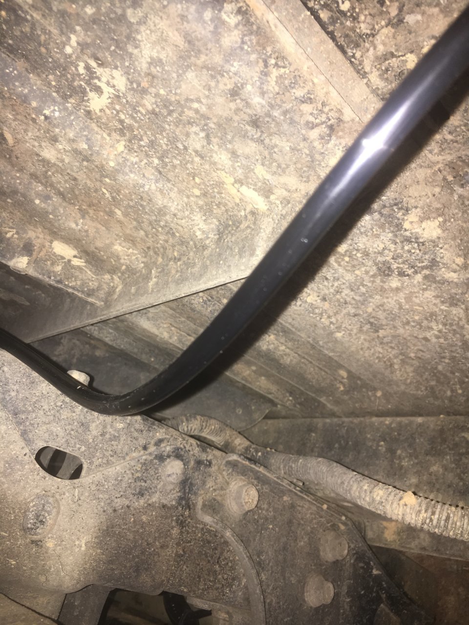

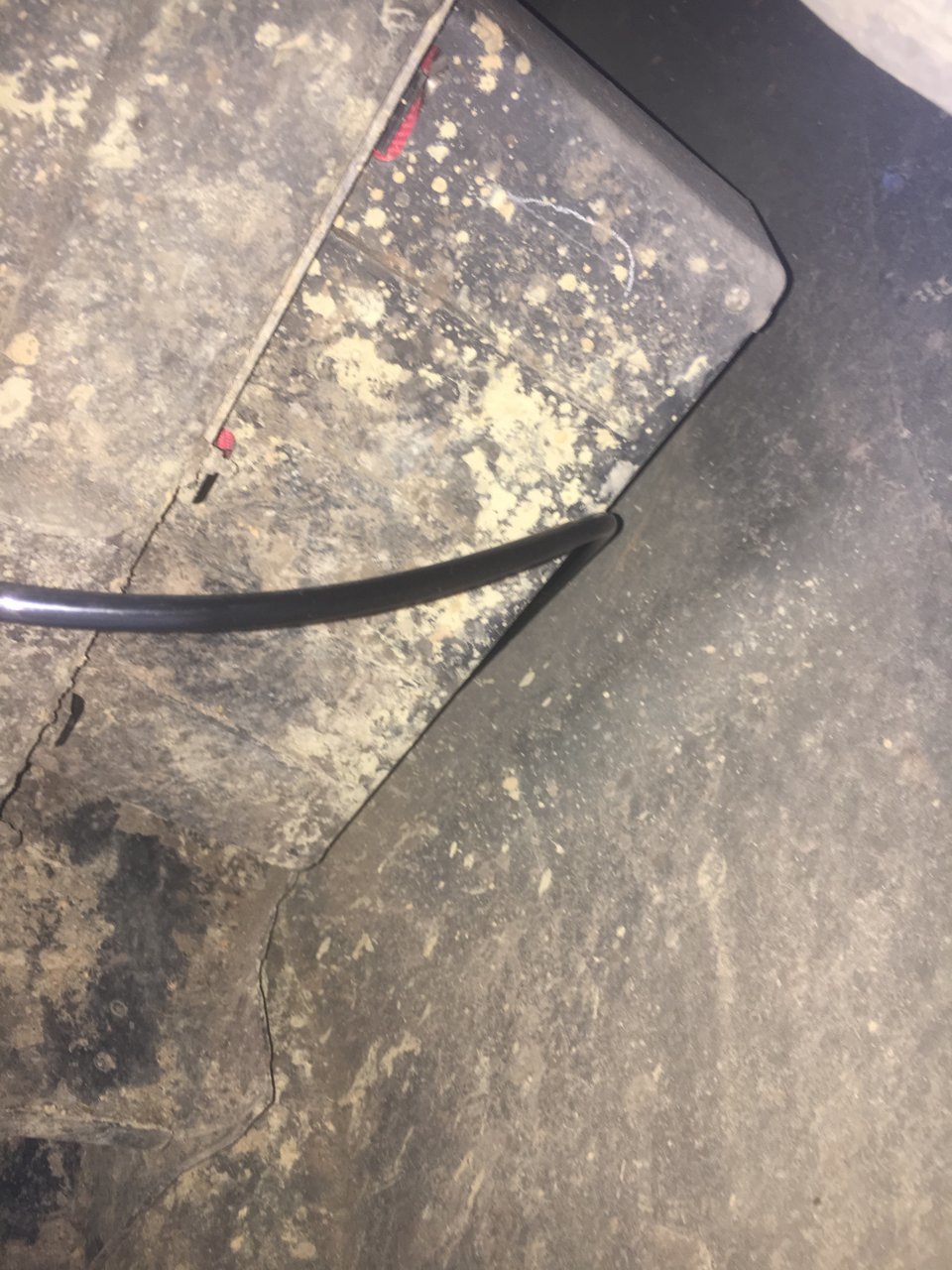

  17. Feb 11, 2019 at 5:15 PM
    #137
    WebberLander
    Apr 1, 2014
    #126706
    1,877
    Mark
    Colorado
    2011 SR5 4x4
    Overlanding Rig

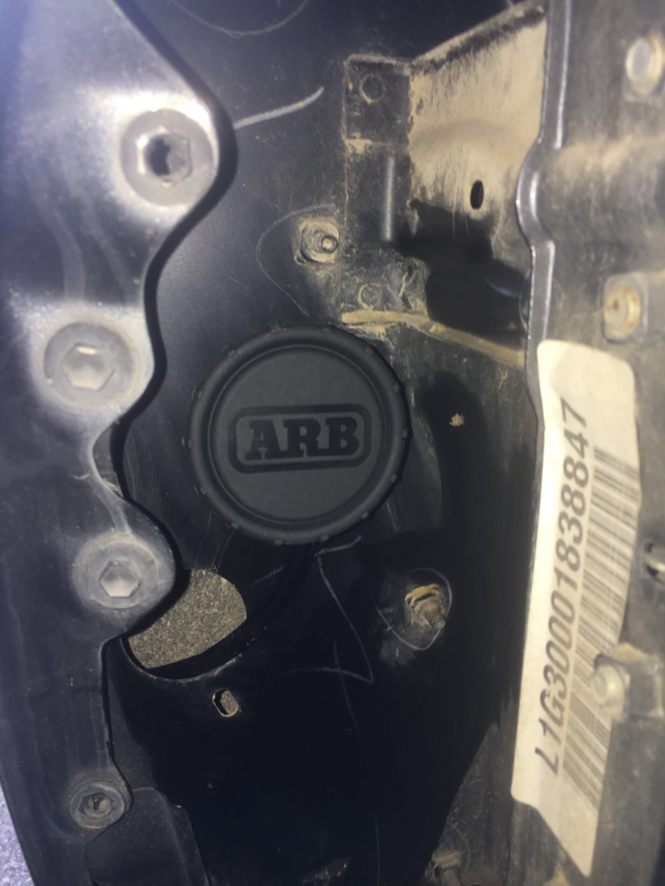

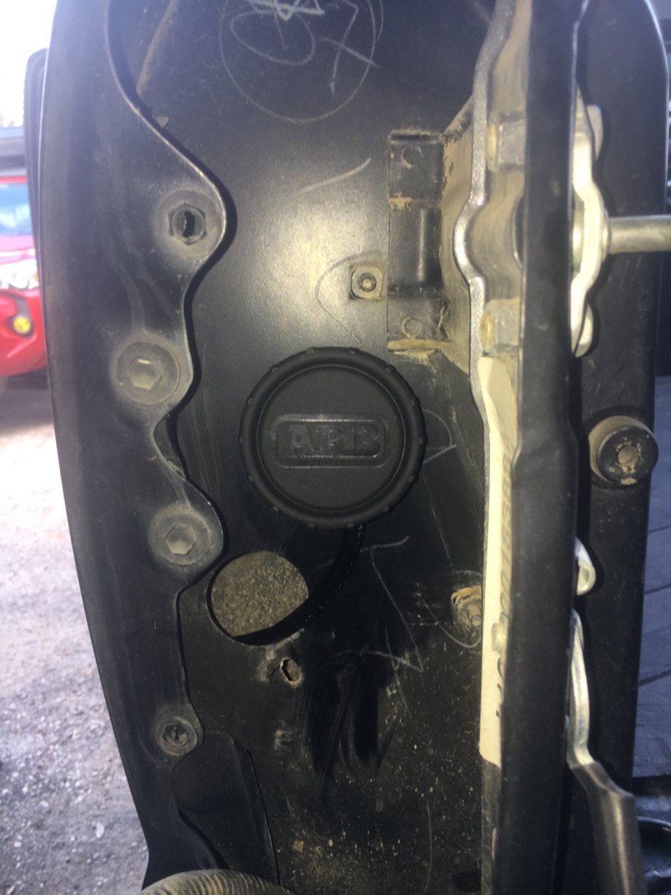

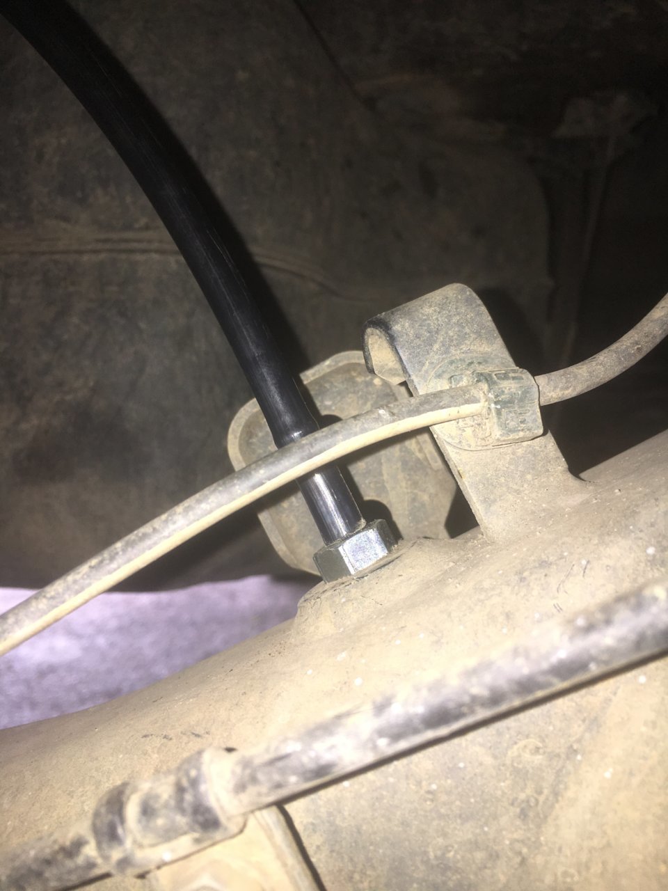

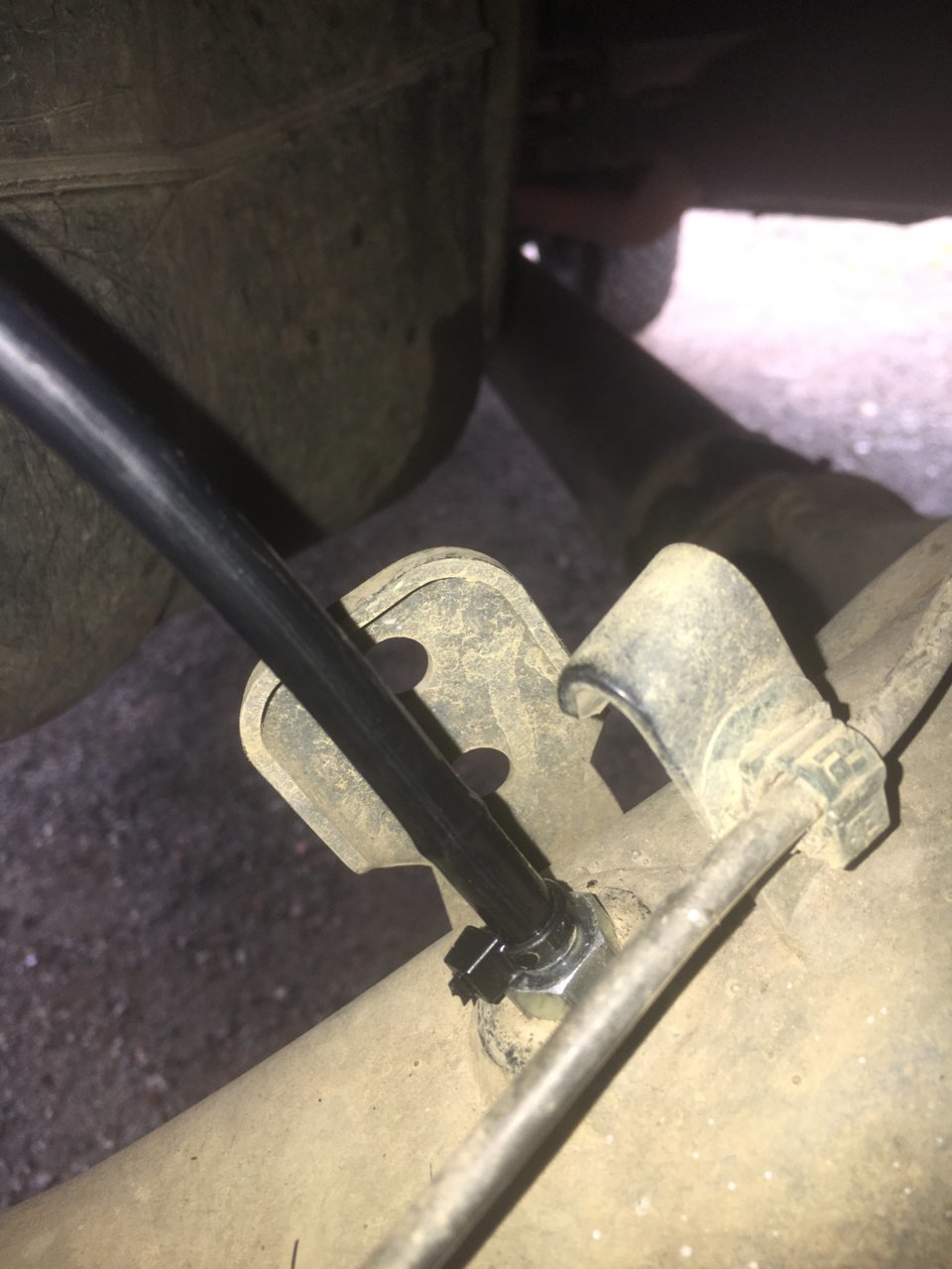

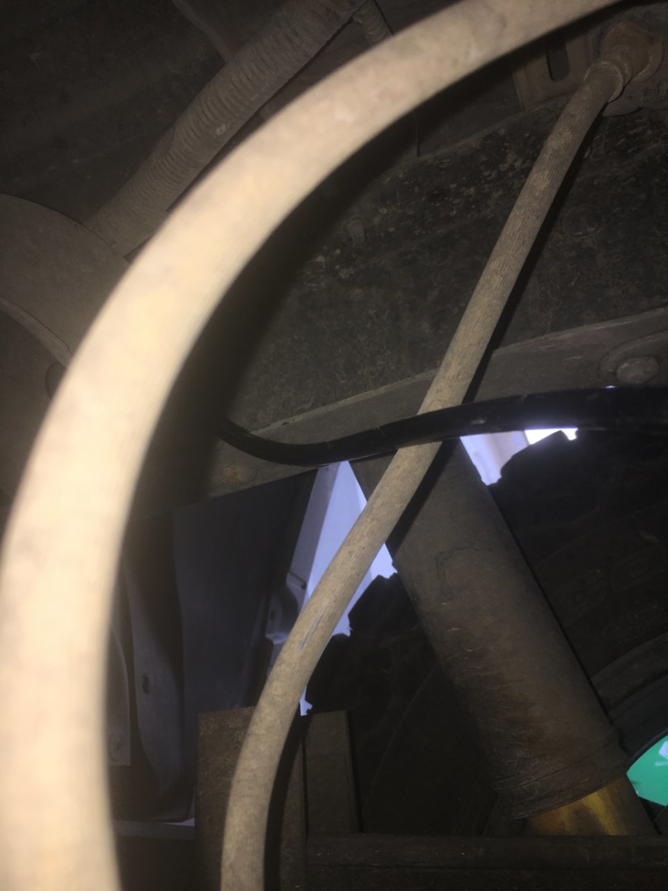

    Just now getting around to posting photos of my ARB Diff breather installation. I mounted the filter/breather behind my tail light and routed the line down the diff. I purchased the union off Amazon. Overall took less than 30 minutes start to finish. Really easy install and good insurance to keep the diff fluid free of water.
    IMG_3264.jpg IMG_3265.jpg IMG_3267.jpg IMG_3269.jpg IMG_3274.jpg IMG_3273.jpg IMG_3272.jpg IMG_3277.jpg
