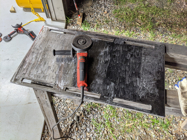

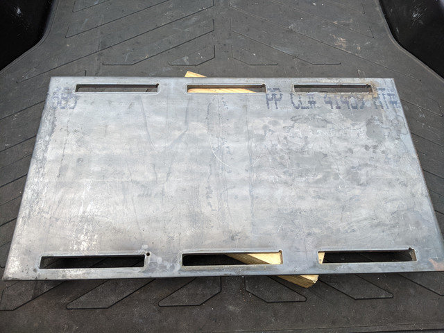

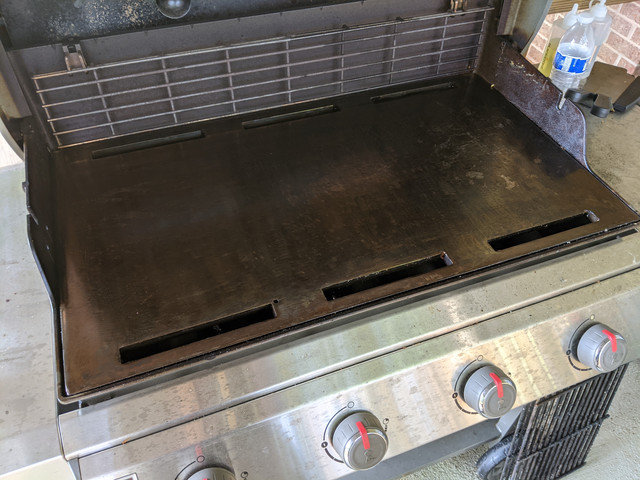

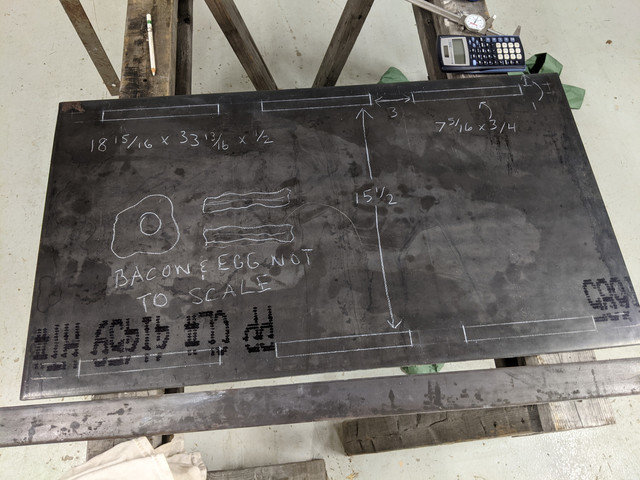

    I've been using one of the small Weber griddles that replaces a section of grate on my Genesis 400 series but always ran out of room way too quickly. The solution to cure this (and my Blackstone envy) was some 1/2" plate:
