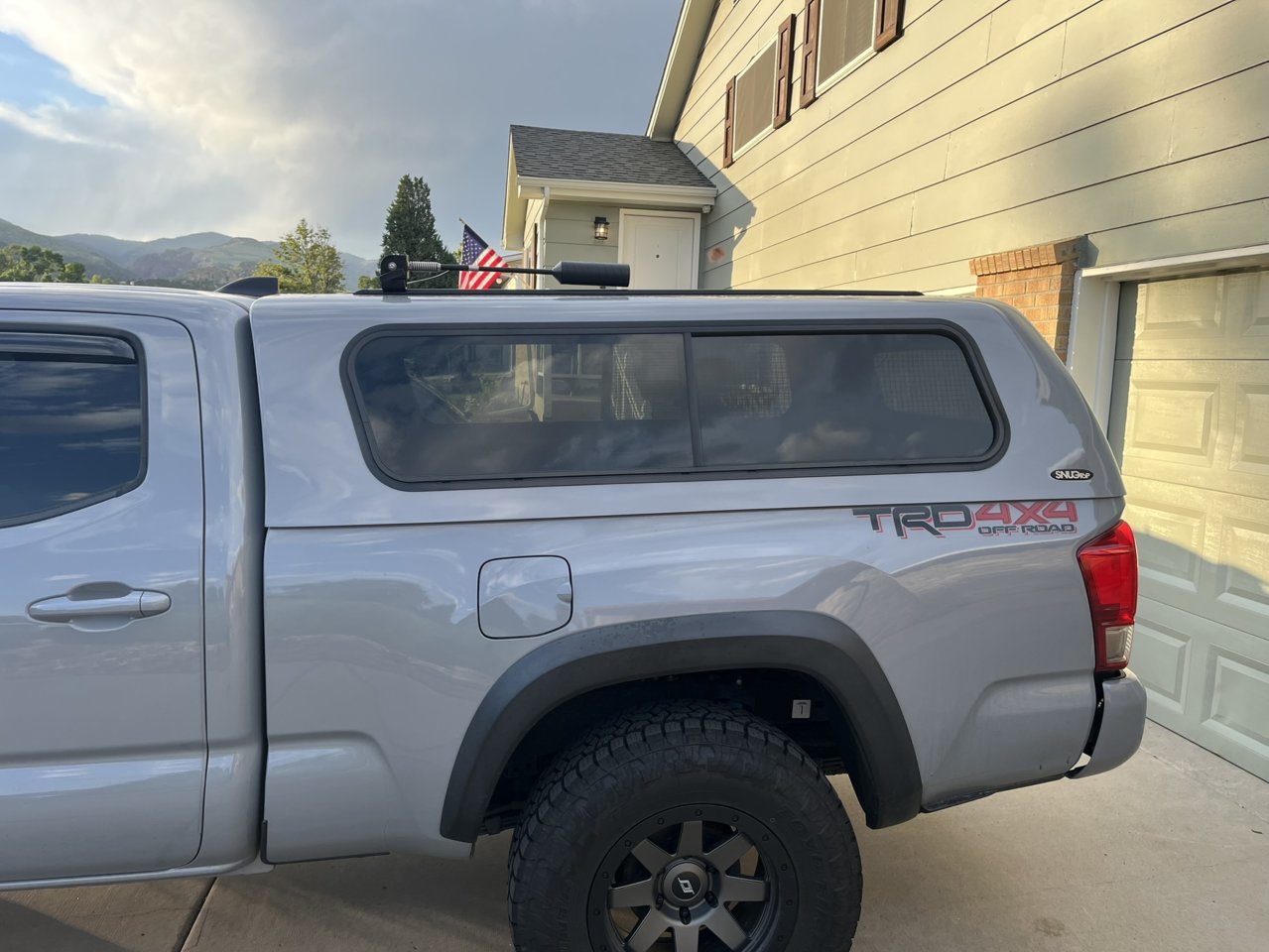

    I have the very lightly used Rhino Racks mount and have been thinking of trying the Weboost overland mount as it’s smaller and cosmetically speaking, for my mounting style, I think it’d look a smidge sleeker. My mount is the only thing on my topper, so it’s 100% front and center on display and the Rhino Racks one is nice, well built and functions very solid…but bulky looking.
    If you decide to part with it and wanna trade, PM me and we can talk.
    To contribute to the thread, mine is mounted to my topper rails (no roof rack, just the factory rails on a topper). Ran the wire between the bed and cab, under the cab and through a grommet under the passenger seat to inside. Inside antenna is on the passenger side B pillar, but going to move it to the middle console soon. Maybe 4-5 linear feet of separation between the antennas. Only been running the setup for a few weeks, works great for me.

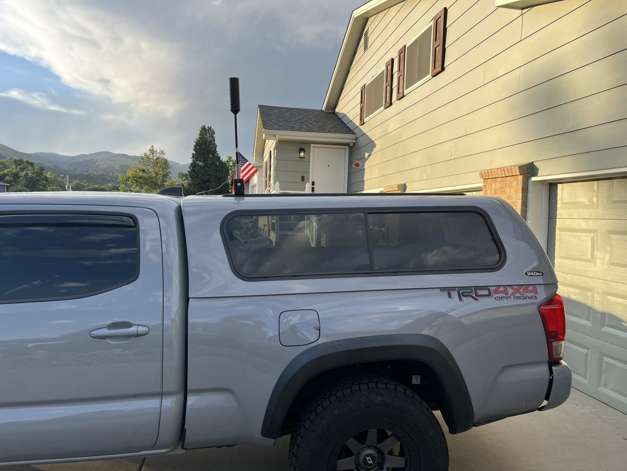

    Here’s mine. Topper rail mounted. Antenna is ran between the cab and bed, down the frame rail and up under the drivers seat through a grommet. Inside antenna is above the map lights, ran down the headliner/A pillar. Base is under the drivers seat with power snaked up through the underside of the center console to the cig lighter.

    Is that the "inside"antenna mounted on top? If so, is it weather protected? The instructions direct to mount inside, so I was curious how durable the antenna is and how well yours works.

    thats an outside antenna it comes with some kits that dont have the big flip up antenna. this is the 200 dollar kit so it doesnt have an inside antenna. It did its job and boosted reception when i was in the georgia mountains from no connection to a connection that was working.

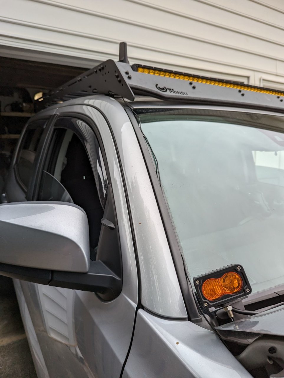

    Thanks for the Tnutz link! Picked up some random hardware to fab a bracket for vertical mounting on my Prinsu. Pretty stout :)

    Side note: hid the massive internal Reach RV antenna under the dash,... Looking to test Wilson's "Omni-Directional" antenna performance claims and will adjust accordingly, should placement present interference. So far, good boost with no oscillation :)

    Did you weld a back plate onto the weboot mount? looks very clean

    2019 MBM TRD PRO
    Thanks! Happy how it turned out.
    I removed the original plate from the Overland mount and replaced it with a modified corner bracket from T-Nutz (e.g. below). Pretty straightforward work. Simply drilled/countersunk the bolt holes then painted it black and it worked like a charm. You can see the disassembled Overland and modified bracket sitting on top of the Weboost box in the picture below.
    Bracket:
    https://www.tnutz.com/product/cbs-010-f/
