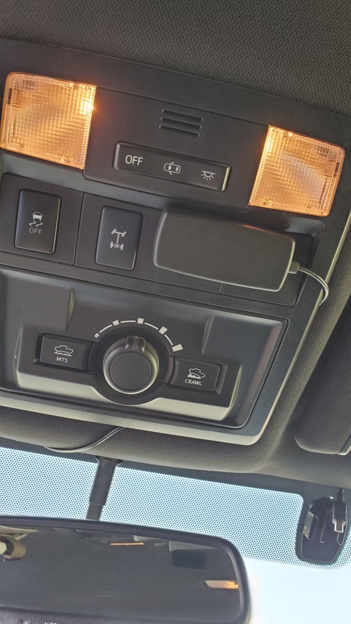

    I mounted the amp unit to the side of the transmission tunnel. Basically just to the right of my leg when my foot is on the gas pedal. doesnt touch and its a nice place because you can tuck wires for a clean install. Mounted the bracket with screws, and then the amp snaps in it. I ran the interior antenna up the A pillar and came out with it in the overhead console...which gets good reception. I tried a second antenna spot which is just behind the ram phone mount I have on the vent...again, the closer that internal antenna is to your phone- the better. touching it is even fine. After realizing my phone is in that cradle 99% of the time, thats the spot I am sticking with and I will pull the old location.

    Mine just goes under the seat. Cables are just long enough.
    I put the inside antenna right next to the crawl control know overhead.

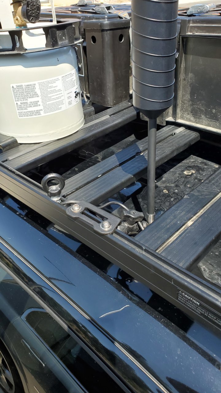

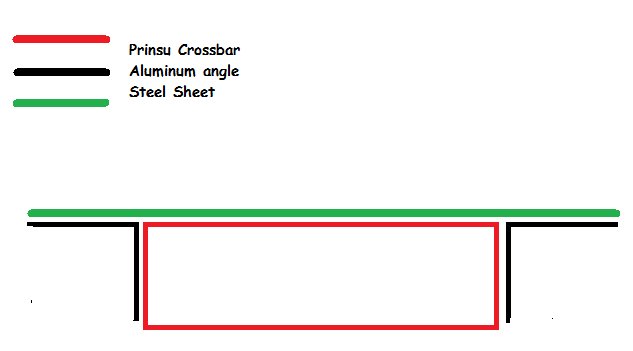

    I have a few flat mount DIY'd to fit a couple antennas. Use angle aluminum and some flat sheet metal. All held together with 1/4" hardware since that's the Prinsu standard.

    Really looking into the WeBoost option as well for offroad Utah use where signal is slim. But I'm running out of antenna room that doesnt cause interference!

    you could
    Consider the OTR antenna at full
    Height mounted to a rear tailgate mount like Rago and others make. It clears the roofline by about a foot that way

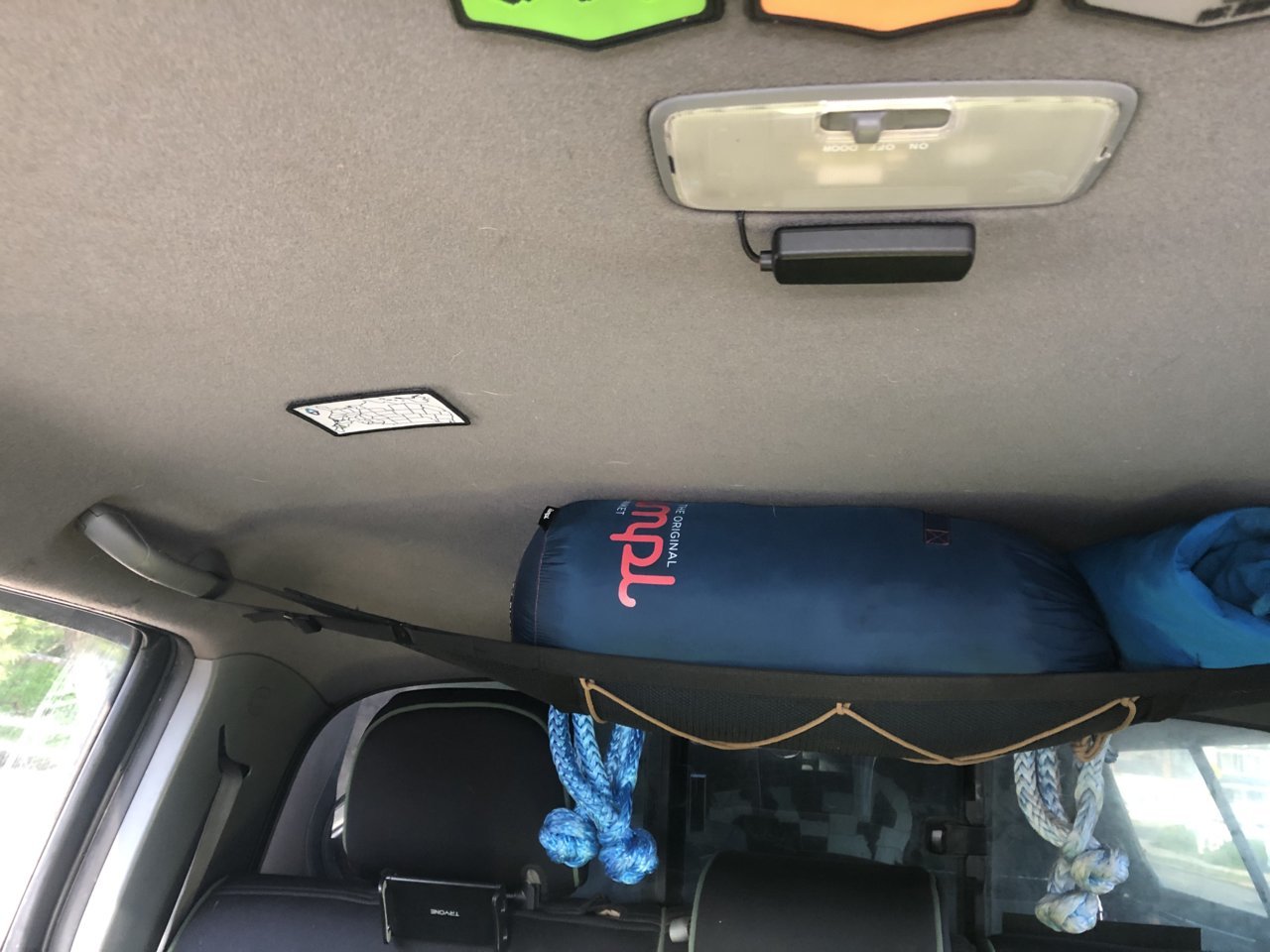

    Inside antenna next to done light, wire ran above headliner

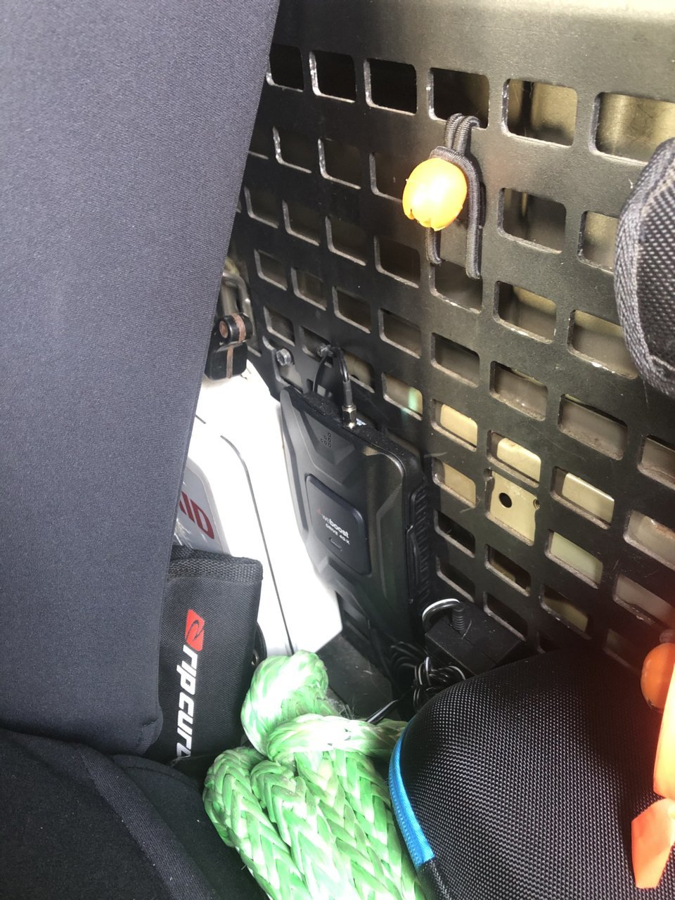

    Receiver behind rear seats
    I was just short on the antenna length running from the rear driver tail light, ordered the extension to final fit. Also, noticed on the first trip out with the weboost not even turned on having bad cb reception with other trucks on the trip. Doesn’t make sense but I temp removed the antenna and the convoy said they can hear me clear.. Will be looking to remount the antenna on the rack over the cab.

    Thanks Chux, the antenna attached to the headliner via velcro? some sort of adhesive?
