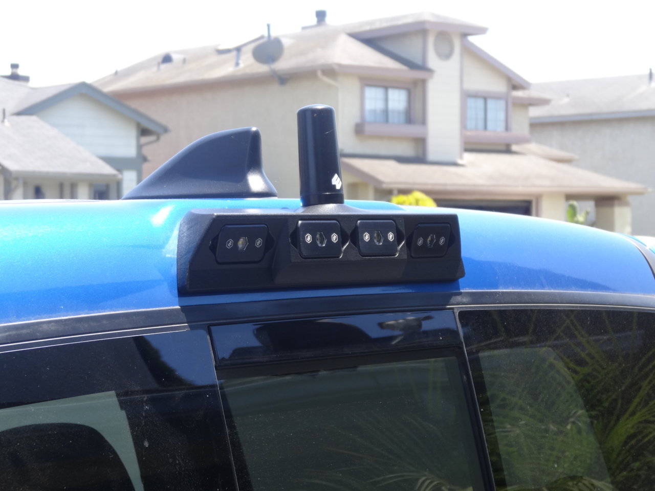

    I bought MESO's Super Ultimate 3rd Brake Light "BD4-NMO" and use it with a weBoost Drive Reach Fleet.
    The antenna wire runs through the headliner and the booster is under the driver's seat. I run the power through an add-a-fuse tapped to the wiper blades so it only has power when the truck's on.
