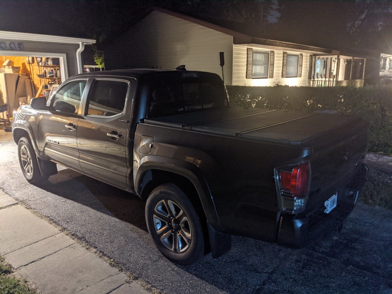

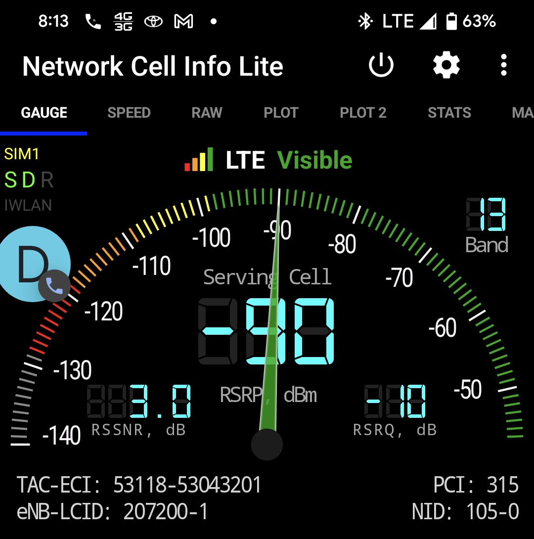

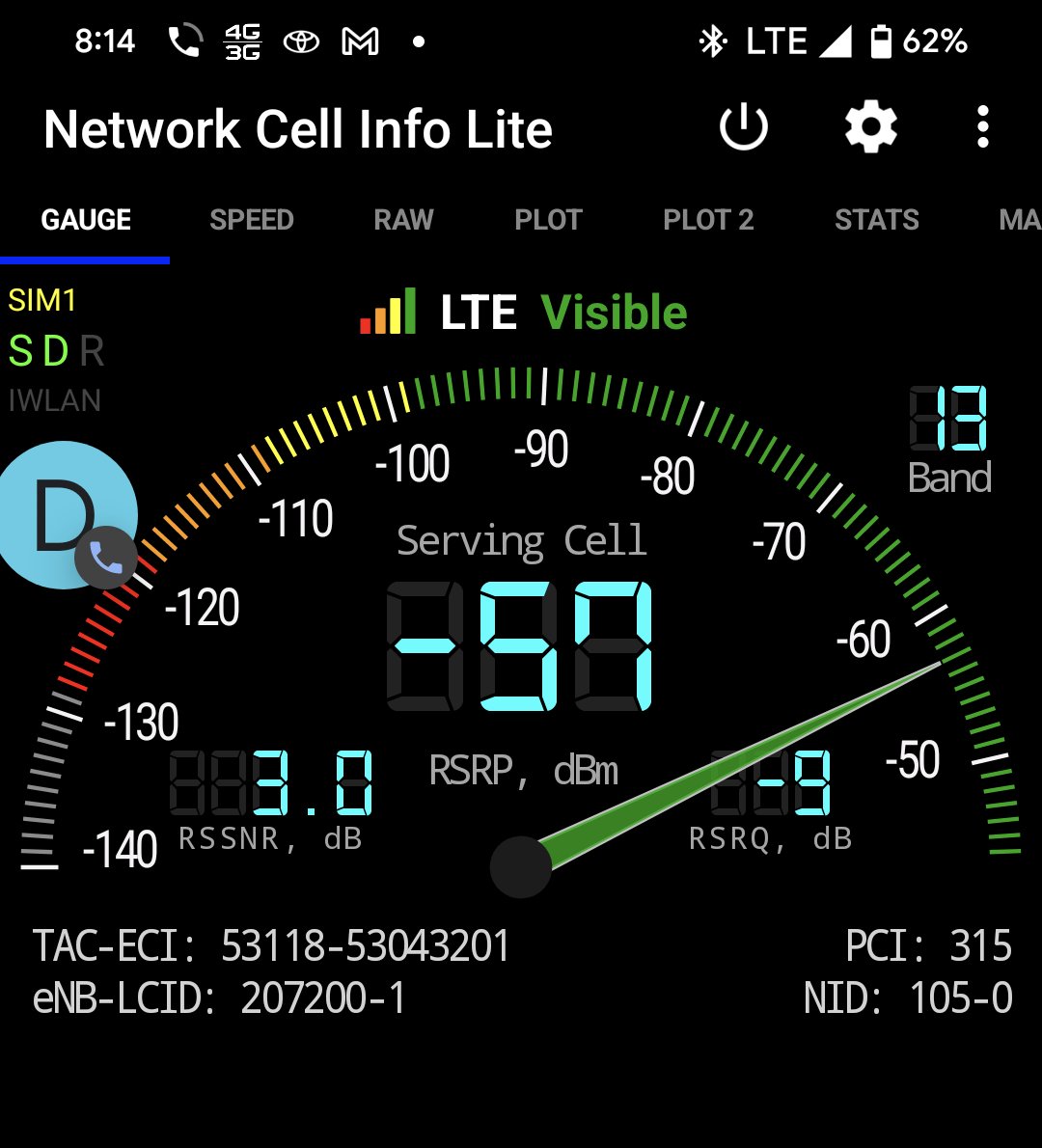

    Took the plunge and ordered the Weboost Drive Reach OTR. I did a temporary setup and stopped a place on a my daily commute that is usually a dead spot and the signal increased quite a bit, so I'm ready to do the permanent install. Here's where I would like to ask for some ideas, because the mounting options for the external antenna seem to be limited. Here are my issues/constraints:
    #1: I don't have a roof rack, so I can't mount it there like many others do.
    #2: I have a tri-fold factory Toyota tonneau cover, so bed rail access is limited unless I can find something that will route between the bed and tonneau.
    #3: I am taking my time on mods as this is my daily driver, so having it mounted at the hood/ditch light area seems quite out of place to me, but might be an option.
    #4: Mounting it all the way at the back of the bed at the tail light just seems so out of place without any further mods done.
    #5: I would really prefer not to drill into the truck for this as I'm trying limit the cutting and drilling to things I have no other choice for such as a bumper or roof rack or larger wheels in the future. Putting a hole in things now for this would be a waste if I end up doing a roof rack in the future.

  8. Sep 27, 2021 at 4:38 PM

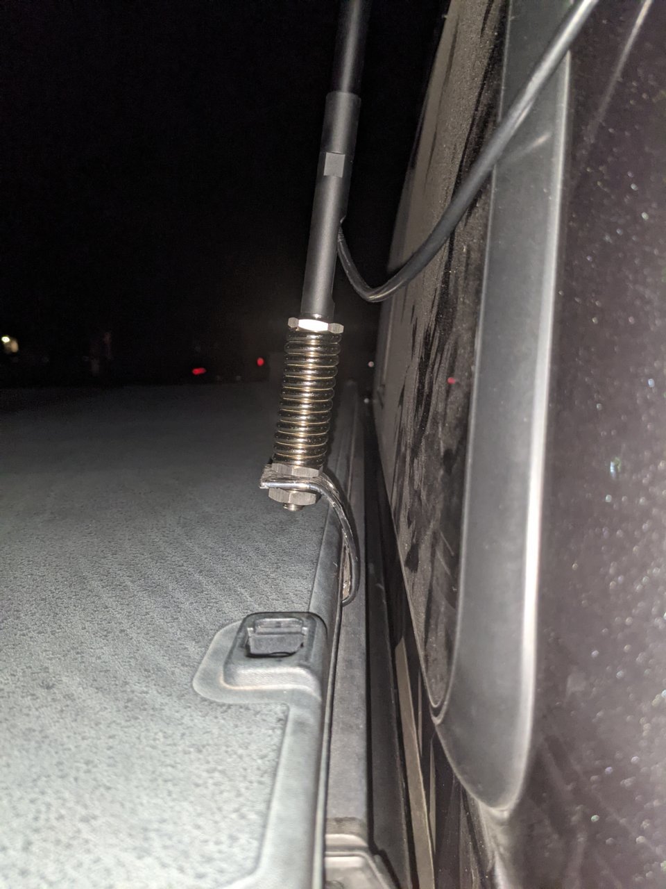

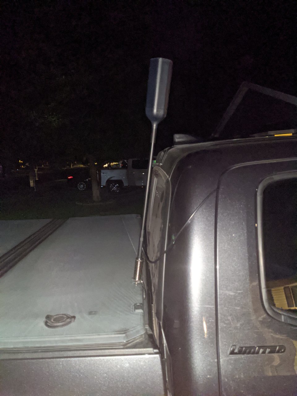

    I stop by the local store and bought a metal L bracket which I proceeded to beat 4 more bends into. This obviously isn't a finished product, but it worked as a test to get the idea down. Just bends around the bed rail and then has a bolt that tightens down on the inside.
    I'd like it to be stowable as well, but this will give me a chance to see how it looks as well as works. 33dB gain sitting in the driveway, so I have high hopes.

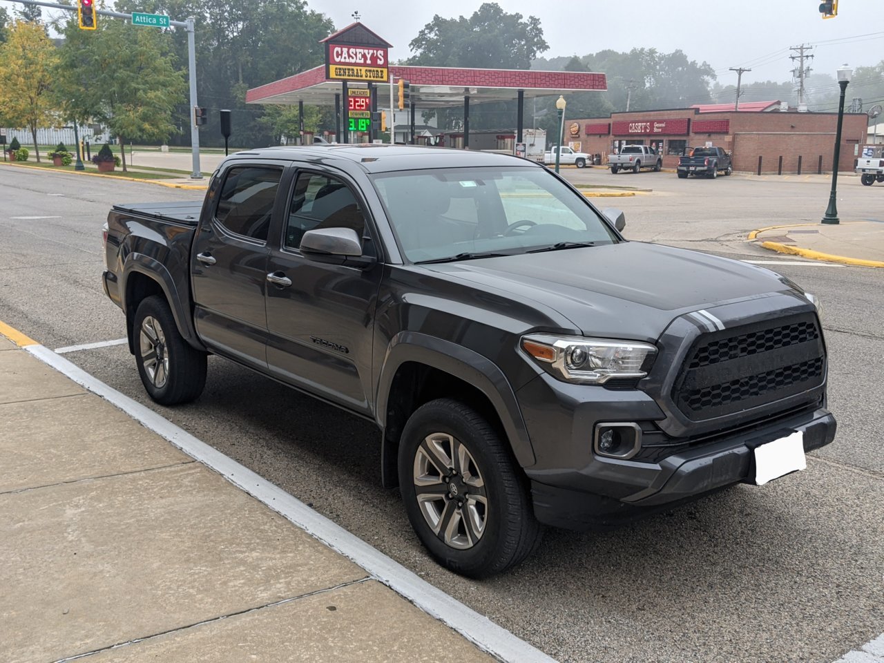

    Looks a bit better in the day light. Maybe I'll get used to it.
