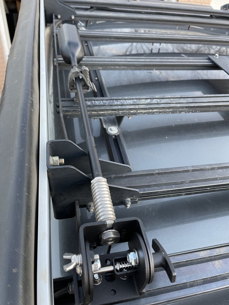

    I don't have it mounted currently, but I was going to run it through a grommet under the cab right to that location. Given the orientation of yours, I would recommend this:

    I have mine mounted this exact same way and it rattles like a mofo. Only having half the bracket on the prinsu bar doesnt make it very stable.

    The bracket itself doesn’t rattle at all as long as the included screw is used, not just the pin. The two 1/4-20 carriage bolts are plenty of holding power.
    I will need to remove the quick fist from the antenna shaft and add one to the antenna “can” though, as it does rattle a little.

    Have you drove with it in the up right position?

    I’ve seen videos of the antenna self-destructing—especially during the fold-down process. Sounded like it was pretty quick and aggressive with the wear and tear.

    probably because the springy part is only intended for 1 segment and many use the full length and that force is directed on to the tip which is a hollowed out C for the cable. its strongest in 1 direction only and weakest on 2 sides.
    Also seems like the pole is a metal tube sleeved in some other material
