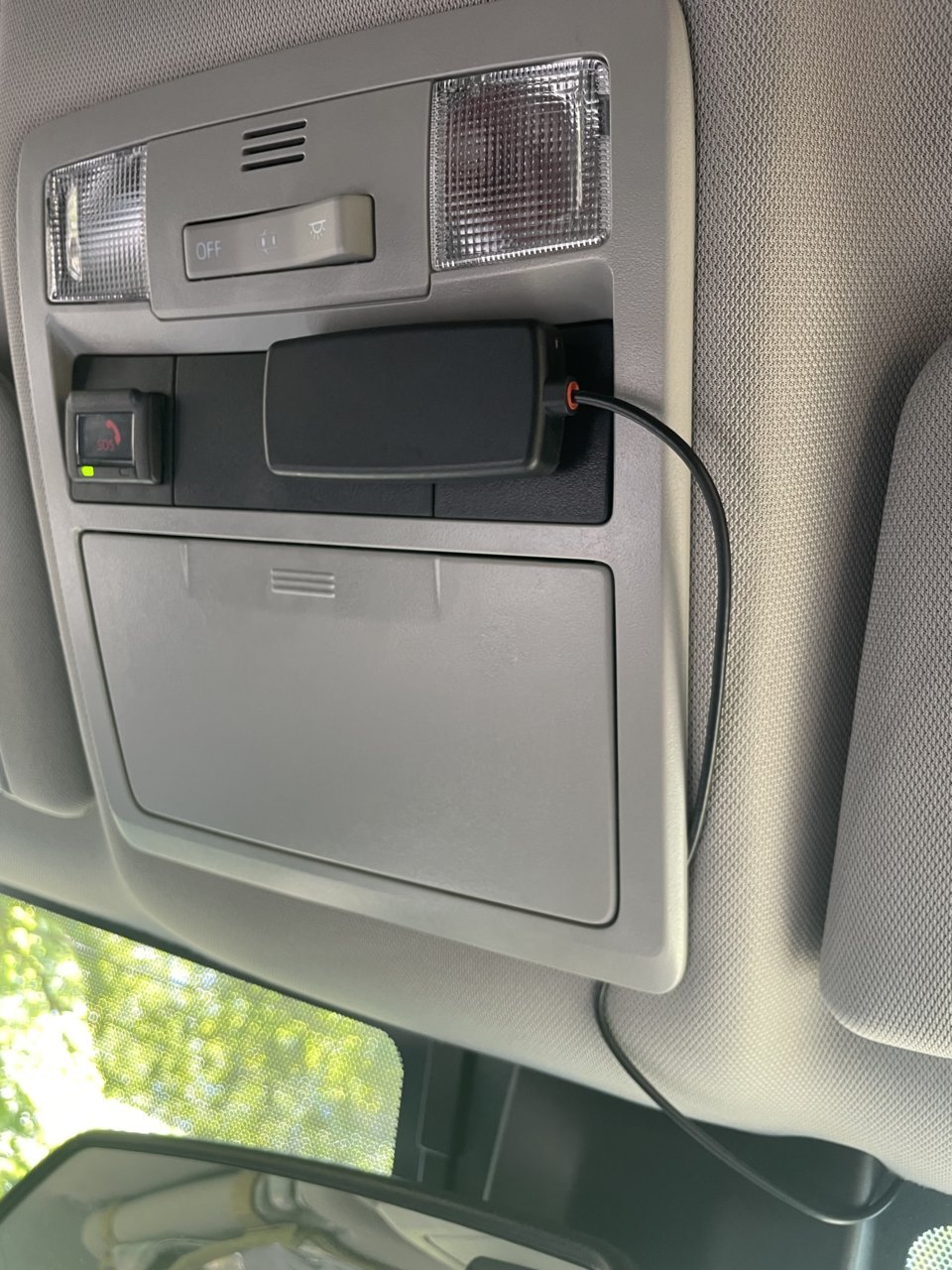

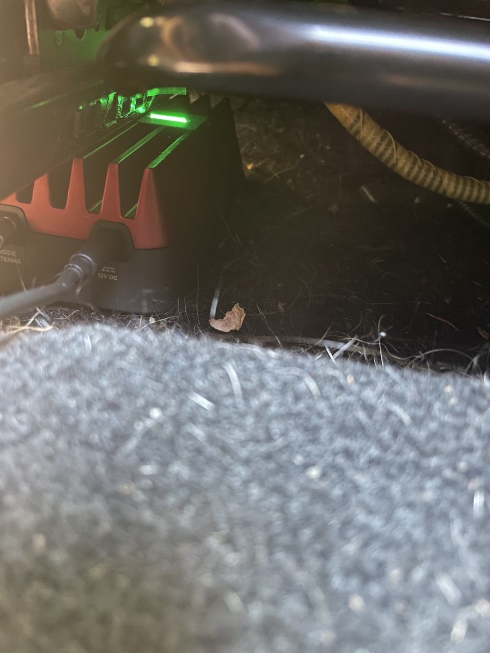

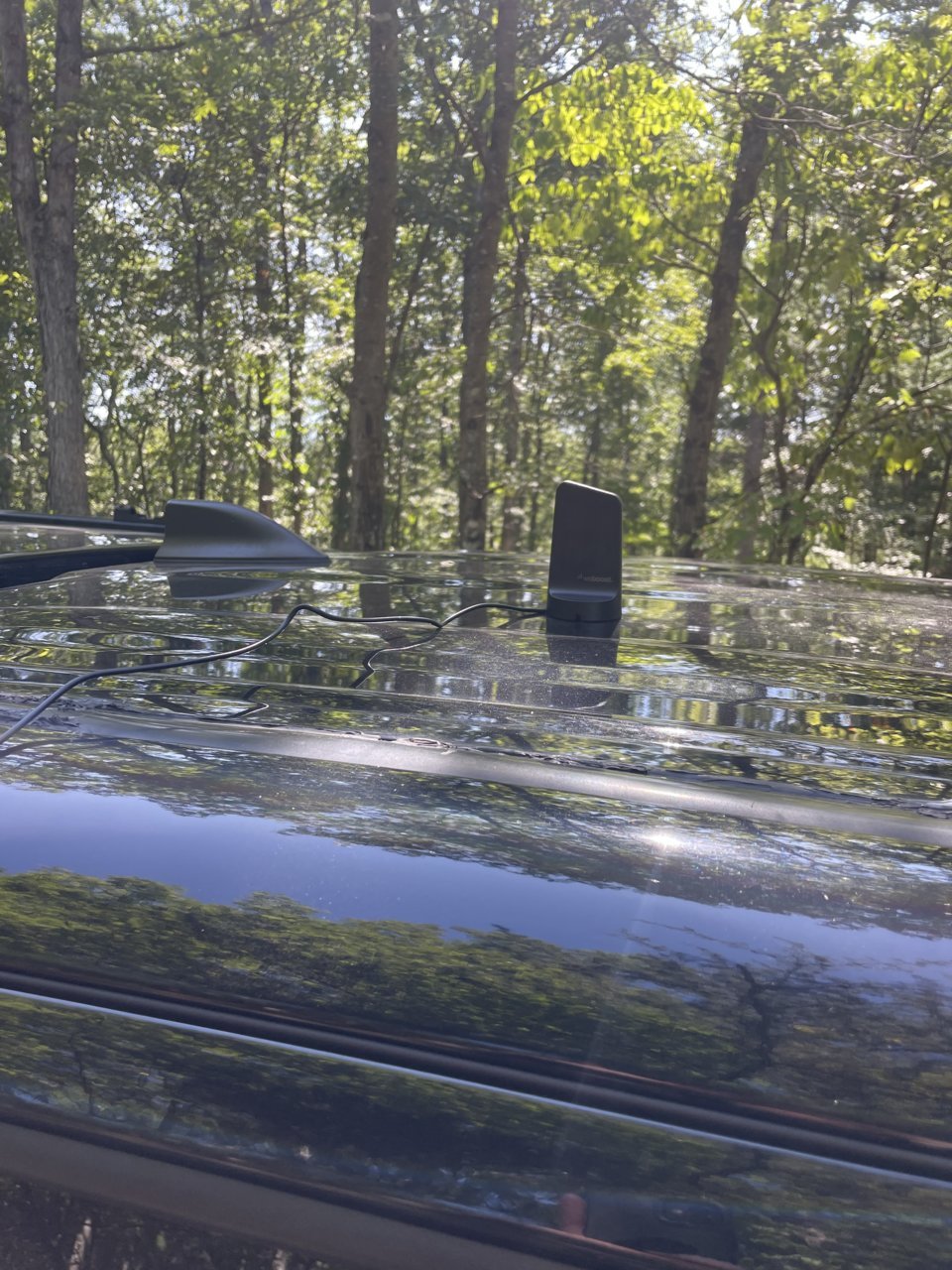

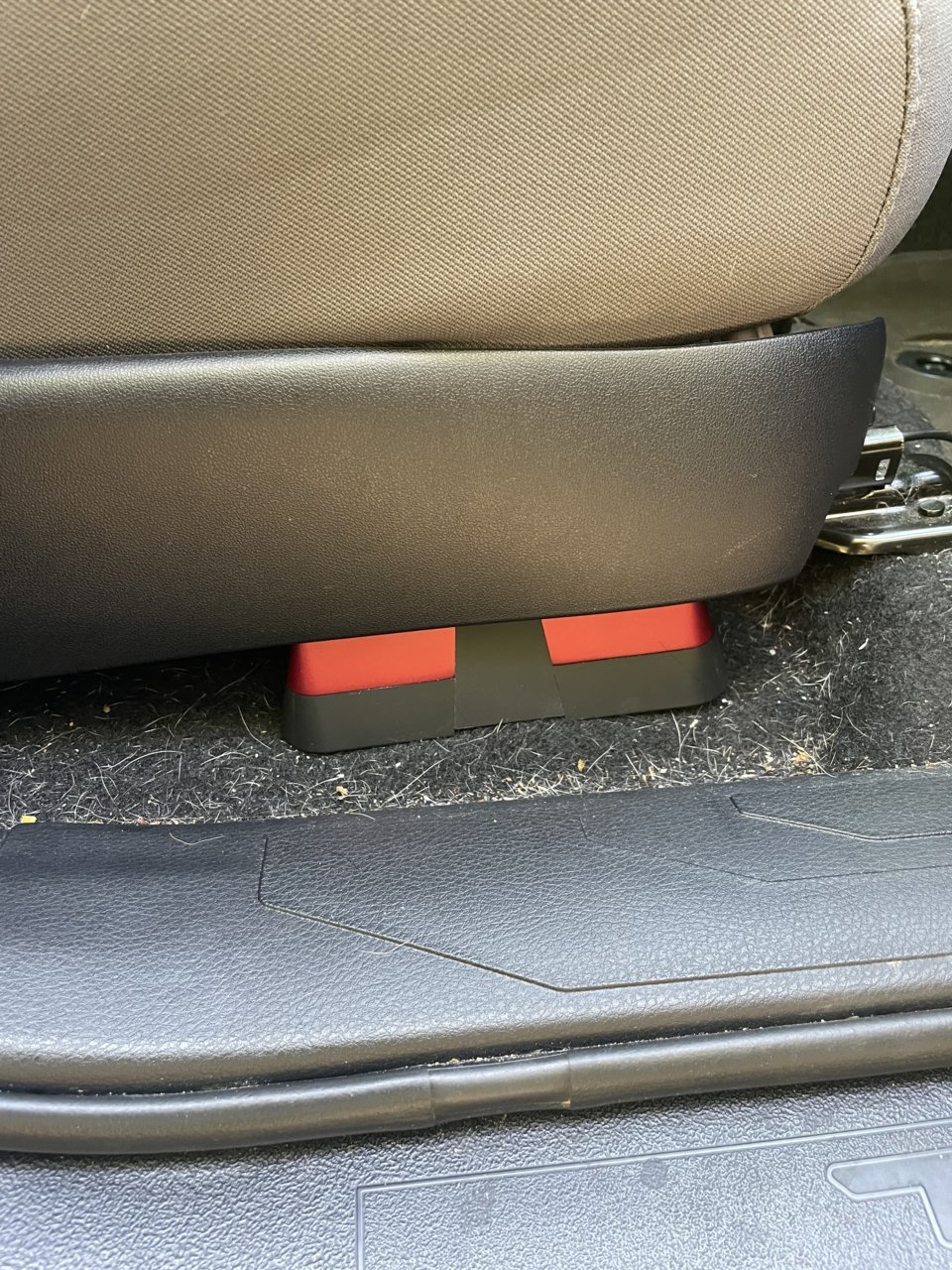

    I installed the WeBoost Drive Reach earlier this week on my truck. It works great and I’m really happy with the purchase.
    Pardon all the dog hair in the carpet, I spend alot of time on the road with the pups.
    I purchased the version with the magnetic antenna, not the overland version. The external wire is routed into the rear passenger door and behind the rear seats, then under the floor mat. The box is mounted under the front passenger seat, I removed the side panel to install it in front of the rear-facing vents.
    The internal antenna is mounted next to the sunglasses holder on the roof. The cord is routed from under the passenger seat, under the floor mat, up the A pillar liner and behind the headrest.
