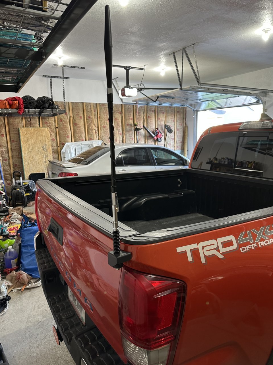

    Finally found a company that was able to help.
    here is the correct solution for future reference.
    Marketty SS-3H CB Antenna Spring, Stainless Steel Heavy Duty CB Radio Antenna Mount Spring, Spring to Fit Mobile/in-Vehicle CB Radio Antenna Mount Up to 60" Long and 3/8" X 24 Thread (Black) https://www.amazon.com/dp/B07MTCNL84
    https://boltontechnical.com/products/the-bolton-technical-blade-5g-otr-cellular-vehicle-antenna/
    Then use whatever mount you want. The whip and the antenna allows the antenna to catch on branch and bend but not break.
    Below is the setup with the magnet mount antenna which isn't durable enough to hold up to trail use.
