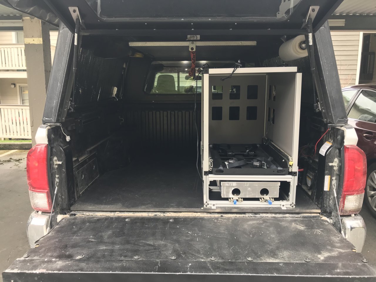

    What are people planning on doing as far as building out the bed?
    My plan was to use my fridge/stove slide on one side and a tall/skinny set of two drawers mounted flush against the side in front of the wheel well. One drawer would hold kitchen stuff, and the other would hold misc/camp items.
    I was going to take the top off of the fridge slide and put it on a hinge (so I can access contents from inside the camper), and make the drawers work as a char so I can use the stove as a table.
    Anyways - got the stove/fridge slide mounted in today and I'm not sure I have enough room to put a drawer on the other side and be able to get in the bed between the two.
    I'm 6'2 so not sure getting in on top of a short/fat drawer would work.

    I’m doing something similar in mine. Fridge slide in roughly the same spot with water storage behind it. I’ll have a narrow drawer on driver side with storage behind it with a hinge top for access. Leaving as much space open as possible in the middle is the goal for me.
    Don’t really have much for inside pics, but here’s something.....kinda.

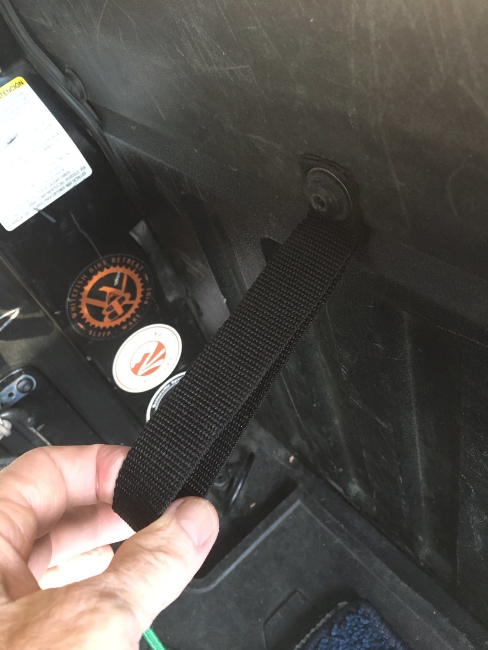

    Anyone have creative ideas for a handle to pull the tailgate up from inside?

    I attached a short length of webbing to one of the tailgate liner screws. Works great.

    @dman100 No issues with that? Nice, simple solution. It’s been a while since I added the metal cap replace the but I think I remember the bolts thread into plastic inserts.
  16. Apr 3, 2018 at 8:53 PM
    #196
    dman100
    dman100 Well-Known Member
    Mar 2, 2016
    #180009
    2,347
    Central Coast, California
    2016 TRD OR DCSB
    I have a short bed and cab-high shell so rarely sleep in back, so I maybe have only 5 or 10 pulls on the strap, but it’s holding up fine.
