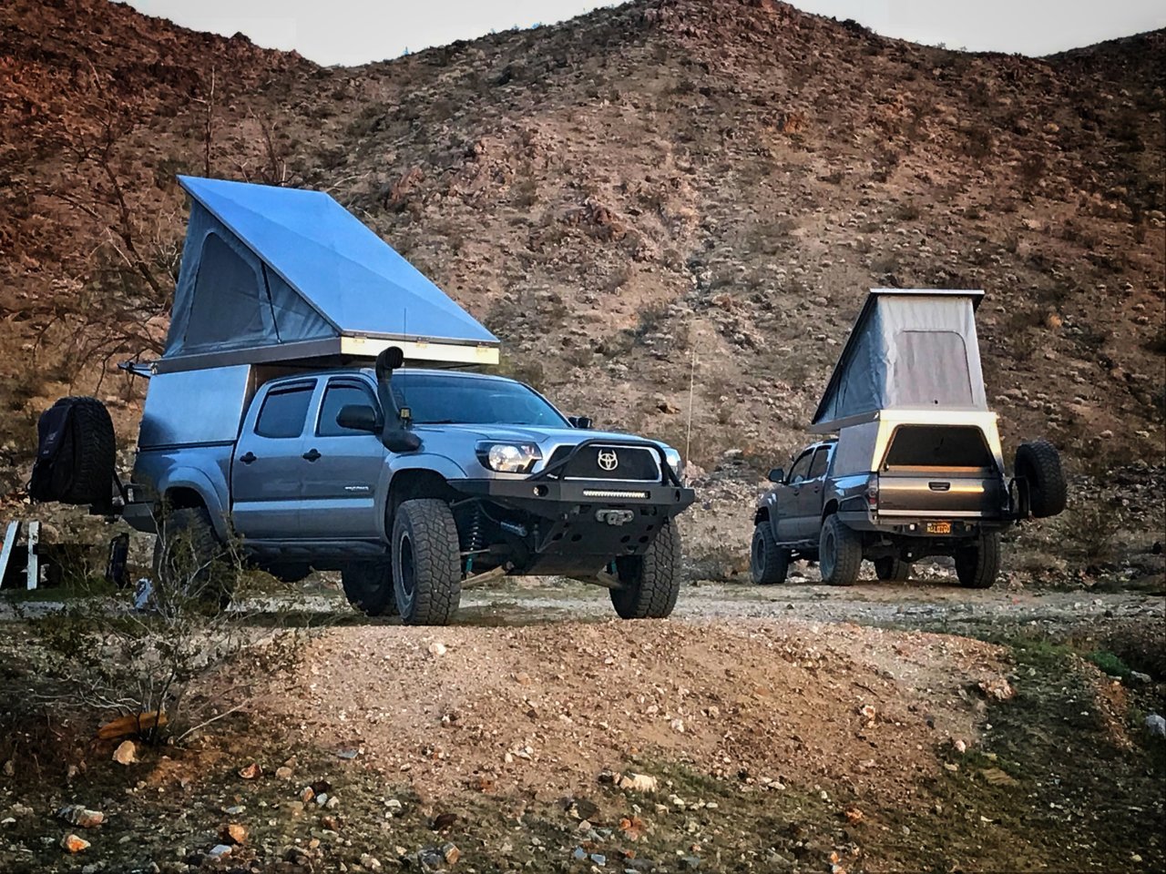

    The quote above is from the drifter forum but wanted to post here to get different options: @dman100 mentioned "Great welds" and I've been wondering about how the aluminum welds will hold up to fatigue and shaking on dirt roads? From what I've heard aluminum is light and strong but terrible with fatigue - especially when the aluminum has been melted and welded.
    I'm from San Diego and for years we've heard about the Callen Campers being the best for Baja due to their steel frame. I was actually looking at getting one (they are making some again these days) but found out they are 5K new and really heavy (700 lbs?) for a tacoma. I was looking at aluminum shells and things but kept hearing how baja eats welded aluminum campers (like FWC), its the washboard stress on those welded joints that will cause the design to tear itself apart. There are some things that I really like about the drifter (like side windows), but I've been worried about the aluminum welds holding up to fatigue and breaking when I'm way down some dirt road in Baja.
    Anyone know where the welded joints are on the drifter? That would help in understanding its ability to hold up to fatigue and to get me home on down the road.

    When buying my truck, I took into considerations where I was going to sleep. The 6' bed was really the only option for me regardless of what tent I went with because that meant I could sleep inside the bed in any weather. A veteran to tent camping and even with backpacking tents, I was basically done w/ the flappiness i'd get atop High Sierra Alpines in the middle of the night, the camper shell was a step in the right direction and sleeping in 18f weather in Yosemite was never a problem.
    With the habitat, if it gets windy, I can close the top and still sleep comfortably inside being 5'8". Now if there were only an Access Cab with a 7' bed or a Regular Cab w/ an 8' bed.

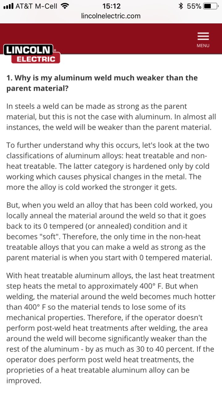

    Clearly a lot of thought has gone into this, thanks for sharing more detail. (just saw @Overlanerd's reply - lots of detail)
    You will surely know this better than I, so correct me if I am wrong, but aluminum is made with different specs from the factory, 5052 H-32, where the 5052 refers to the specific alloy, and the H-32 refers to the tempering. When you weld aluminum you break down the tempering and this makes that welded point weaker. I think you can re-temper aluminum once it has been welded, like they do so aluminum bicycles don't crack but that's pretty specialized stuff (and expensive). Glad to hear about the rivets and adhesive, wondering about galvanic corrosion with the bolts, and wondering if the welds are being re-tempered? thanks

    It seems like you are very knowledgeable when it comes to metallurgy. Are you a certified welding inspector by chance? Because these are the exact points my high-school buddy brought up. He’s a certified welding inspector for a Military contractor with 20 years in the industry and a degree in metallurgy. His assessment was that the forces put on these campers doesn’t come close those that would cause failure by welding.
    To be fair, please compare your assessment to composite panels and extruded aluminum.
    I appreciate the questions and am more than willing to address each issue. My cousin/ college roommate was an ME major and many of my friends are ME’s. I will defer your questions to them and provide solid answers.

    The H32 in 5052 H32 isn’t actually a temper ... it’s a work hardening to quarter hard. This is the grade most commonly used for welded aluminum structures. The Vagabond guys couldn’t have picked a better material spec.

    I’m NOT a welding inspector but i am an engineer. Steel is stronger than aluminum period... aluminum is prone to fatigue cracking it’s just the way it is.
    There’s a reason Planes are riveted rather than welded. Not saying the Drifter is anything but a great design but if you understand metallurgy Steel is always stronger than Aluminum, it’s just the way it is.
    Aluminum WILL fatigue faster than steel....
