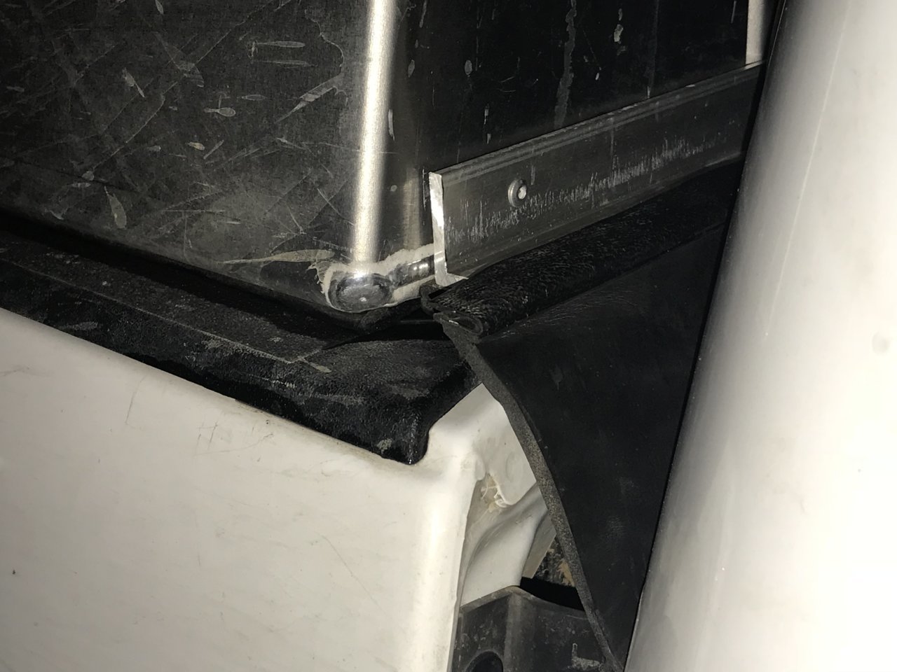

    Here's the weather seal on the Vagabond. Right under that flap is the hole I was talking about earlier

    tbh, bulb seals don't really matter as much as long as whatever design overhangs over the sides of the bed. The biggest issue is leakage from under the bedsides.

    That hole near the cab still needs to be covered unfortunately.

    i mean.. did you miss the part i said about overhang?

    Just making sure we're on the same page, no need to be rude.
    It's going to need to over hang 1-2 inches to cover it. I believe most fiberglass canopies do, while the metal ones don't.

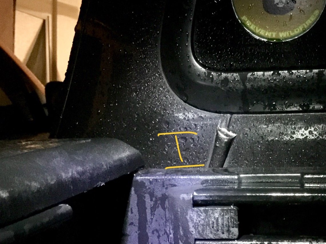

    That 1” gap where the front of the bed meets the bedsides threw me for a loop when I bought my shell too.46B4E11B-9693-4487-871B-310D3BB0CE4C.jpg

    Fwiw the Alu Cab has a bulb seal as well and still leaks. I'm bad at articulating this but the seal around the bed side is not what matters - there needs to be some overhang over the near cab portion (like on many fiberglass caps) or silicon needs to be jammed in the hole to seal it since the gap is below the bed caps. Maybe the GFC has found some way around this that I haven't seen.
    Like I said if I'm wrong I would love to be proven wrong in concrete and explicit ways.

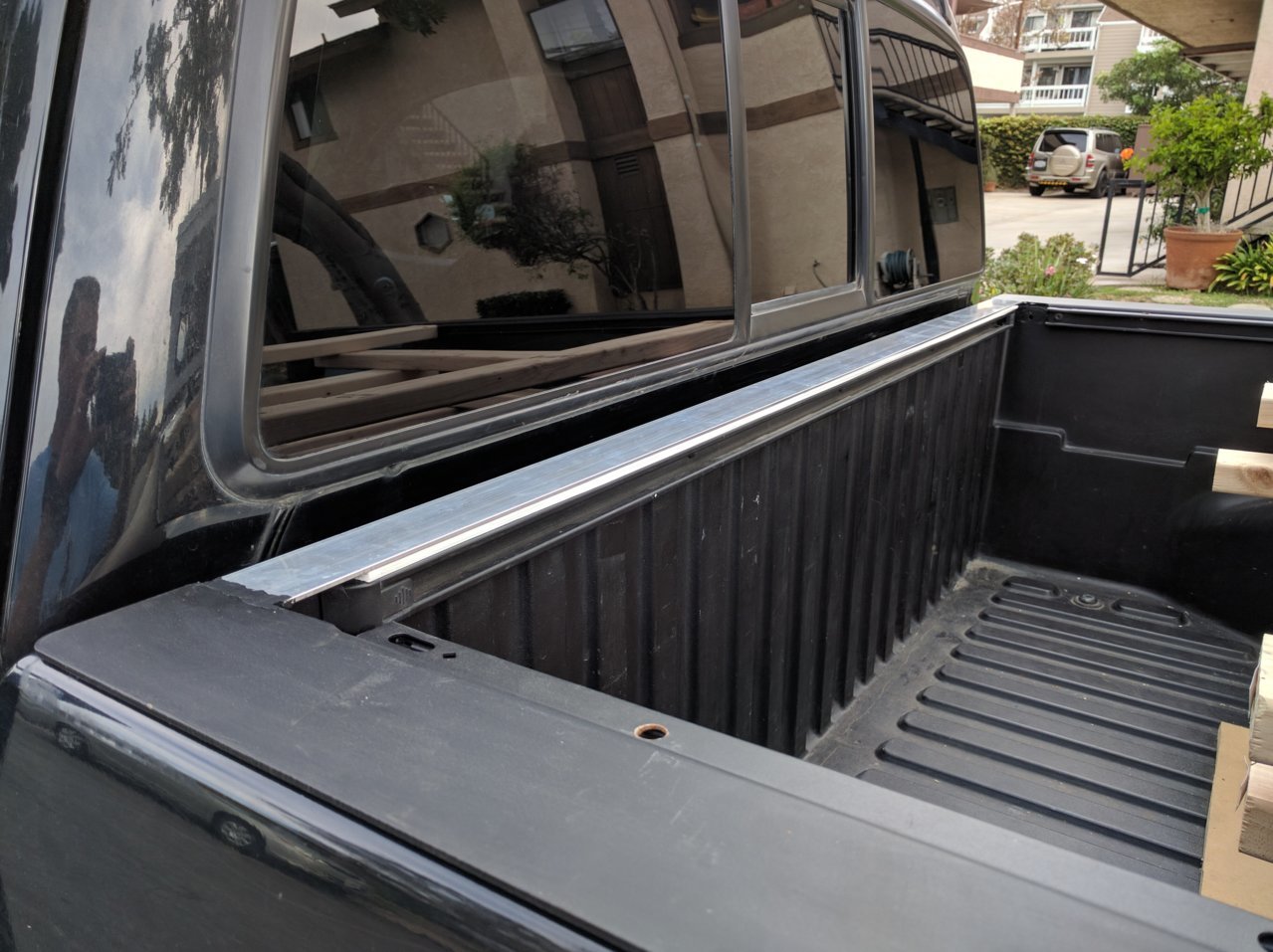

    Take your bed caps off. That difference in height is because the sides have the plastic bed caps and the front does not. You shouldn't be mounting your camper on top of those. If you do, the plastic from the bed caps is going to wear away the paint and expose raw steel of your bed sides, ask me how I know! (bought a truck with a camper shell that was mounted on the bed rail caps) With the bed caps removed, the entire circumference of the bed is completely flat and easily seal-able with a dual bulb seal like @inv3ctiv3 mentioned. Go a step further and get a set of steel bed rails from @KB Voodoo to reinforce the stock bedsides. There are holes in the top of the bed sides, so its a good idea to cover those with a piece of tape or something before mounting the camper on top of that. I mounted my KB Voodoo rails with double sided foam tape so they dont move around and so they seal up the empty holes in the bed sides. With bed rails, there is still a small 1/8" gap at the front. I added an 1/8" thick piece of aluminum and siliconed between the 3 pieces to make it super flat. The bulb seal sits on this and I have yet to see any dust or water get through below my Flippac (2 years). This is the seal you want: https://www.amazon.com/Ultra-Width-Height-Length-Rubber/dp/B00MPMBIZW
