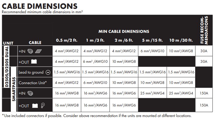

    Most solar controllers only charge @ 20A.
    The CTEK 250S may be fine with your 10awg wire depending on how long your run is per this page from the manual. Not sure where your plan is to keep the battery/controller/fuse panel/etc.

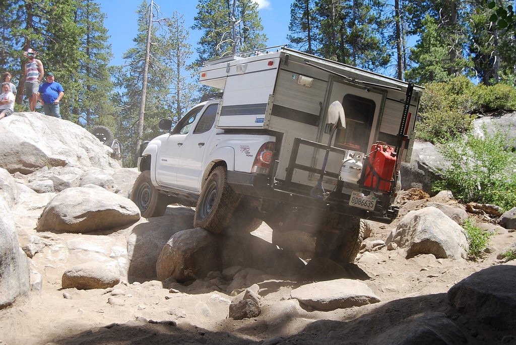

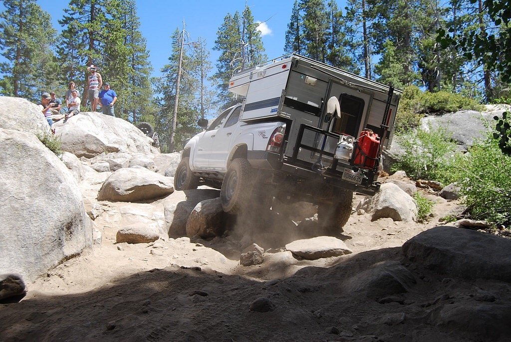

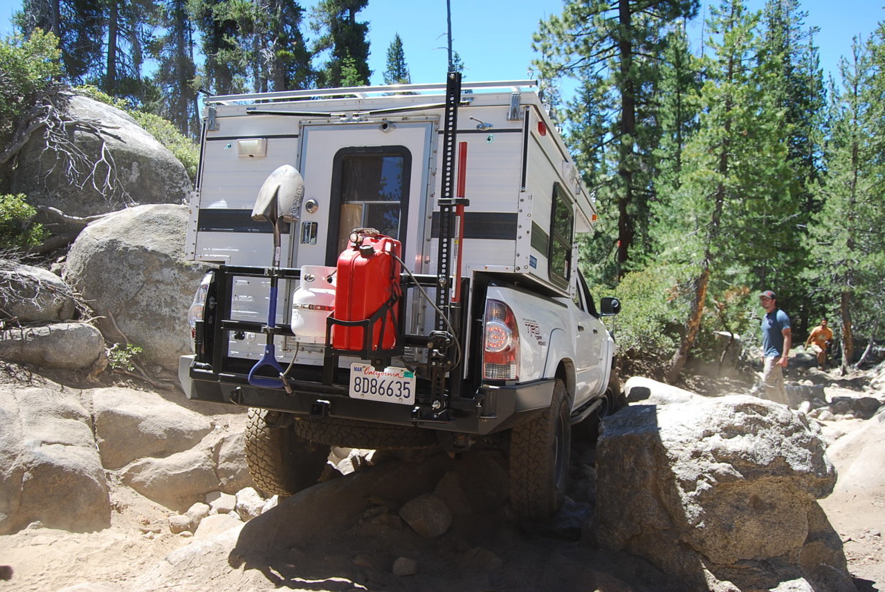

    I obviously have nothing to gain, and more to lose, by stating that heavy slide-ins can be wheeled. But they can with some careful spotting.
    22489255-50FC-4ED9-818F-6FEDC8C9E395.jpg 85E01BB4-CF30-4170-87FF-D7175BAB5AAD.jpg 184ED45A-ED22-44C6-B630-6A04E4F0D436.jpg
    Photos by @552Jrider
    That was on stock 3.73 gearing, 6-speed manual, Dakars, and Cooper ST pizza cutters. Weighing in at 6,650 lbs.
    Now on 35’s, Alcan custom springs, and 4.88’s, it would be much easier.
    But I have more interior space with the Drifter, no lost storage between the camper and the bed, and way more headroom. And obviously more useable power. I will always have a soft spot for slide- ins, but the extra weight definitely taxes the Tacoma.
    The side clearance is the main issue, which is why our sides are not vertical. Any off-camber line around trees is nerve racking. The thin aluminum skin was no match. And with my old Flippac, wheeling around trees and low branches with fiberglass was scary. Especially with that $35k GZL pricetag.
    Ours took a full flop and was lived in for 1.5 months after. I’ve slept in the same camper (Zero) for 6 nights in the past month and @tyfoon11 just spent 2 nights in it. Without me unfortunately :pout:
    The Drifter can take a hit.
