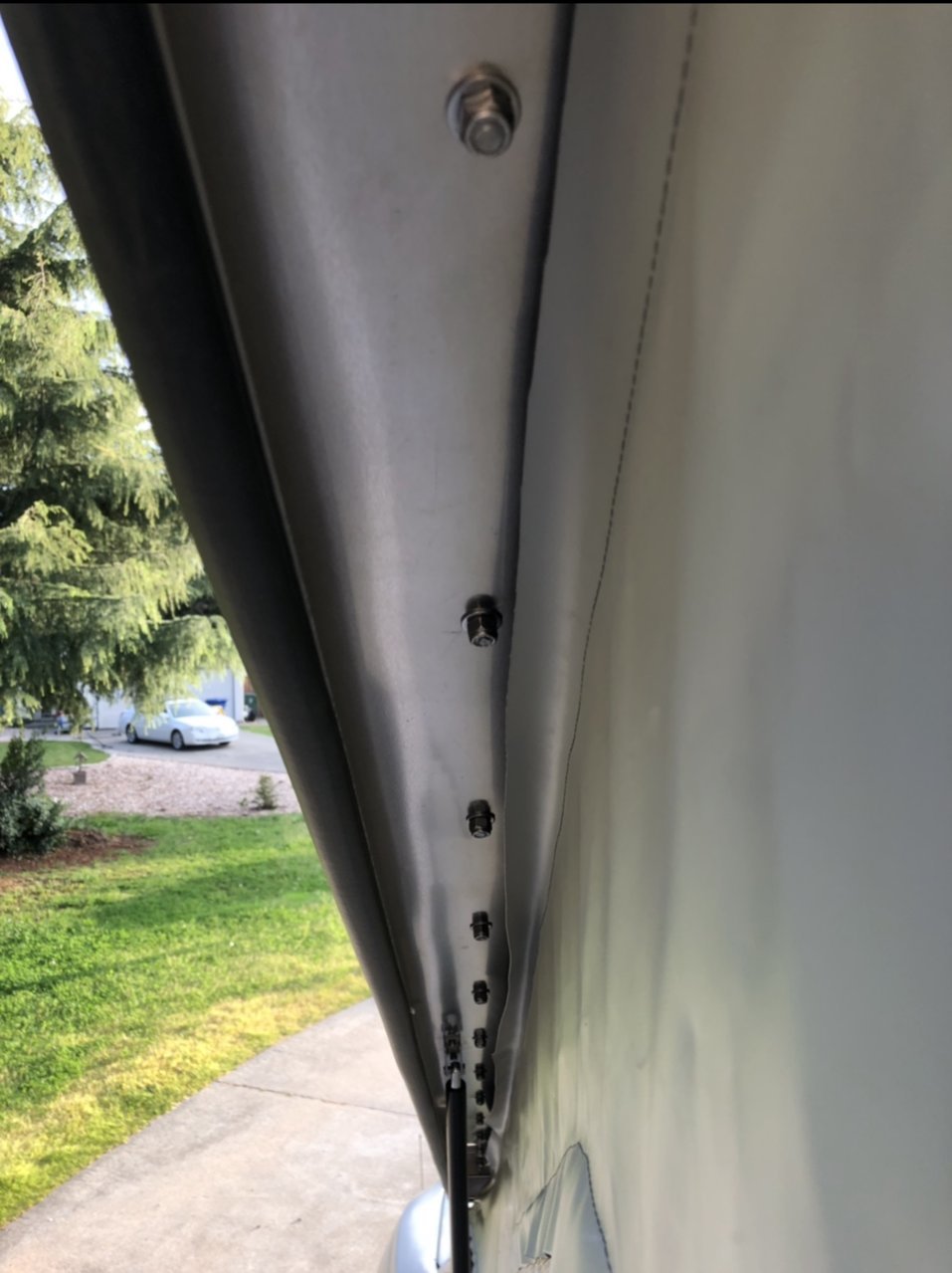

    While I'm waiting on my "Wedgie" ....thought I'd try to trouble shoot a couple of things. I plan on having solar panels on the roof with a house battery inside the camper. How might I route the wires inside the camper? Or, do I install a connectors/plugs within the shell of the camper?

    On the Drifter, ~6" of the perimeter of the lid is still on the outside of the tent fabric. The concealed struts are bolted in that space, as well as the roof L-track, and the wires for my solar.

    My solar is also wired as MJ described - down this channel on the passenger side, and then through a small gap in the tent material at the very front where the two side sections overlap.
    This area in the front is VERY well protected from weather, so no worries there.
    ...Though I just now realized it might be worth stuffing some cotton or something in that small overlap section to prevent drafts since the wiring props that gap open slightly.
