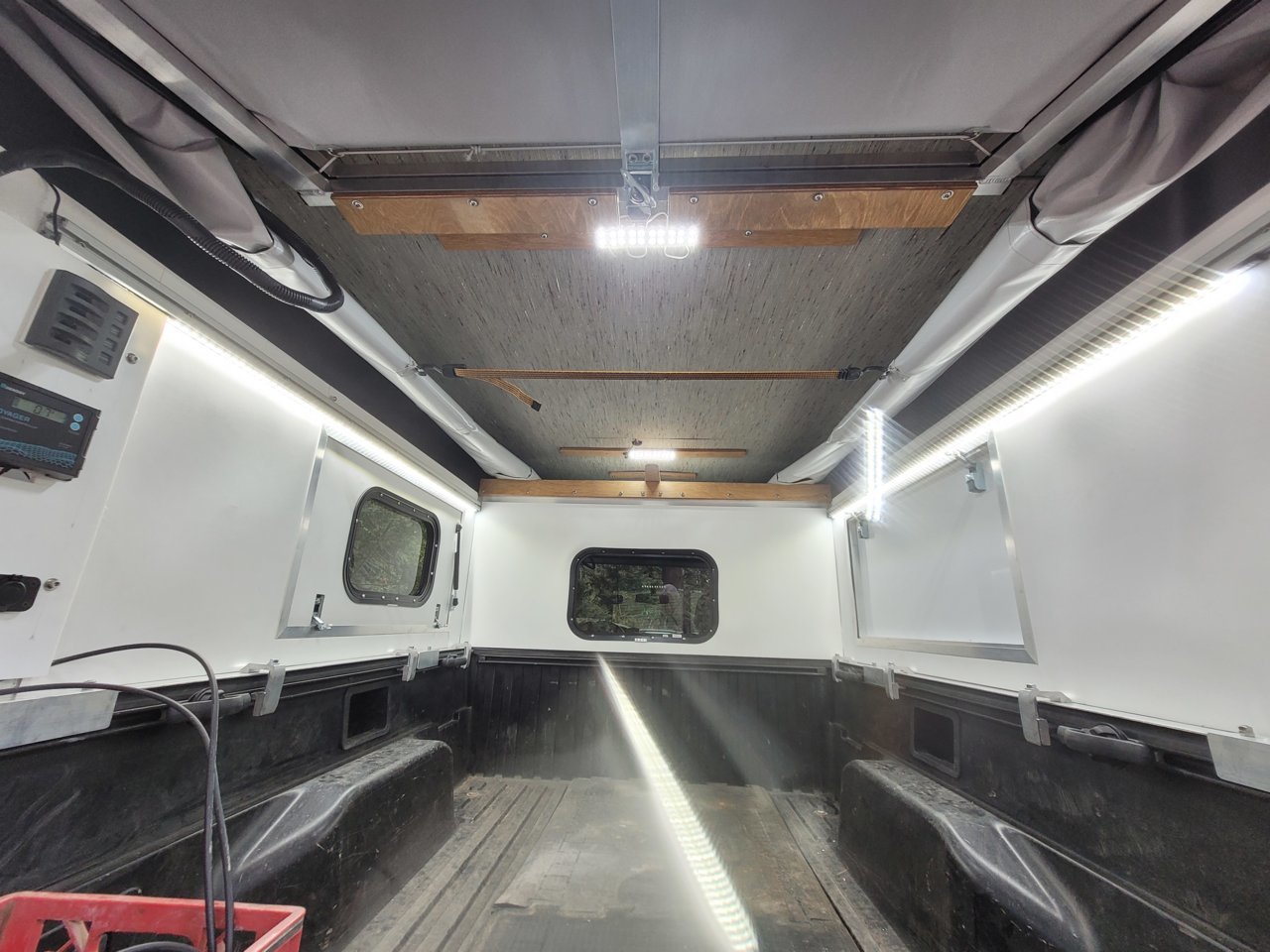

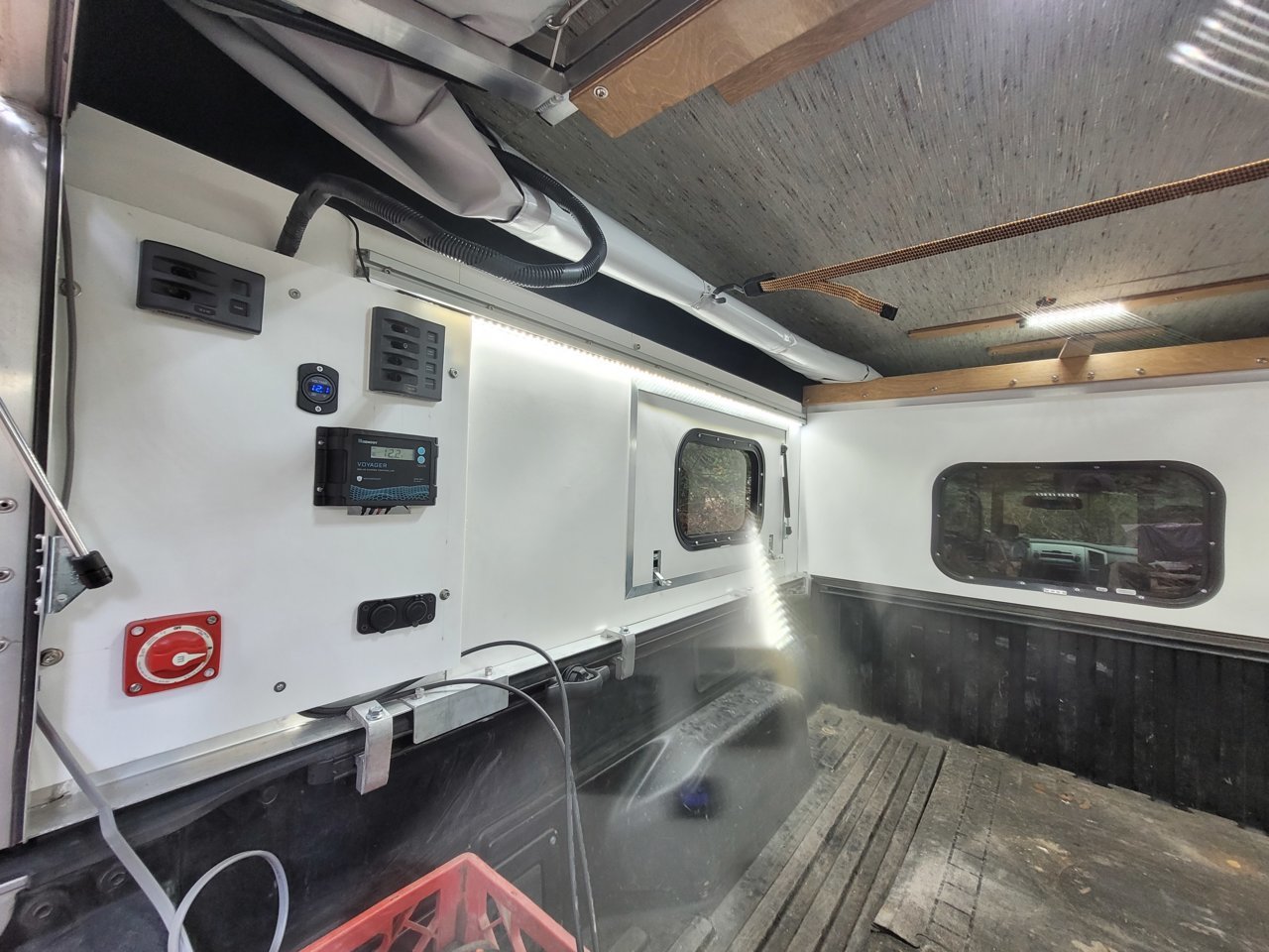

    I want to say I was in line for about 6 months. I think they are out about 10 months now. It's a thriving little business. I'll post some build pics in the next week or three. Insulation Done. Wall Paneling done. Solar mostly done. Roof liner still scheming... Guessing in total I'll be adding no more than ~20#s on the basic build out.

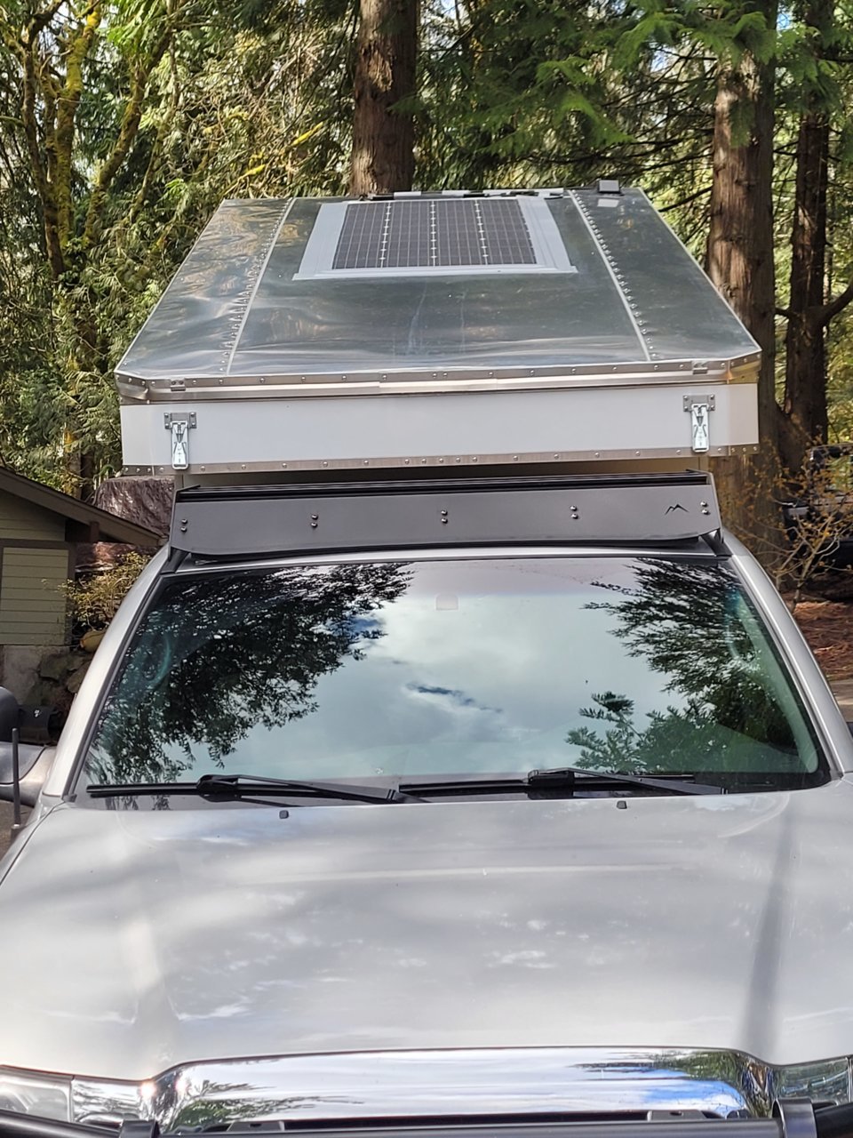

    Checking back in. Pretty happy with how it turned out. Nothing technically challenging just lots of pieces, bit and cuts. 1 inch poly-iso rigid foam broad in the walls and roof. 1/16th inch plastic wall panel for walls. Fabric adhered to "plastic cardboard" attached with velcro for ceiling panels. 175W flexible Renogy solar panel. Various LED lights.

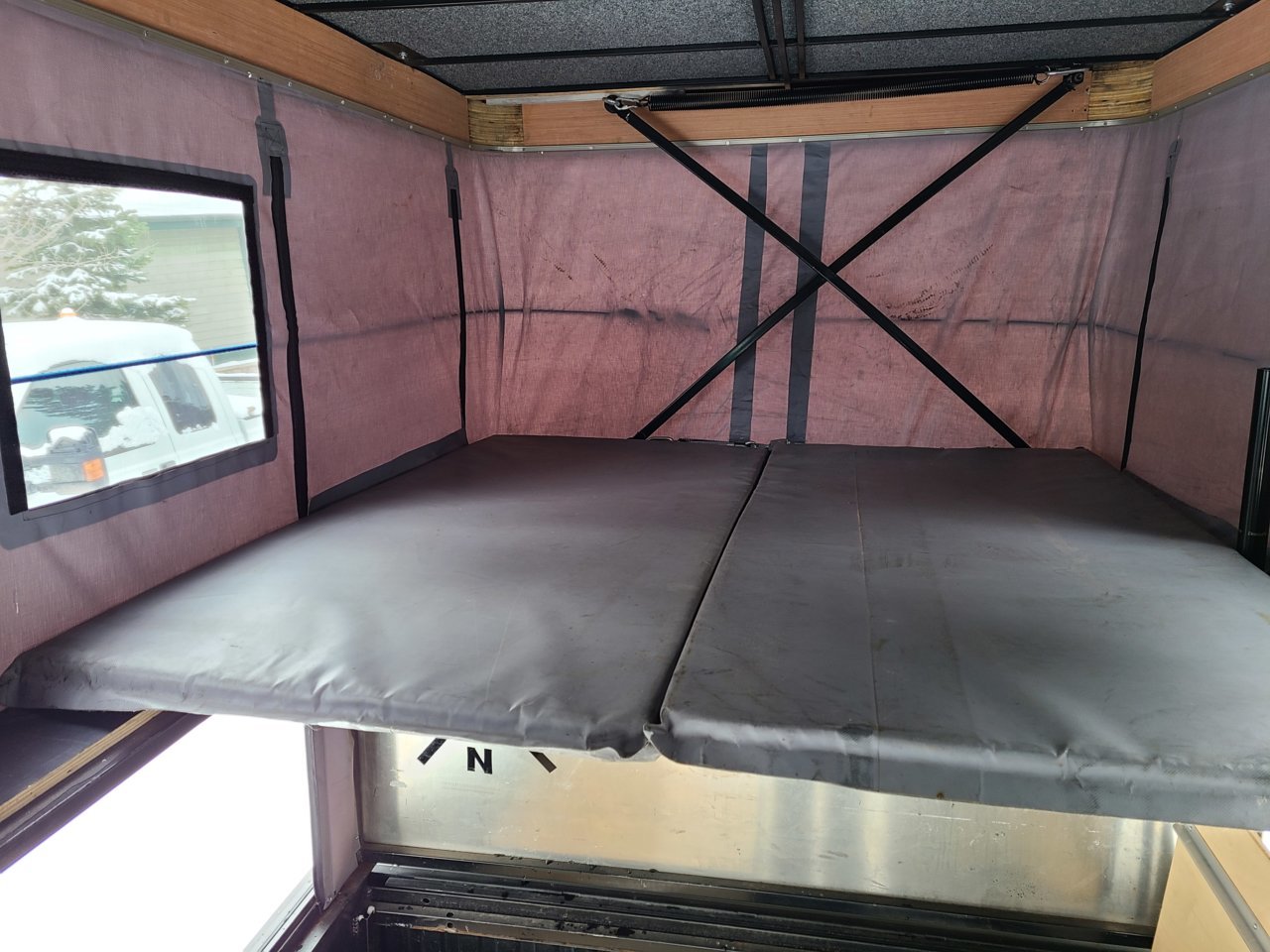

    I have not insulated the vinyl soft sides. I do have a roll of aluminized bubble wrap that I plan to make sides skirts for it, but I've not yet felt the need. I run a Chinese diesel heater, set max low, and it keeps the inside at ~70F with it 20F outside.
