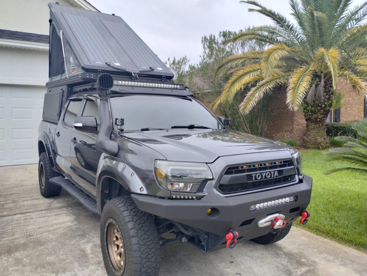

    I am running two 100w CIGS Flexible Panels and love them. With the camper not opened I am pulling an average of 145 on a normal day. When I pop the tent up I'm getting 185+. I used 3M Adhesive Promoter to prep the area and then used the 3M sticky back that came with the panels.

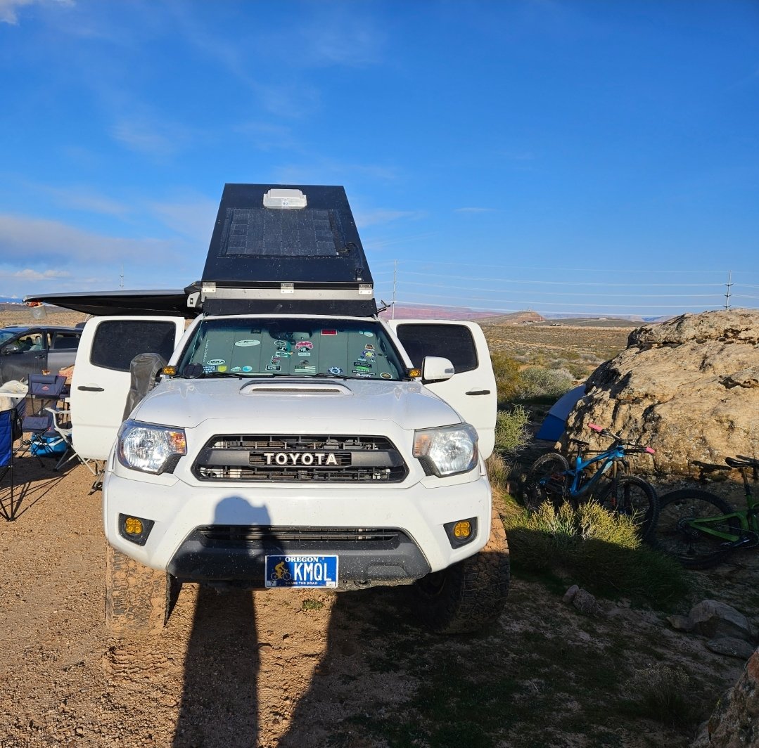

    I have 1 flexible 220. Used the sticky backside and some 3m tape on the perimeter. That plus the acr to the alternator keeps the x2 power battery real happy.

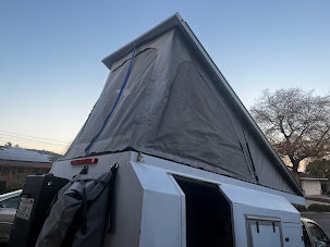

    I ended up driving around with no tent or a half tent for about a year.
    I finally got around to making a tent last year sometime. I kinda miss the open air of no tent though.

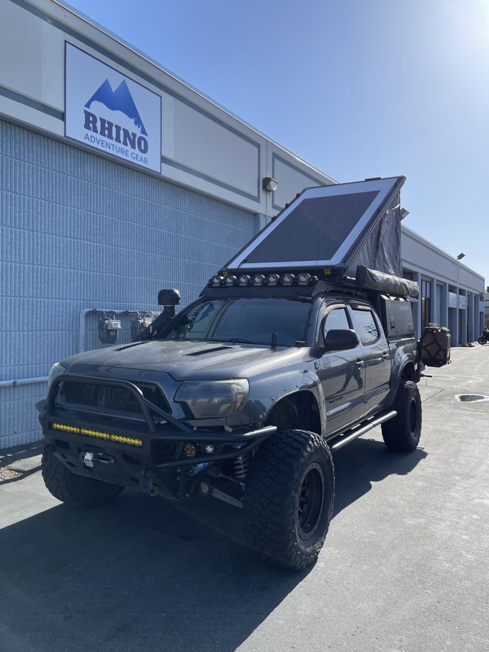

    I have ran several solar setups. On flexible ran 2 110 watt panels and used 3M Velcro’s worked well but if you don’t seal around the edges it’s gets funky.
    Recently pulled them off and upgraded to a 360 watt Merlin panel. will be connected to a red vision setup but haven’t completed the new setup but Merlin’s are great panels. Picked it from Rhino Adventure Gear in Fremont.

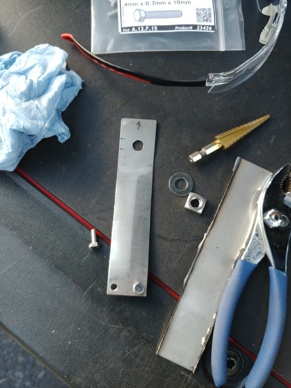

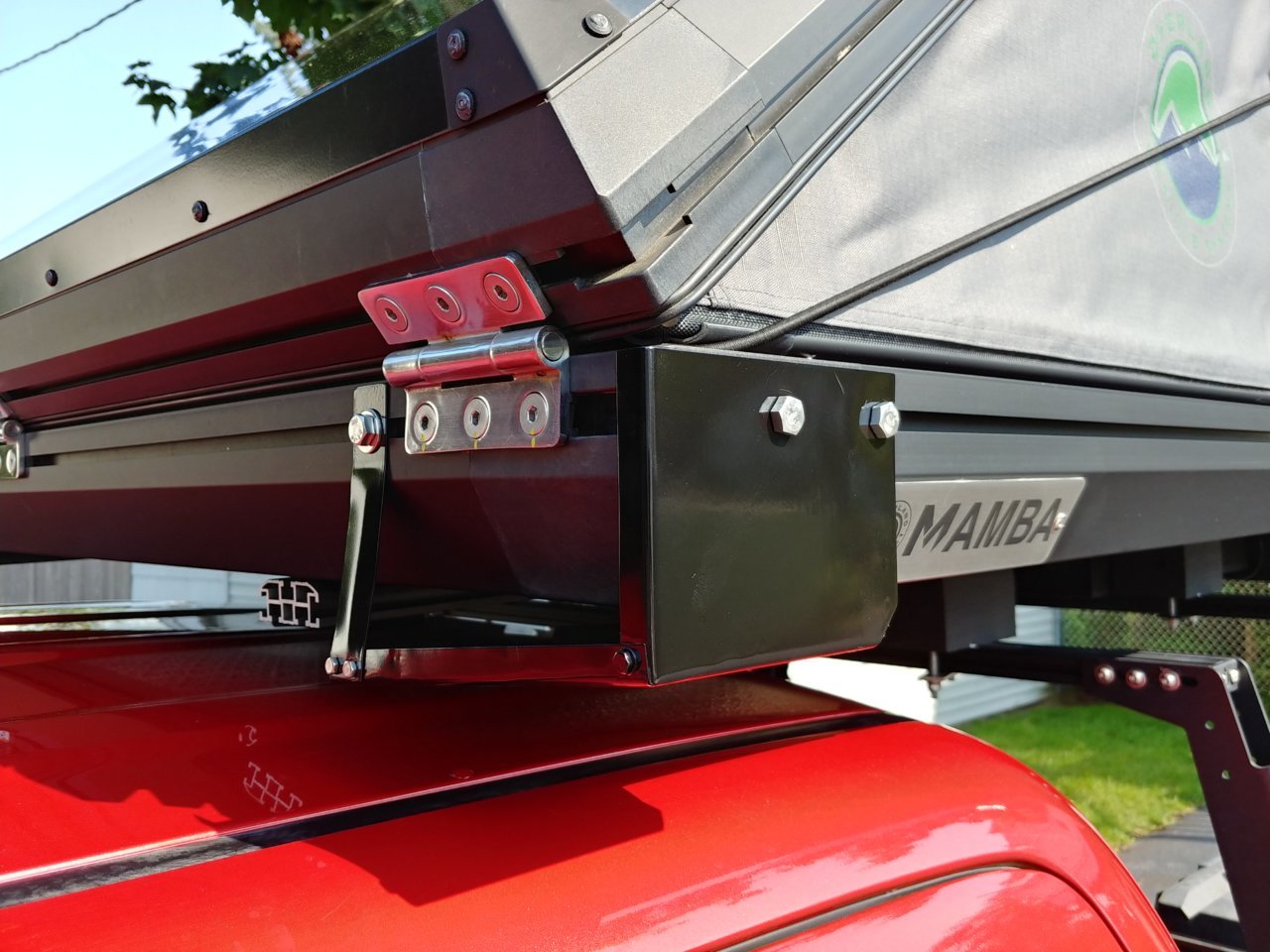

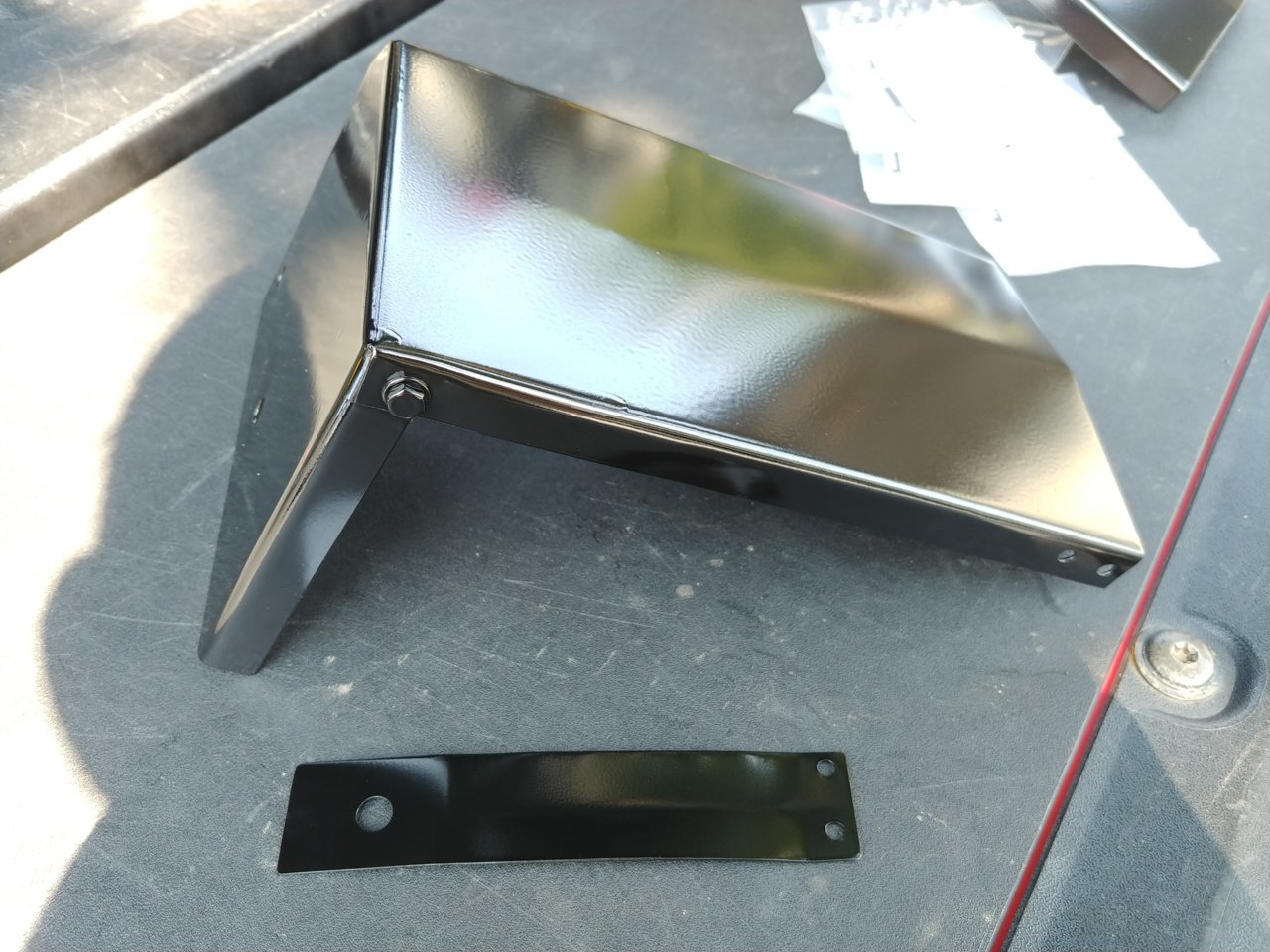

    Due tomorrow, do tomorrow as the saying goes. Finally made some braces for the drip gutters I had come up with earlier this year. To catch the water that drips out of the frame of my stupid OVS Mamba tent.
    The issue has gotten worse over time, luckily the inside is still dry but Im not sure how much longer that will last. Big trip to Colorado for a few weeks coming up in early Sept. Glad to finally have this resolved, and for anyone looking in the future you can bend your own brackets, but you will need some sort of brace like this to maintain its shape on the highway unless you build different or use very thick material.

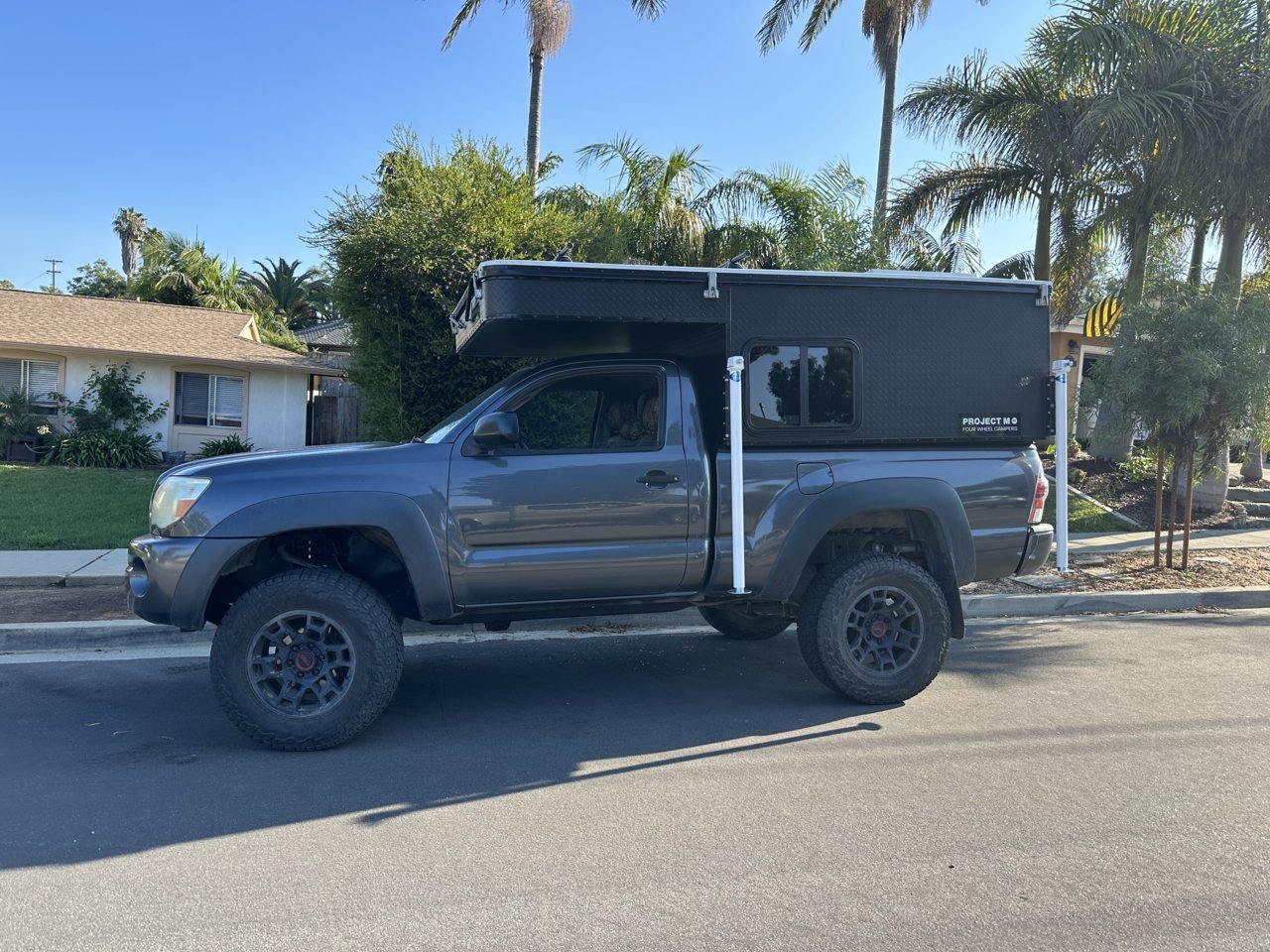

    I’m selling my fwc project m for 2nd or 3rd gen long bed for absolutely dirt cheap in SoCal (ad is in the parts fs section)

    That's no wedge! But I'll let it slide, since unlike other 4WC products, it's just a topper with a bed platform that happens to be parallel to the ground instead of at an angle when open (like a wedge).
    Comparing this to most other wedges, you end up with a larger bed and more usable space if you're taller since your feet aren't stuck in the short part of the wedge, rendering the bed shorter than the measurements. Also, unlike the SuperPacific/GFC, you don't have to disassemble the bed or crawl down a ladder to get out of bed since there is an opening down into the truck bed while the bed is fully deployed (like a Vagabond Drifter).
