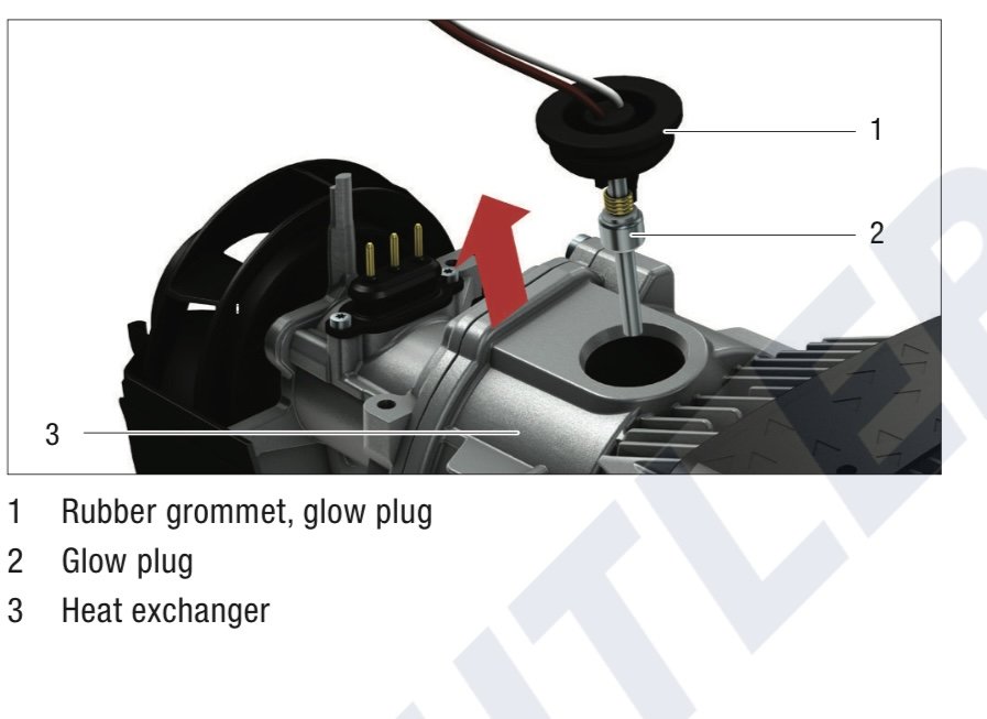

    I wouldn't expect this to have any relation to your gelling issue, but FYI when you mount the Chinese heaters on their side, supposedly the glow plug has to be on the top. Unless they make some that are oriented opposite, which I'd say is extremely unlikely, then your glow plug is on the bottom.
    I'm pretty sure the reasoning was that the fuel can leak out if the glow plug is down, which would be a pretty big hazard, if so. It's worth checking on that to make sure.

    Interesting call out. Looking at the tech manuals shows the glow plug directly on top of the heater. I can't find anything about needing to reorient it but I’ll keep looking. Thankfully haven’t noticed any fuel leaking. Easy enough to pull the cover and check. Appreciate everyone’s input!

    Oh, I missed the Espar part. I assumed Chinese. Hopefully you'll be good to go.
