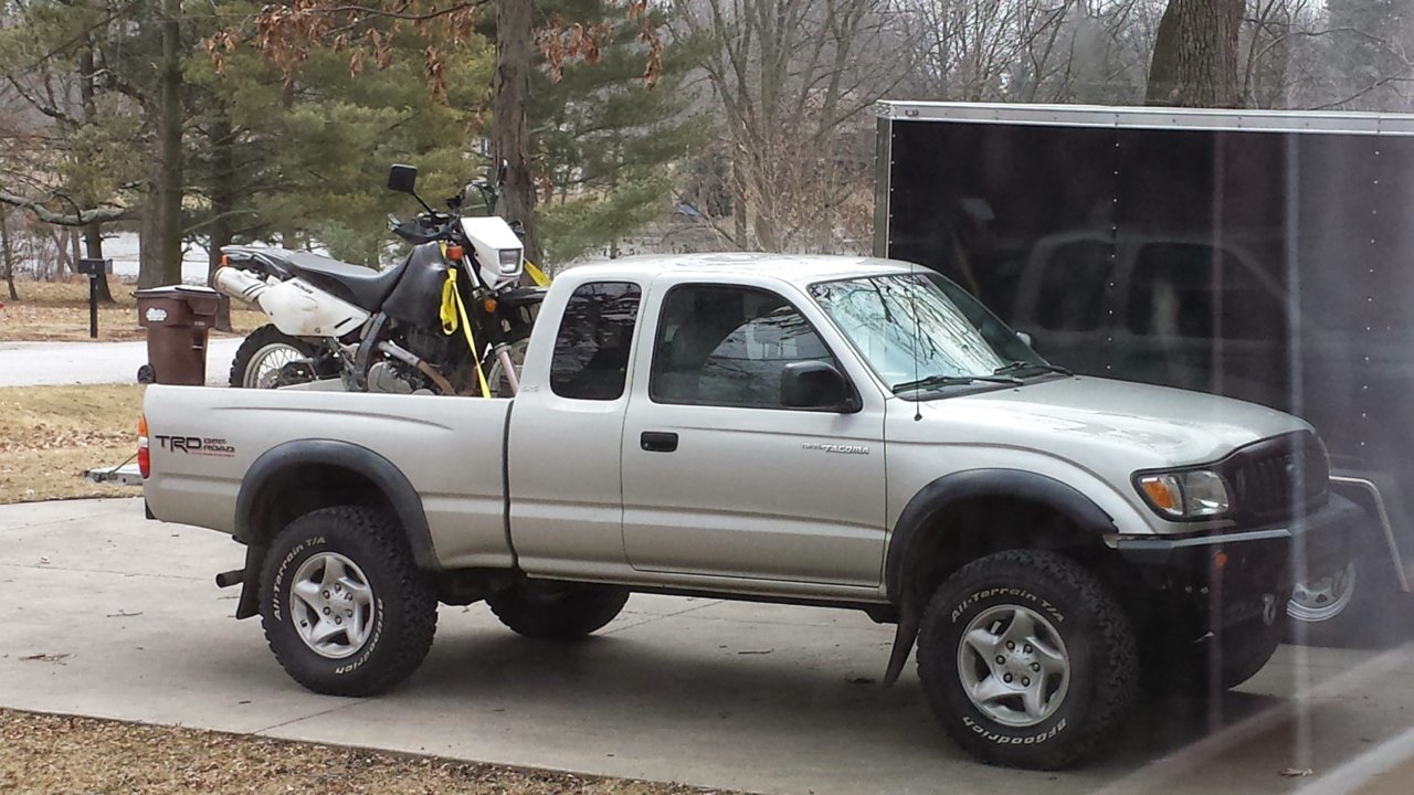

    The Drifter doesn't need much to accommodate it. Here's basically what's in your bed. This was my truck with OME +AAL and a 365lb dual sport bike. Not much needs done to your truck.
    Similar response to this question here.
    https://www.tacomaworld.com/threads/the-drifter-specs-and-faq.540826/page-122#post-20853505
    AAL is all you would need. Boxing the frame is a nice to have, depends what you are doing with the truck. Bracing the shock mounts is unnecessary if you aren't wheeling it. If you are wheeling it, replacing the stock setup altogether since the 1st suspension setup is not great.
    Regear is absolutely UN-necessary and a waste of money if your tires aren't over 33".
