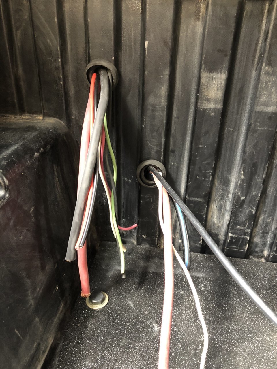

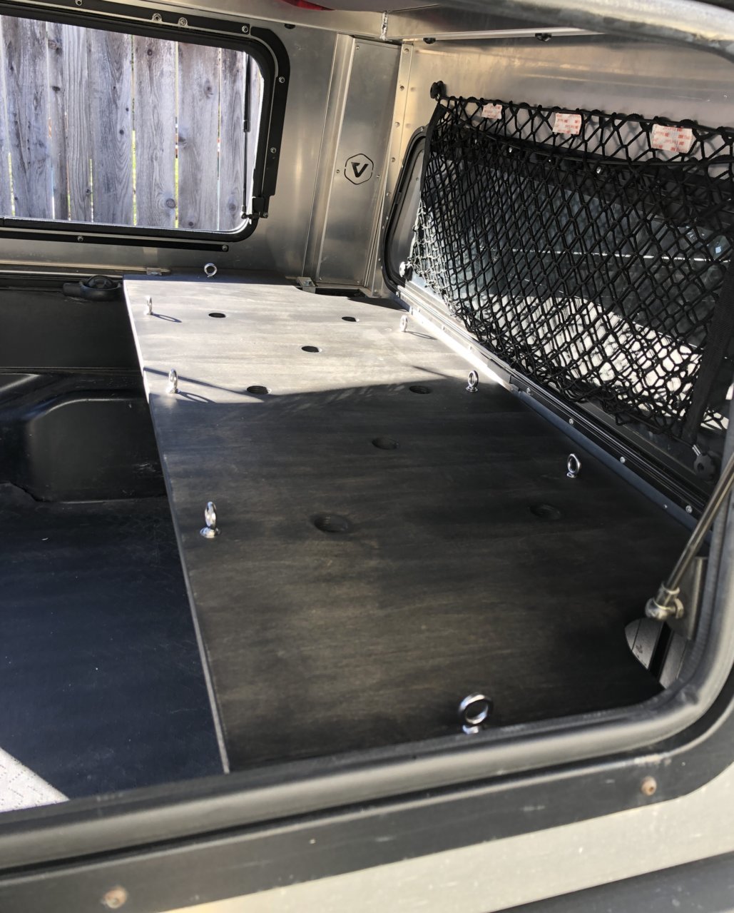

    I have a ton of electrical mods on the camper and in the bed, which required a bunch of wiring. Ran all wires in between the cab and bed using two firewall boots
    You can also see in the above pic the platform that I made. I had an old bed mat that I essentially traced on a sheet of 1/2" birch plywood. They only had 4x8 sheets at Home Depot so I cut out a small piece to fill in the rest of the bed on the left side and connected it by the Kreg jig edge joining option
    You can kind of see where it joins in the next picture on the left, but it's hidden well by the roll on Herculiner.
    I reused the OEM middle and rear bed bolts to fasten it down, but got longer bed bolts for the front two bolts (can be seen two pictures up)

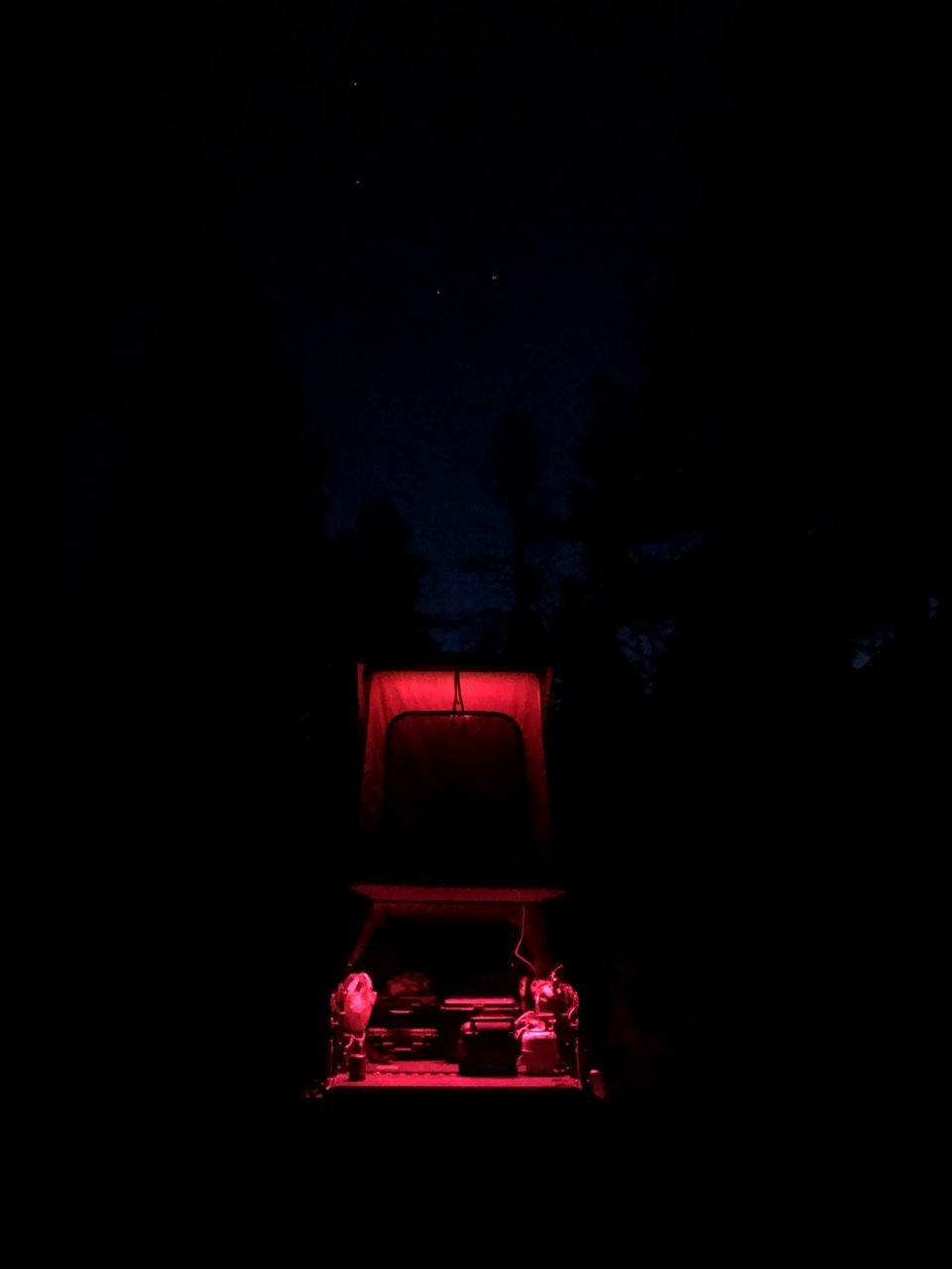

    Everyone has different interior lights, some come factory from these camper companies. I opted to wire my own LED strip in the lower section.
    Up top is a cheap LED bar with it's own switch so I can control it from up top. Stole power from the fan.

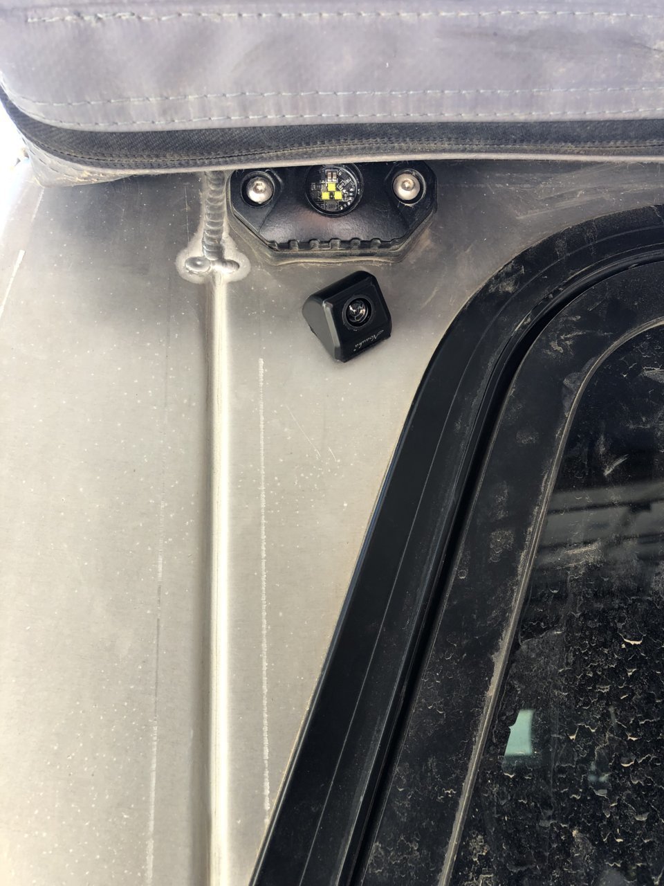

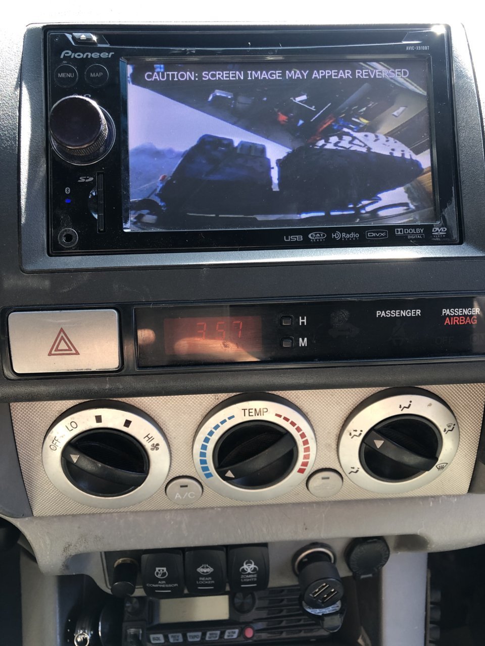

    Rear lights turn on in reverse and/or from a rocker switch at the rear of the camper. Helps a ton for night time cooking on the rear bumper swing out.
    This is also where I added a reverse camera since the tailgate handle is covered by the rear bumper swing out
    Everything electrical has a quick disconnect in case I want to take off the camper (even though I've only done this once).

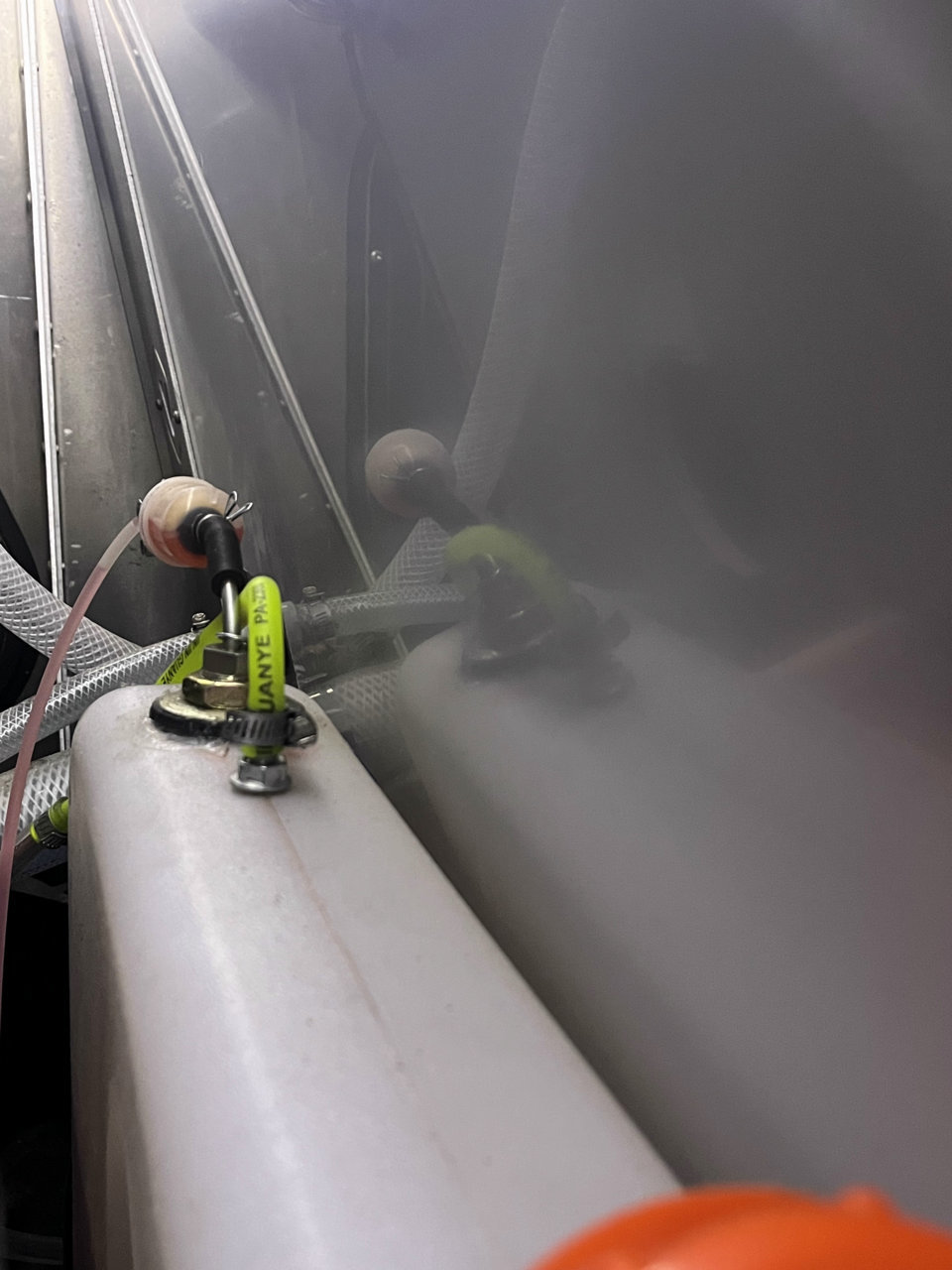

    Heating. I really wanted to go the Propex route, but instead did a Chinese diesel heater. Originally got an all-in-one unit, but have since taken it apart and installed it very custom for my needs. Did this for several reasons: larger tank (now 10L), easier access to add kerosene (every now and then I'll mix in diesel), and used a stand pipe to eliminate potential gravity leaks and because the stock fuel line didn't reach the bottom of the tank.
    Larger 10L tank hidden behind the fridge (easier to fill in this location)
    I also added a breather (similar to the diff breather mod) since the tank is stored inside the camper and this eliminates leaks and smell. Routed it to the where the upper bed cubby that I replaced with ABS plastic to seal.

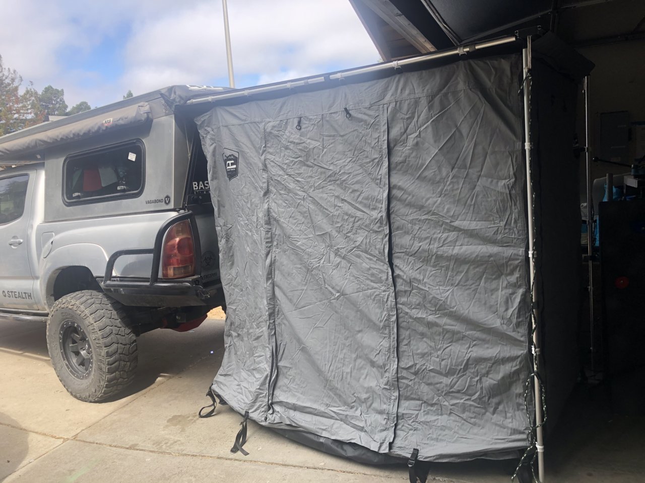

    Other exterior mods
    Added L-Track to the side of the camper for Maxtrax boards and shovel mount.
    ARB 8' awning on driver side
    55" CVT Hybrid Series awning off the rear. I believe it's the smallest awning that you can attach a room to
    To mount the L-track and the awnings, I used aluminum flat bar on the inside of the camper to strengthen it and close cell foam to prevent any leaks. Also used silicone on the bolts for added measure.

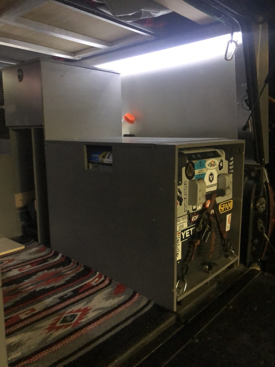

    Boo!! Haha no I hear ya. After our 2nd baby I now sleep downstairs on a small folding mattress like a peasant while my wife and 2 kiddos sleep up top.
    That’s actually the reason why I switched the rear awning to one that has an attached room. The idea is that when they’re old enough, they sleep down there while the wife and I claim our space back in the Drifter.
    Yea same. Been through a few revisions, it was actually kinda hard compiling pics for the OP.

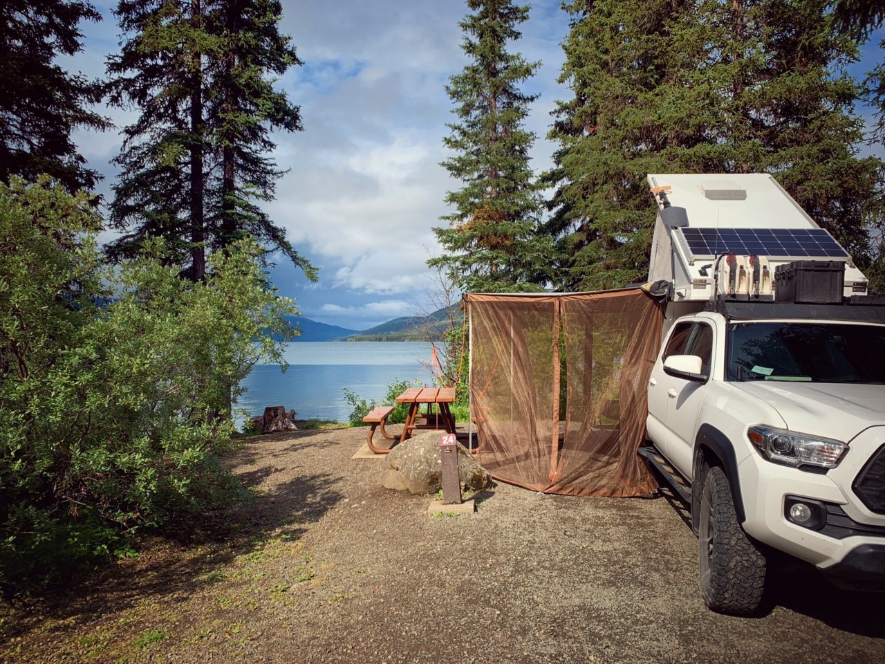

    I have a Vagabond Drifter, #6 brought second hand in 2020 from @Anderson
    When we camp we usually move daily.

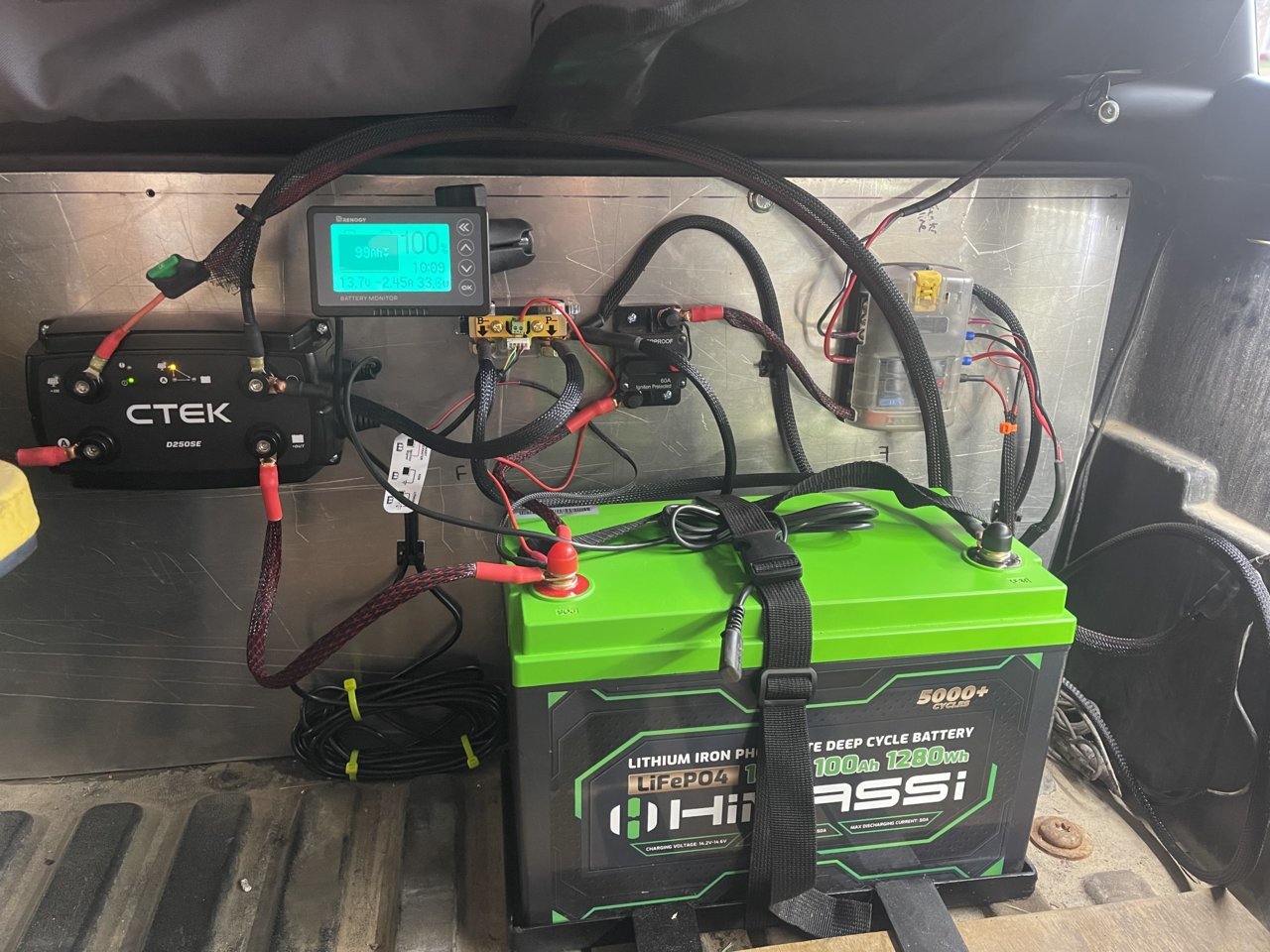

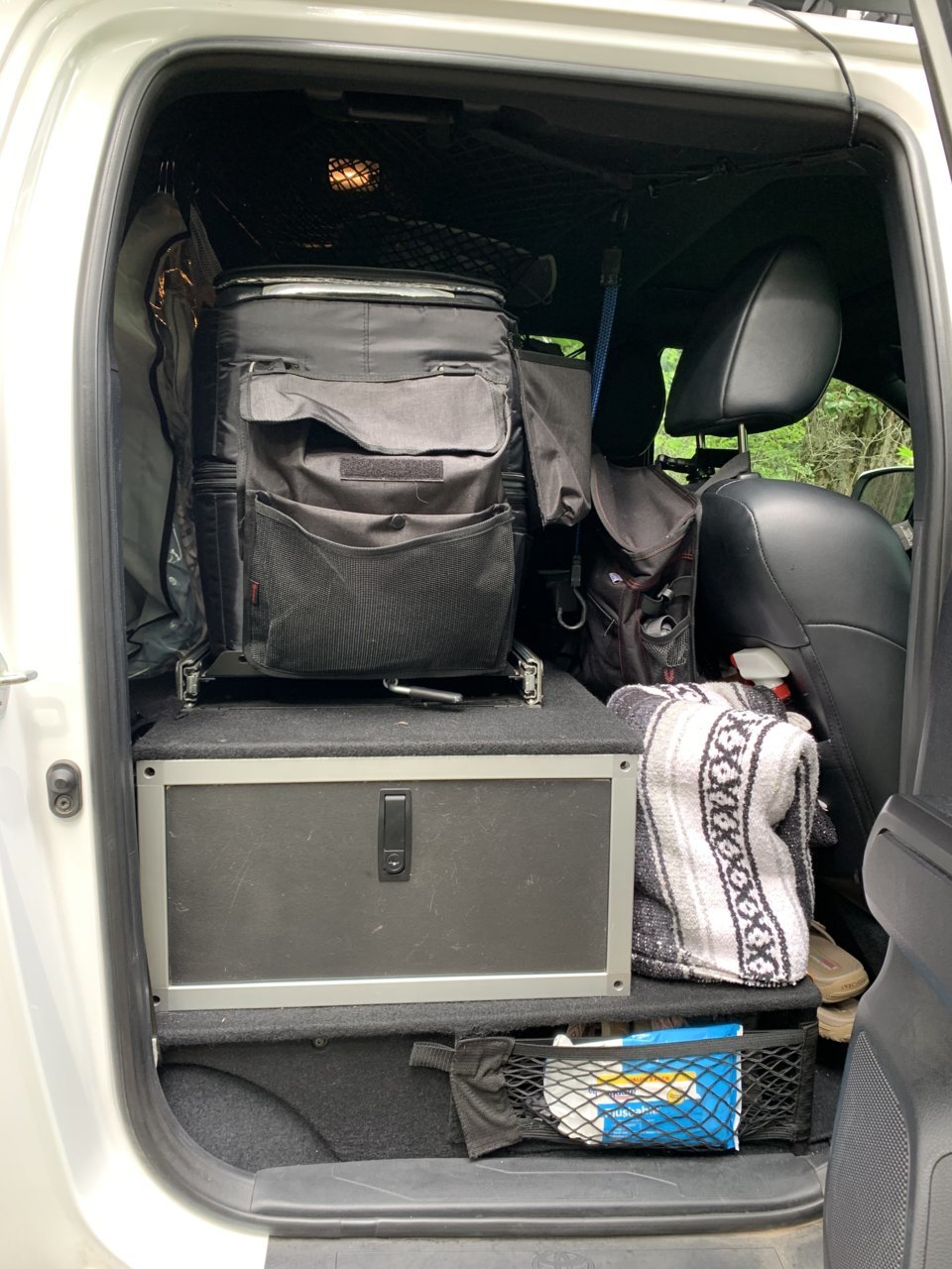

    Starting with power, I run a single main Optima Bluetop D31M battery (I run a HKB electronics voltage booster) connected to a Cascadia 90W hood mounted solar panel, we usually only run the fridge consistently and I find the battery has no worries keeping it running thru the night (have stayed for a couple days without moving no worries) all our accessories run thru a 'low level disconnect' so in the event the battery actually gets low (adjustable setting) it will cut power to the camper etc. We live in SoCal and generally camp in fair weather - ie we dont camp in the snow. We carry a NOCO GB40 battery booster as well

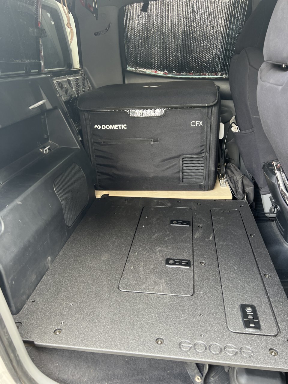

    Dometic CFX3-55IM located in the backseat on a homemade 40% seat delete allows us to access when driving but not hear it thru the night. Recently deleted the 60% seat with Goose Gear. I homemade some window covers which drastically reduces heat in the back of the truck
    We run lights in the camper, factory installed in the wedge which was white and I covered using a 'red light tape' picked up from local auto parts store, helps keep the bugs away. The Lower level has some @Anderson installed led's in the channel. We generally don't use the lights too much at camp, partly as we usually have a head lamp with us - partly as most of our time is spent outside anyway (see above fair weather camp comment)
    I made a shelf to store our bags keeping them above the floor and allowing easier access when changing or thru the side frontrunner doors - and still allowing space underneath to store things.
    Our camp stuff we keep in some pelican cases, allows us to be modular when grabbling things (only going for a night we only need this bin, going for 12 days - need these ones) They are water and dust proof (?) - and double as tables or whatnot at camp. As my wife has a 2017 with a GFC we can easily move things between trucks as well
    Both trucks run Mountain Hatch tailgate inserts and both have swing outs with tables, so we can have a lot of 'kitchen space'

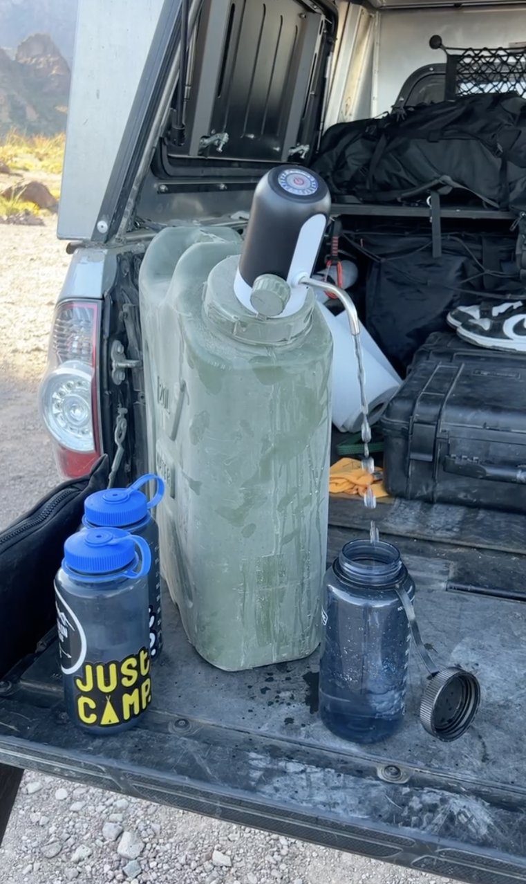

    For water we use Scepter water cans and now use this rechargeable $20 Amazon special water dispenser, it slots on top and provides running water, we also have one with a JAGMTE pressurised kit (we have on-board air) which we can shower with or wash hands, etc etc
    We have VRNCLR sewn storage top shelves in the tent to hold all the things

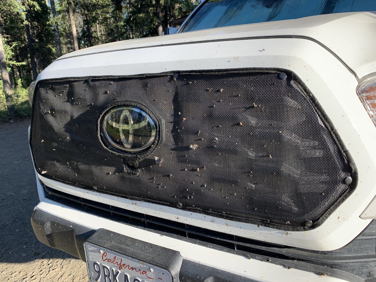

    Made a few screens for our trip to the Arctic Ocean. Saved our sanity and the radiator.

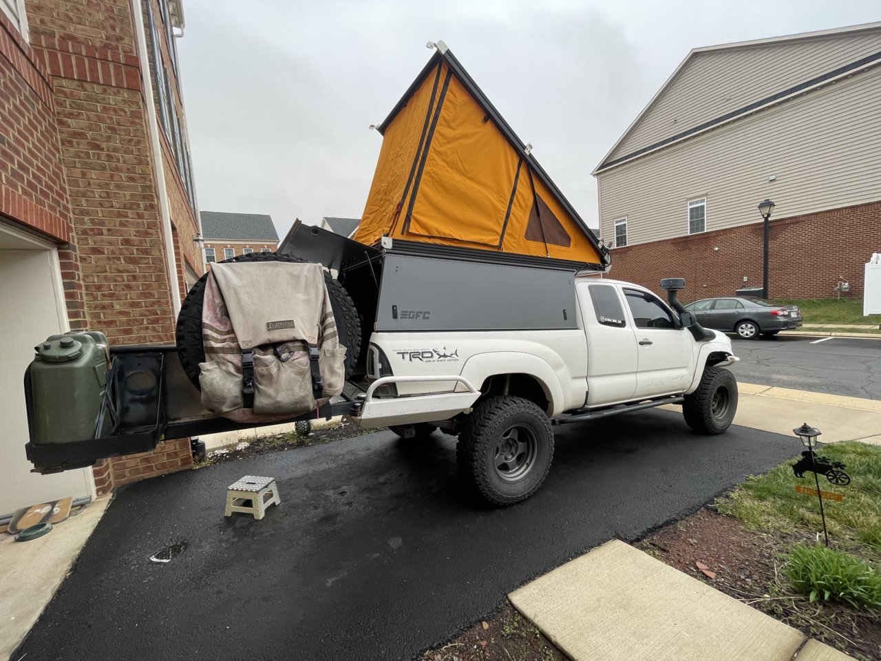

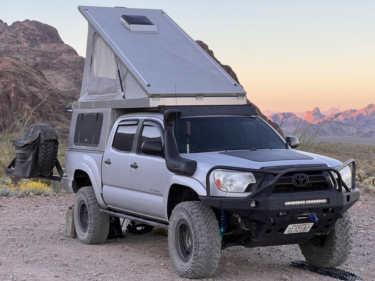

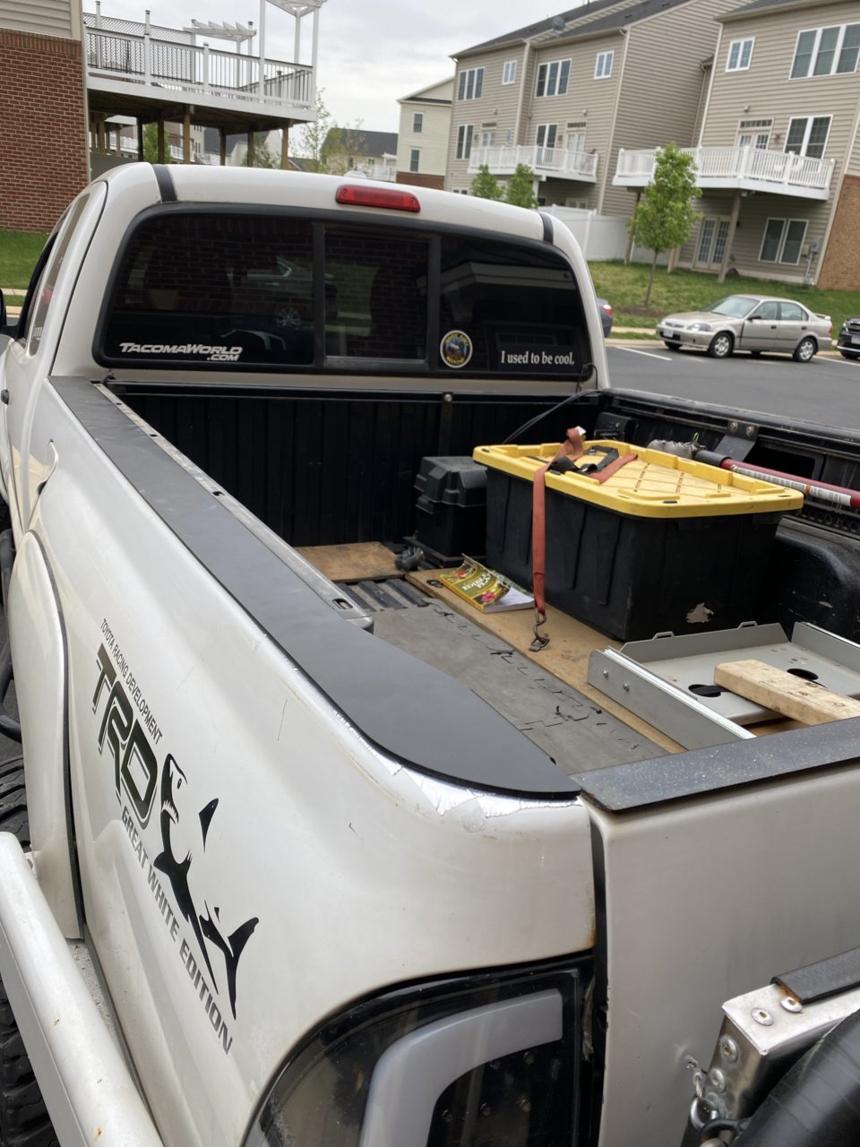

    Picked up my GFC in 8/2021. Had to get the truck ready for it to be installed. Added KB Voodoo aluminum bed rails, sealed the bed as best I could. Also ordered some 8020 to make my own cross bars.
    After I got back from driving VA > MT > VA (and a few places in between) I ordered a Duluth Trading Co seat back organizer. That adds alot of storage.
    Also built out a dual battery system. Dual inputs: solar and trickle charging from the alternator. Haven't had any issues with this setup.
    I also got distracted with a new-ish hobby - adventure motorcycles. Took me back to my roots of ground tents. But makes you appreciate the amenities that a gfc and other truck camping accessories can provide.
    Truck still exists, but mostly a dd. Its crossed my mind to go back to a fiberglass shell or even a GFC shell and a RTT, but im not there yet. Plus i have both of those combined already in the GFC camper. Its not hurting me to keep them, so i will.

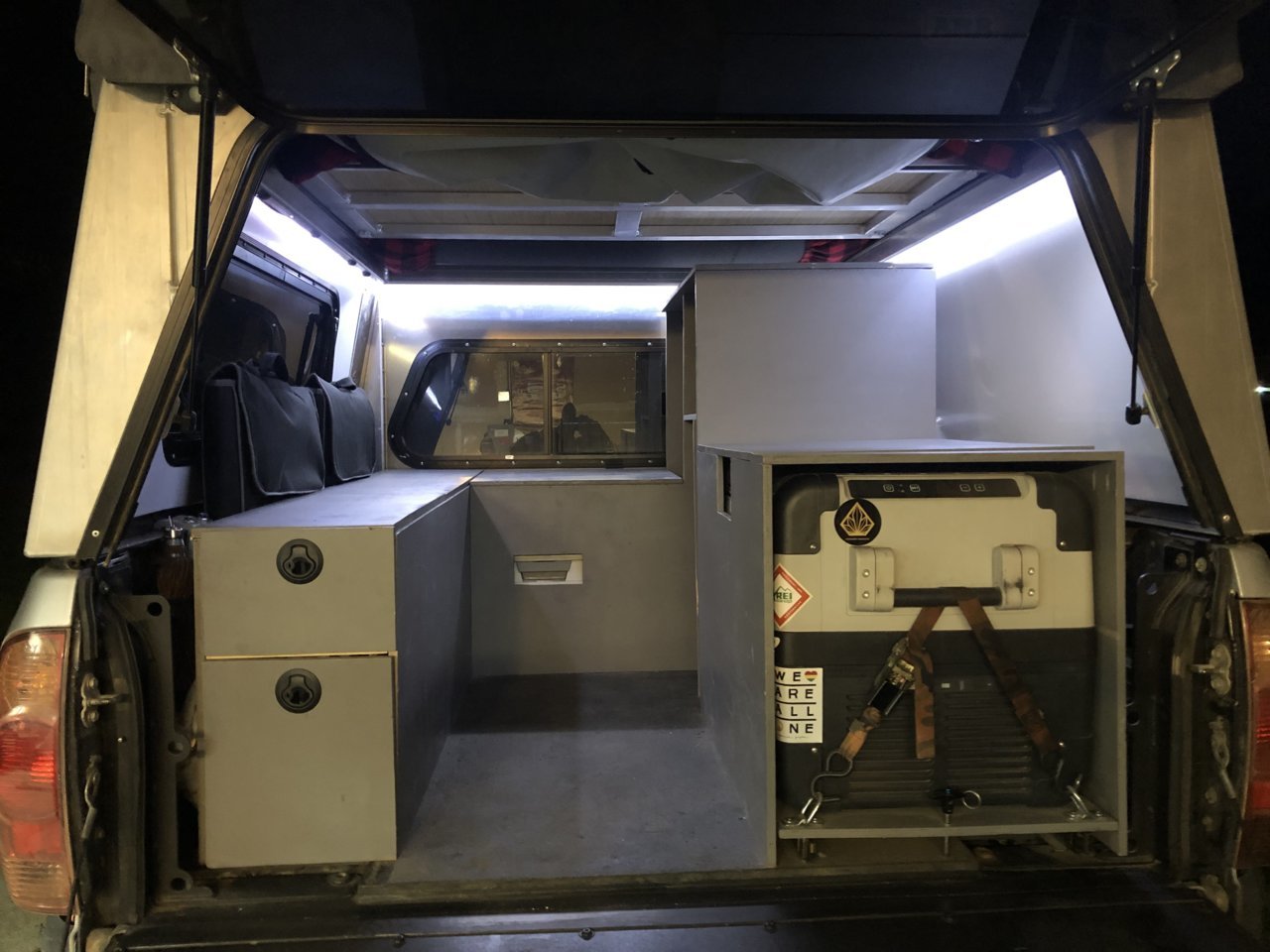

    Built storage in the back of the bed and the back of the cab.

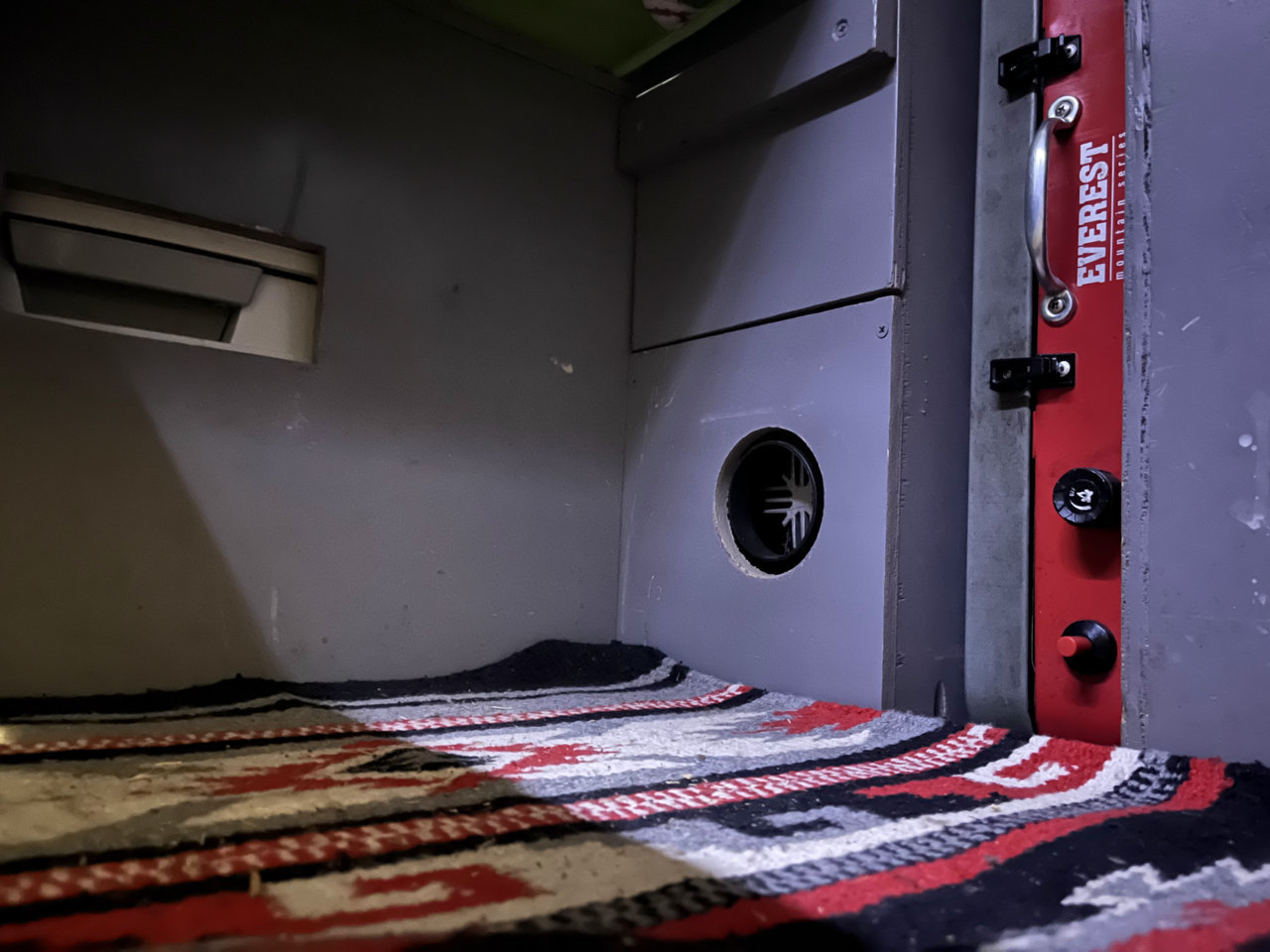

    -Interior is a center aisle layout with top counter on passenger side
    -The BCDCs throttle charging down when they get hot, so I'm trying to help cool it. I've even added a heatsink and fan inside the thing, but it's still not enough to keep it from throttling down from the max charge rate.
    -Couple wire mesh drawers
    -The mixer valve feeds both the pot filler faucet used at the tailgate, and the folding faucet on top of the counter

    -Yes, I have two diesel heater controllers because the blue one works with a little remote I can take up to bed when needed, and the black one gives the burn chamber temp, which is necessary for the method I use to tune for elevation. I've definitely considered just ordering the "Afterburner" controller, but this way works fine for me.
    -I just use LCI cans for water, plumbed in through a quick-disconnect
    -The compartment to the right of that is my battery (12v 560ah self-made from raw LiFePO4 cells), BCDC, distribution blocks
    -Above that is the 2.5gal water heater , thermostatic mixing valve, and some other plumbing ....I know, FAR from ideal electrical and plumbing arrangement, but I've gone to great lengths to address it with plumbing sealant, electrical fusing, even a water alarm in the battery compartment
    -In order to have the top of the fridge and compartments all flush (it was so my dog, who's gone now, could have a nice sleeping platform), I only had enough clearance for the e-panel as a lid for the water compartment - like I said, function over form, haha
    -Just a bunch more gadgetry in the front driver corner
    -Top down view into the front driver cabinet, where the stove, diesel heater & tank, 12v "oven", GoTreads, toilet stool, etc live
    -The heater exhausts out the side of the bed and runs down behind the rear tire
    -And it blows into the aisleway
    -The fridge is a dual zone, 62 quart, I believe. It's definitely overdue for a new top Reflectix cover, at least

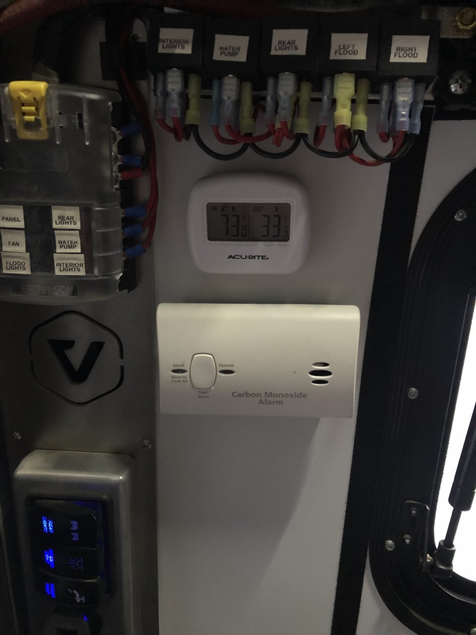

    -Fuse blocks (again, not pretty, but it's done safely)
    -500w pure sine inverter
    -Main switching
    -Main battery/power display
    -LED strip (warm white/R/G/B) along the roof perimeter for lighting
    -I've added a variable speed controller to the original 3-speed Fantastic Fan
    -GoPro mount right below that for which I setup an articulating arm that holds my tablet to watch a movie or youtube in bed
    -And there's desk mode. A few years back, I had Phil make me 2 custom bed platforms (I want to say maybe 14" and 19"?) to replace the single 30". Just much more convenience and usability for me that way. This config also puts me at perfect window level, so I always get the view while I'm working.
