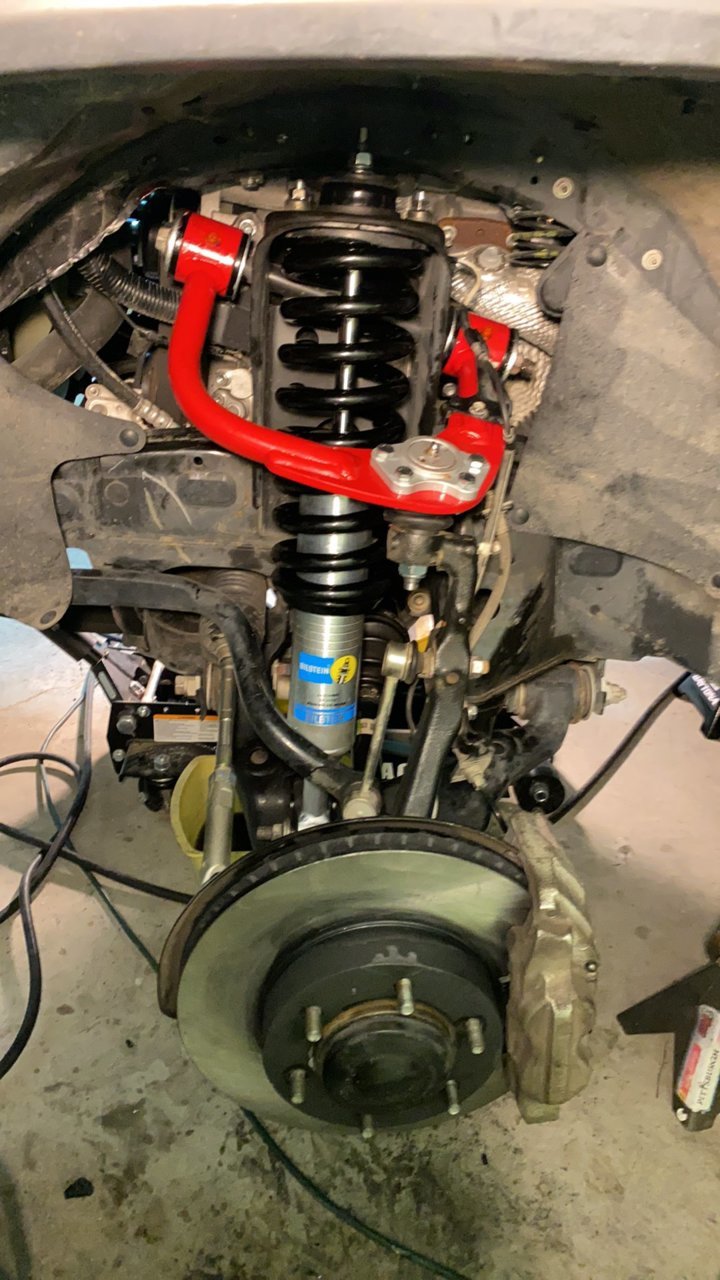

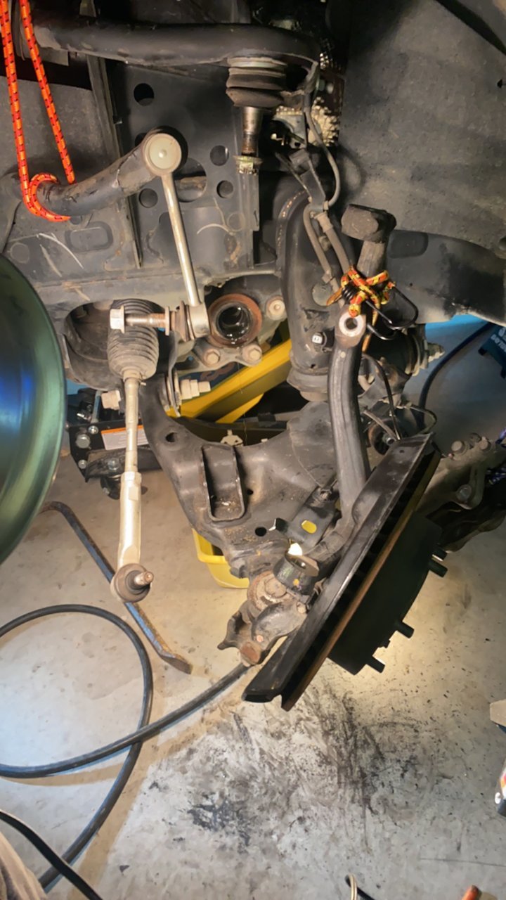

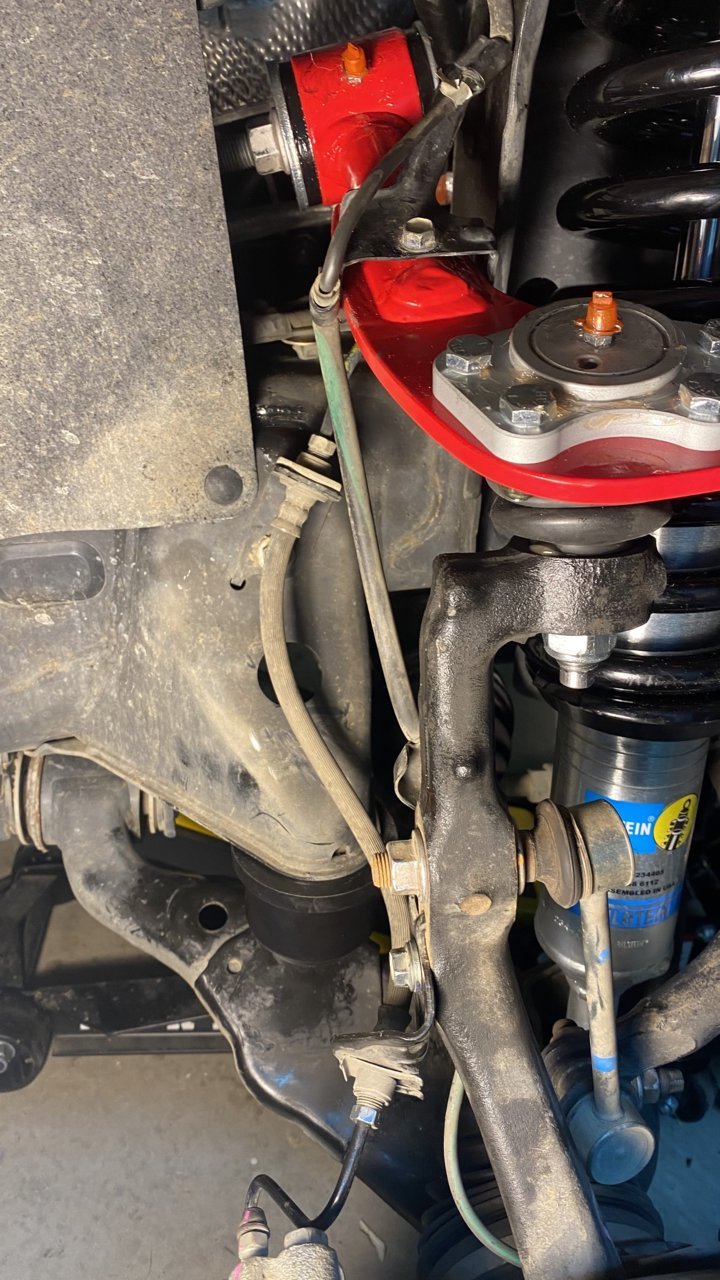

    Here are some pics of mostly the front in process:
    Here's what it took with an air hammer to get the UCA bolt out. Ugly but it worked.

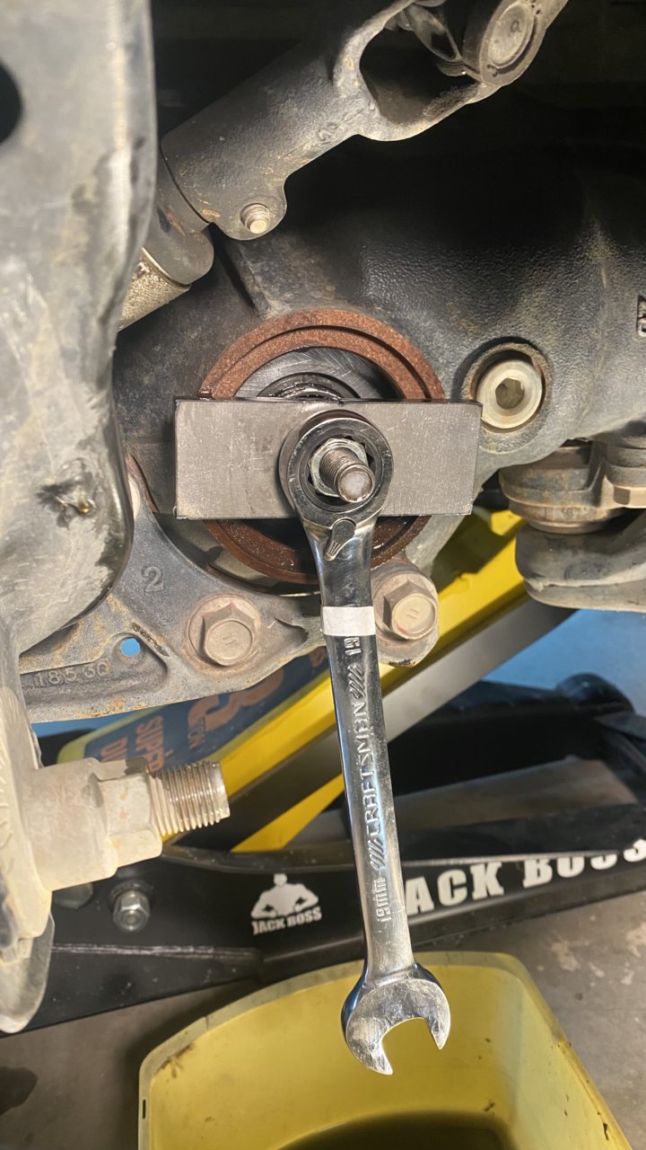

    Doing the ECGS clamshell bushing swap...
    The 19mm ratcheting wrench is definitely your friend here

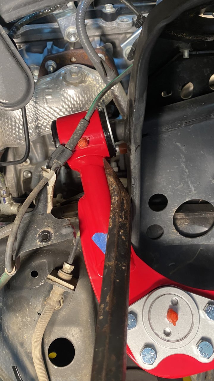

    Using a pry bar to gently position the JBA UCA in place was a breeze. Just get your bolt and first washers started and slide into place...
    ABS line was a bit tight on the passenger side so I was able to pull some slack from either end of the mounted strain relief.
    Front completed..
    Doing the leaf packs was kind of boring so I didn't document that too much, but here's the final produce. 3" in front and 4" in rear at the moment...
    Yes, I know, the tires look small....
    Next to a stock '21
