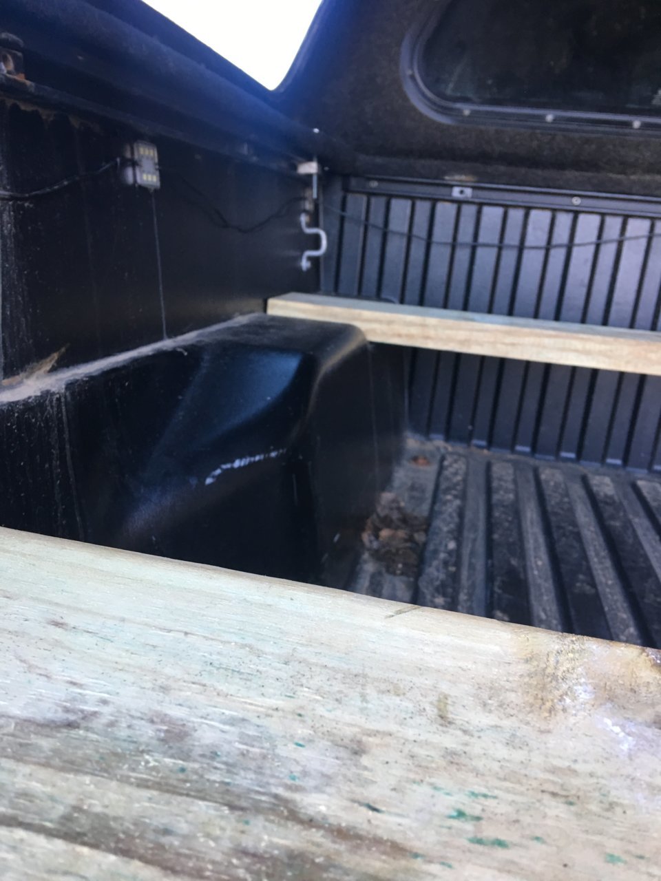

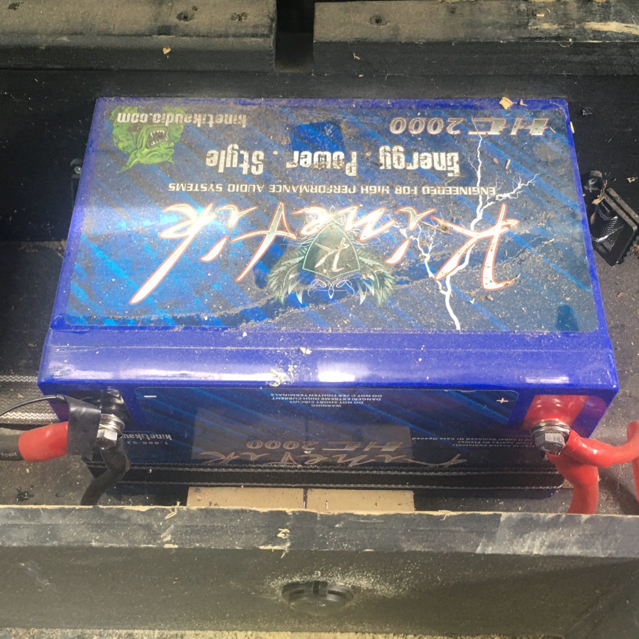

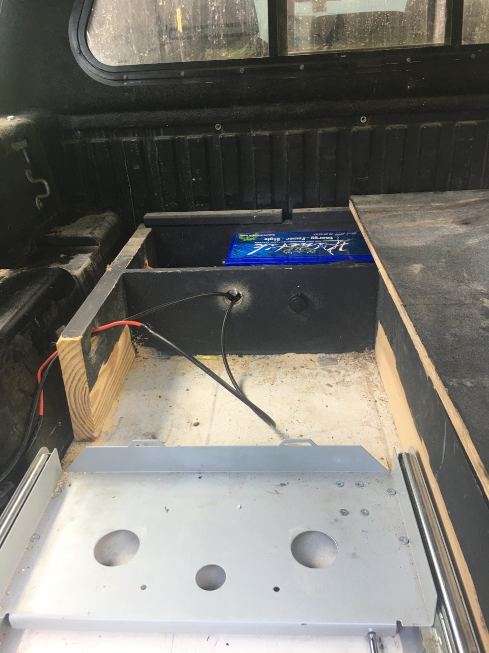

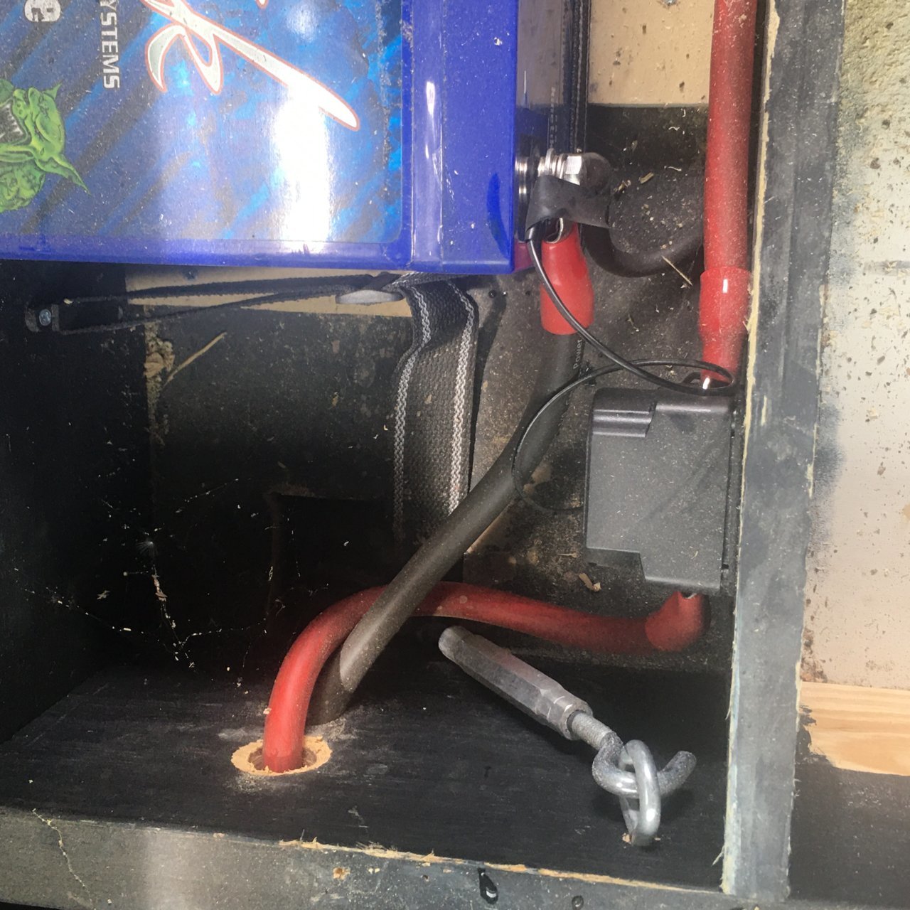

    So I knocked out some stuff in the back but in the process of doing stuff, I didn't take many pictures. I did manage to capture my dirty battery and isolator setup. Originally I was going to swap out my current battery for an Optima yellow top but after finding out that my problem was just a bad ground I decided to take another route (if it's not broken don't fix it)
    Charge isolator separating the second battery from starting battery
    This is an old competition stereo battery that has done nothing but hold up strong for years. It holding around 12.83 V charge when disconnected from the main battery. I had it laying around for a while when I was going to put a sound system in my old Trooper. The battery was overkill but it's now serving its purpose as a secondary battery for accessories. Thanks @Arcticelf for helping me on the decision of the yellow top even though I ended up returning it today.
    Specs for the battery https://www.sonicelectronix.com/item_10461_Kinetik-HC2000-Special-Application-Version.html
    I ran another 12v cigarette outlet to the backside of the drawer system for a cleaner install of my fridge instead of running a 12v extension cable from the front to the back. That now opens my 12v cig outlet on my blue sea panel upfront for some charging.

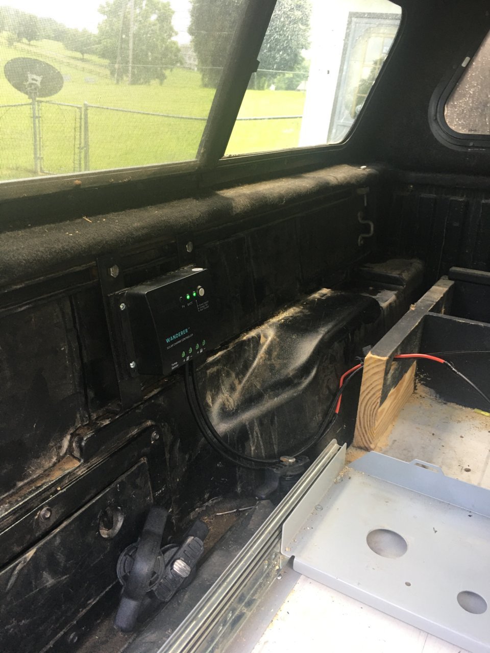

    Also while I was back there I ran my cables from my Solar charger to my battery, this way whenever my tent gets here Ill just be able to mount the solar panel and be good to go. I will also be cleaning up the lines leading to the controller before I reassemble my drawers.
    I've been fighting thunderstorms all week so my time to get out and actually work on the truck is limited and I have to move by the 26th so Ive been pretty spread thin
    Upcoming plans for the truck

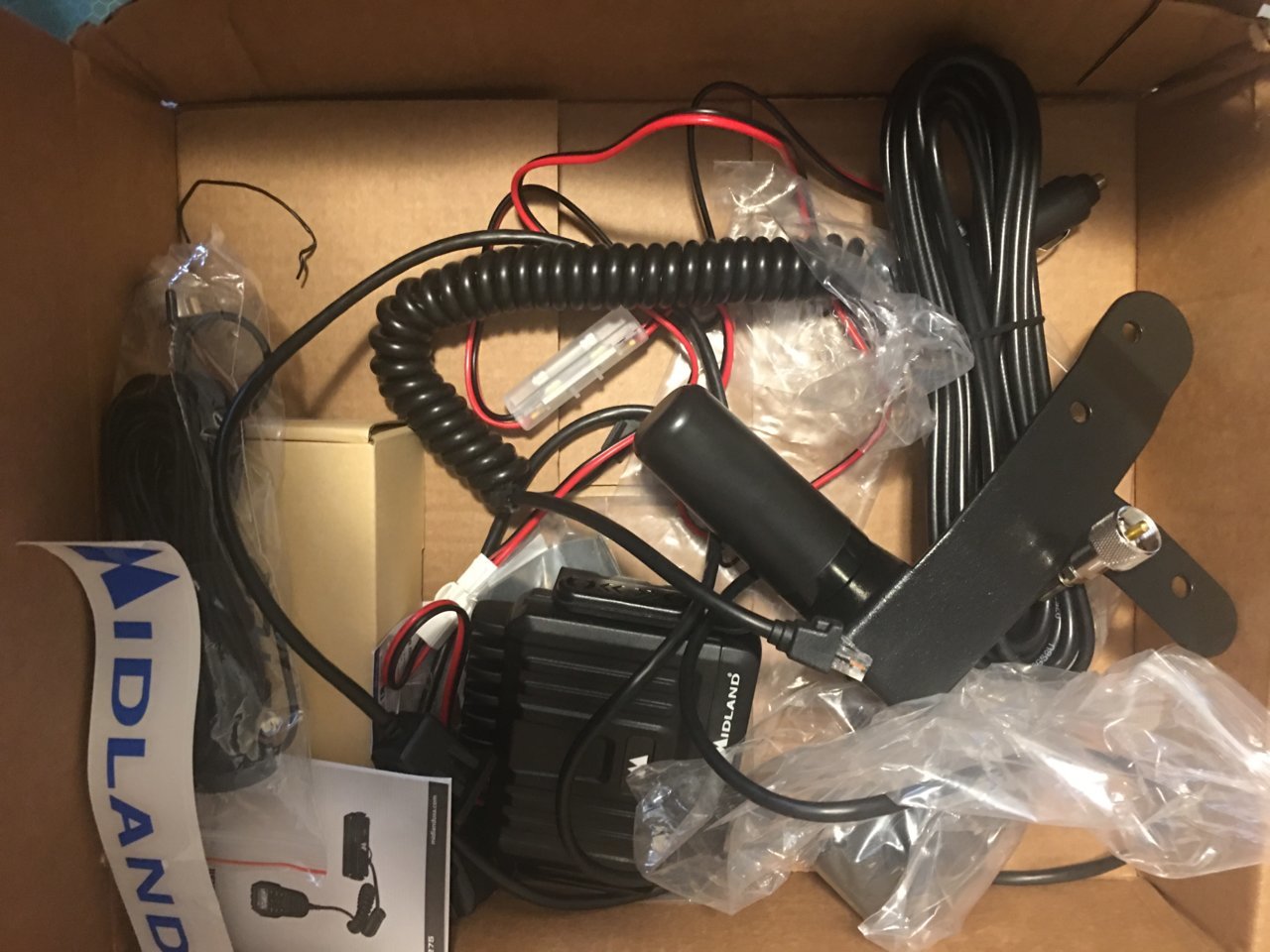

    Before July 4th (planned trip to Cape Lookout Nc for the weekend)- Install GMRS since its all here
    Side note: I'm stoked I was able to fit the midland ghost antenna onto the BAMF CB antenna mount with no modding needed. This will also help take away from my eyesore of a gap right now.
    Thank you to @m603holden and @fatfurious2 for the help with picking out radio stuff.
    Hopefully, wire my turn signals to my sport mirrors after reading some of the TW threads it doesn't seem like too bad of a Job to knock out in a couple of hours.

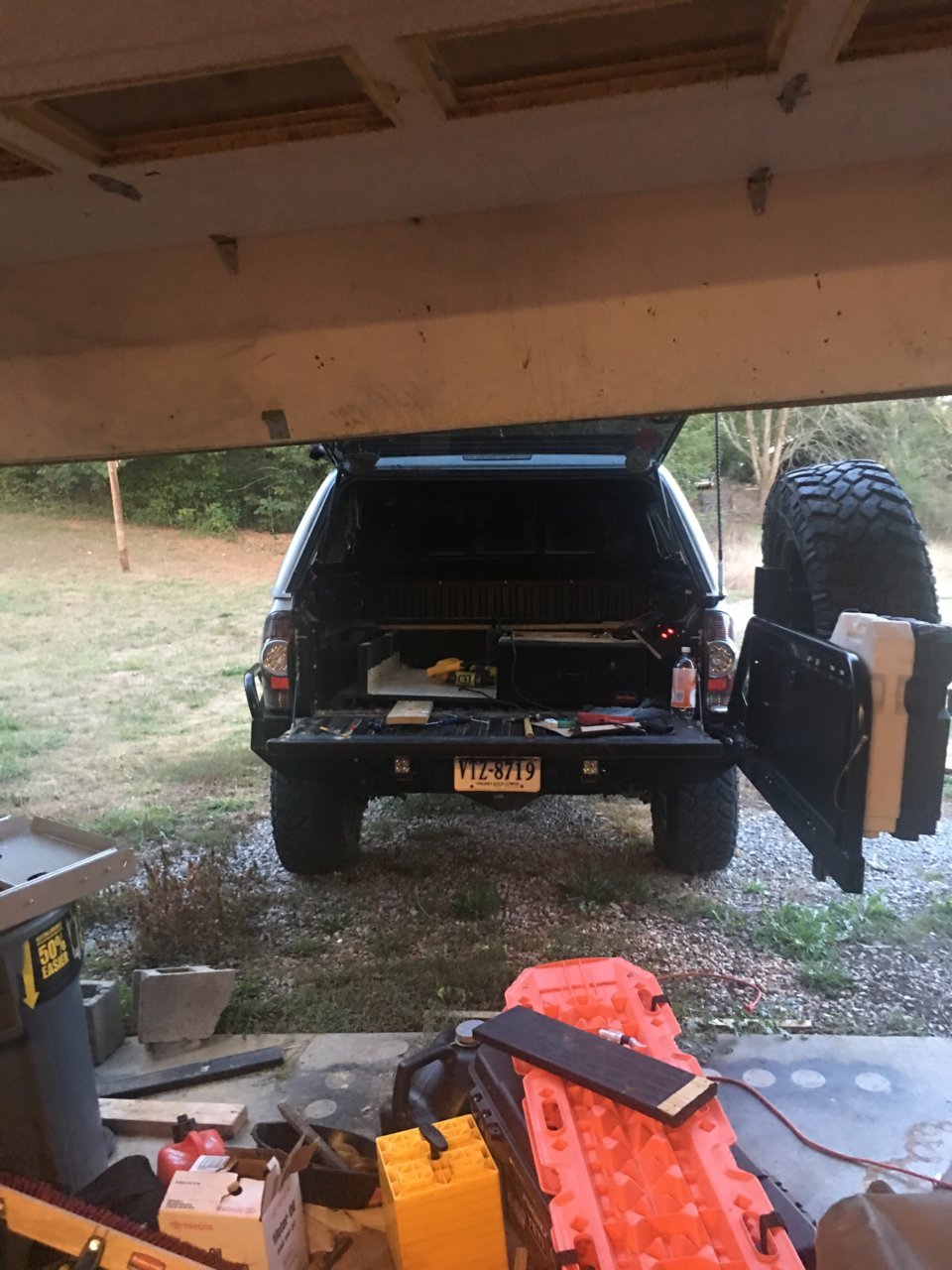

    After July 4th, ill be making a trip out to NC to take off the cap and remove the drawers and fix my bedside gap. My bed shifted after my last hard hit and I'm thinking that moving the bed back into its proper place and maybe a little ratchet strap/come along work everything will line back up nicely. Im going to be going to a buddy that I went to collison school with so hopefully with both of our powers combined we can knock it out.This will also give me time to deep clean and better seal my bed while everything is out.

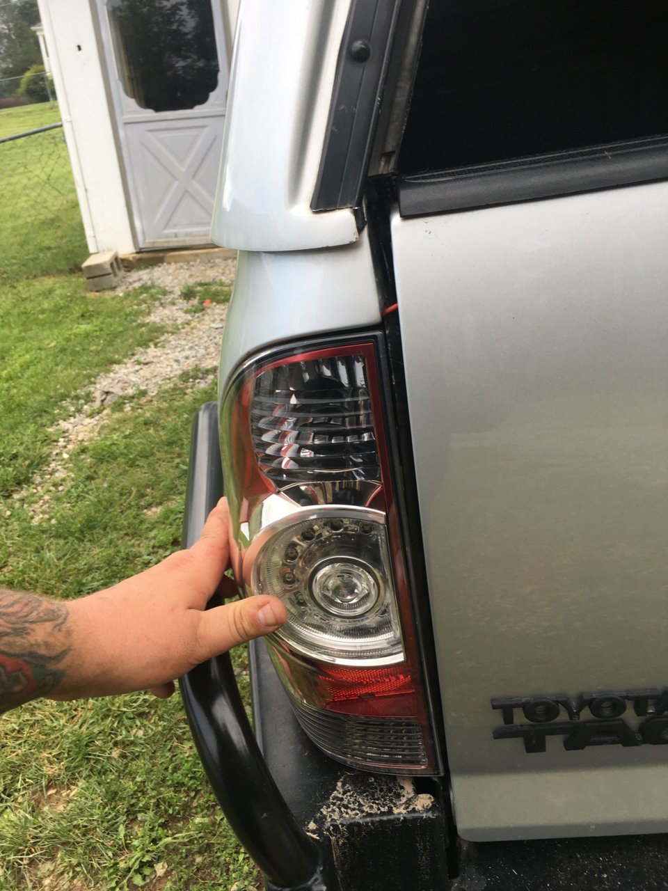

    This is a picture with my new driverside rear light in which shows the panel is okay and it's more of the bedside moving out. (even with my TC bed stiffeners that were installed at the time of the hit)

    Had some time installed the gmrs antenna on the BAMF mount
