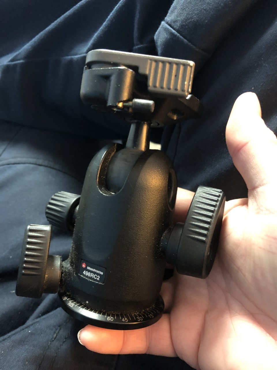

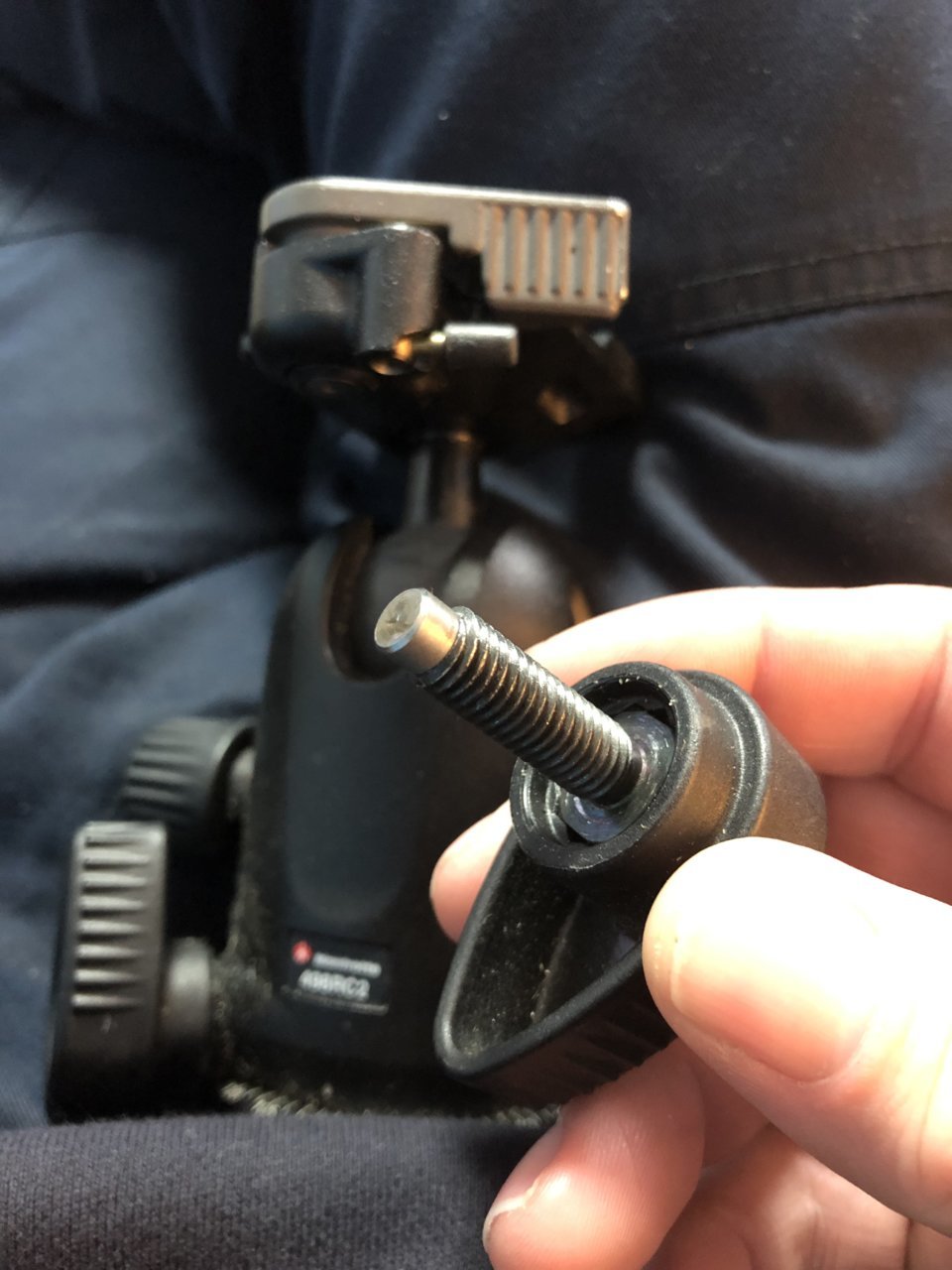

    Was sitting here at work and remembered I had my tripod in the truck. For a good while now the ball head lock on the head wouldn't;t lock anymore. I was having to use the tension knob torqued down to hold the camera in place. Well I decided to fix it or break it. Come to find out if you unscrew the lock knob just a hair too much there is a tiny piece that falls out inside the head and it won't lock anymore. Took the lock knob out and shook it till it fell out. Put it back on the end of the screw and it works like new again. :woot:
    Pics.
    Small piece:
    Back in place:
    Boom! Back in business:

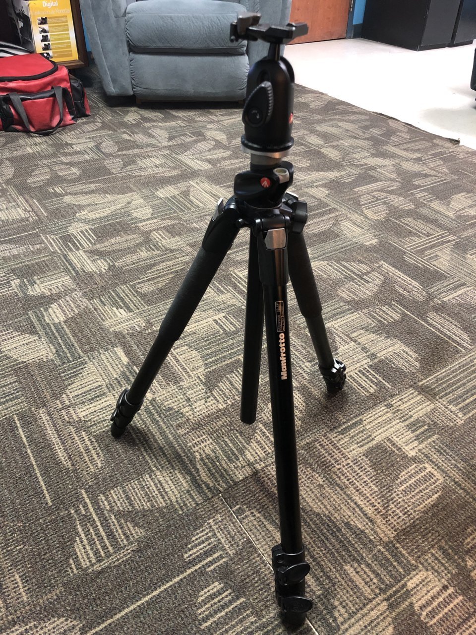

    Agree. Buying good gear means it can usually be fixed.
    Now I need a travel tripod. :bananadead:

    i was going to say, that looks a beast, wouldn't want to pack that around through the bush or up a mountain.. I need something heavier, somewhere between my current origami tripod, and a telescope stand like that

    If I remember right that one holds like 13 lbs with the 055xprob tripod combo. It's stout for sure and exactly what I wanted when I ordered it a few years ago. I also wanted one that would be eye level without extending the center portion. It's a pain when flying because I have to put it in checked baggage and that was a $75 charge last time. If I had not taken the tripod I could have gotten away with all carry on. I really love it though because you can drop it pretty much to the ground for low angle shots.
