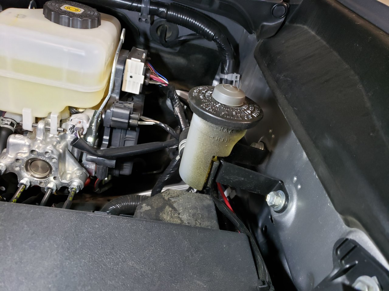

    Here is a pic of what I am talking about. I purposely have not cleaned it so I can make a point at my 15k service. I mentioned it last time but since I had cleaned it, they wouldn't do anything about it even though the outside of the reservoir was damp with clean fluid, just like they couldn't replicate my rear end howl or the stumble/miss at lower RPM because it was raining haha.

    Is the reservoir filled way past the Max level? Looks like it in the photo. That would explain the weeping.

    Last time I checked it was between the Min and Max points but its possible that the degens from upcountry "topped" it off the last time I had it in.
