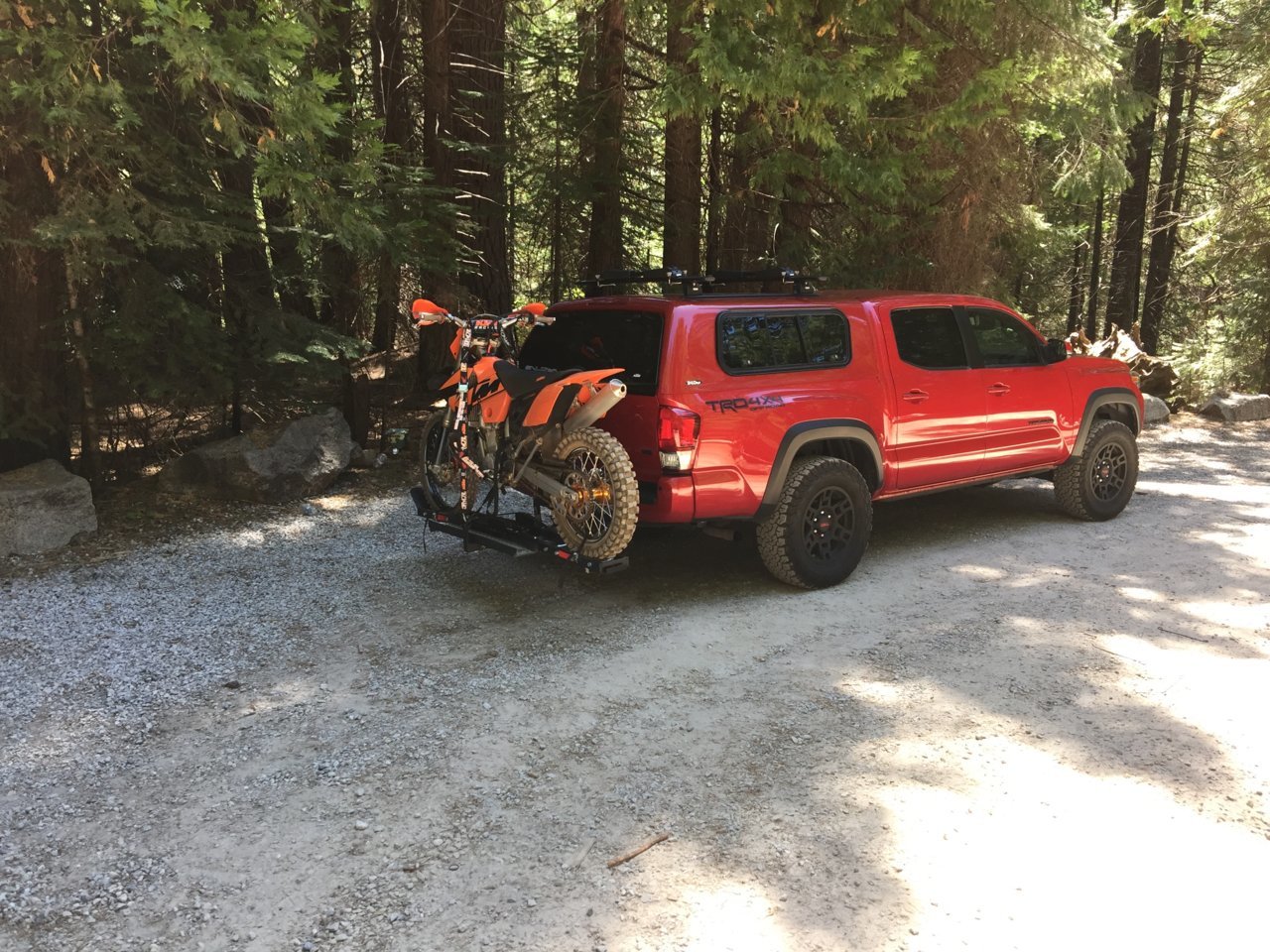

    Thanks for the details! I appreciate it. So they do make some leaf packs that don't lift the truck but are more ridged so the truck won't sag as much under weight? That would be ideal for me. Sumo springs are interesting, though. I've never used them but they look super easy to install which is a huge plus for me.
    I don't want to mess with the ride, I love how the truck drives right now with or without a load.
    I always have a SnugTop shell on the truck, I'd imagine that's around 250 pounds. I occasionally have a hardshell rooftop tent on the cap and when I have that loaded up, I typically have the bed full of camping gear. It doesn't sag as much then as when I'm using my dirt bike hitch carrier. You can visibly see the front end lifting up when it is loaded. Looks and drives weird but again, my bike only weighs around 250 pounds plus the hitch carrier which is about 50-70 pounds.
    With all that said, Sumo is the cheaper and the least invasive way to get rid of the sag it sounds like. I attached a picture but it doesn't do the sag justice. I'll take another picture next time I load up my bike on the hitch carrier versus the trailer.

    It's the cantilevering of the hitch that makes the relatively light bike tilt the truck. You might like Sumo's, they're certainly simple. Air bags can be filled with minimal air and have no effect at all on ride or filled as needed to level the truck.
