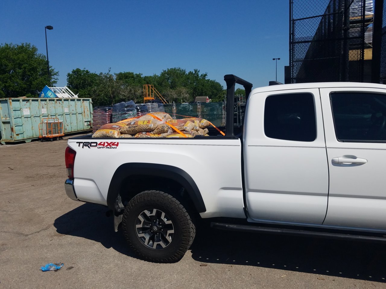

    I definitely prefer airbags myself.
    I would never suggest you put ~2.3k in the bed (as this greatly exceeds the rated capability of the truck) but if you did it might look something like this (with airbags).
