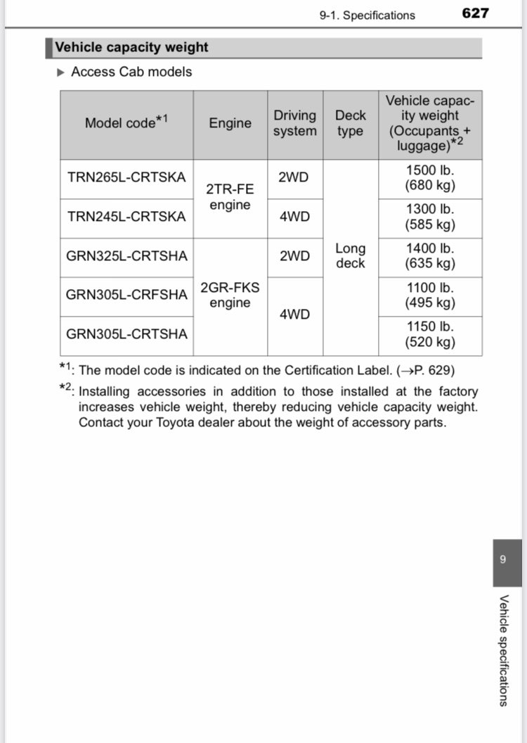

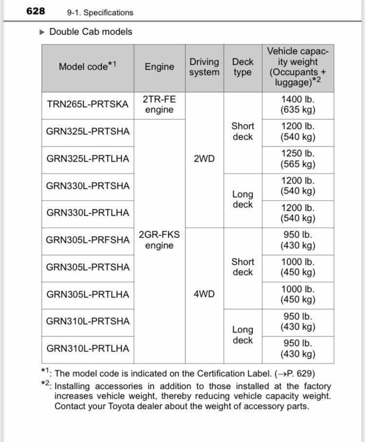

    For whatever reasons, those listed capacities are higher than what you’ll find on your door jamb sticker. I believe the figures you have are empty gas tank but not sure.
    Check your door jamb sticker and deduct any amount listed on the yellow sticker for weight of anything added by the dealer.
    These pages from my 2019 manual however do exactly match the load capacity door jamb sticker for my model truck:

    No, the same misleading load capacity is listed in this 2019 “product information” document, lists my SR 4cyl Access cab 2WD at 1620 (same as in your 2016 doc), actual capacity on the door jamb sticker is 1500 lbs which matches the manual pages I posted above. Check your Owners manual and see if it agrees with your door jamb sticker.
