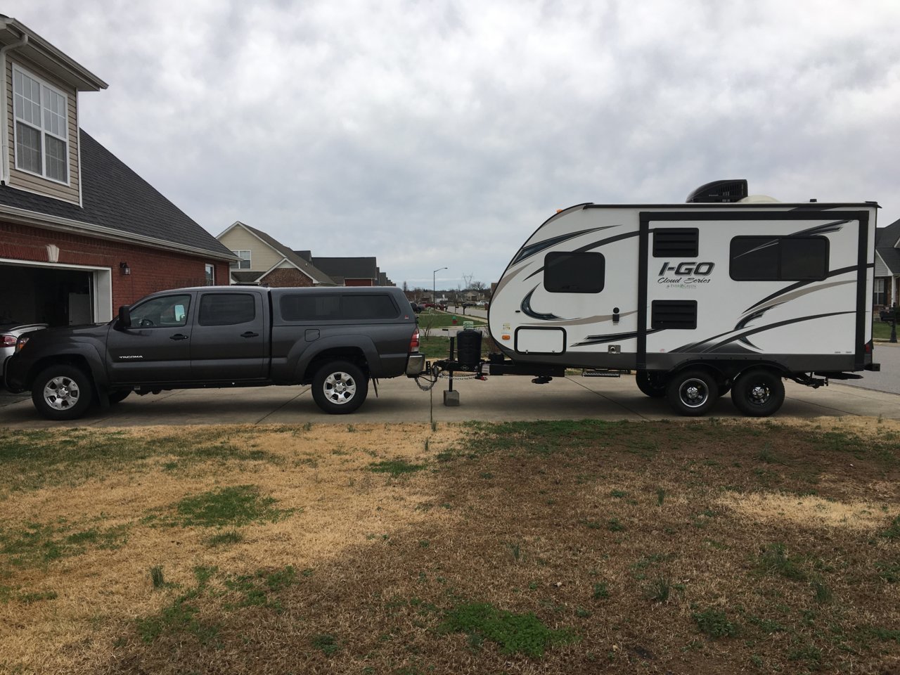

    Welcome aboard:hattip:. Look into the Anderson WHD it has anti sway built in. I have one and really like it:thumbsup:IMG_0043.jpg

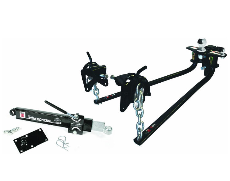

    I went with this 600lbs weight distribution hitch with sway bars, well I was suggested to get this. I can adjust the height on the hitch. It arrived in the mail yesterday and I will install them tomorrow.
    Thanks for all the suggestions! I appreciate it very much.

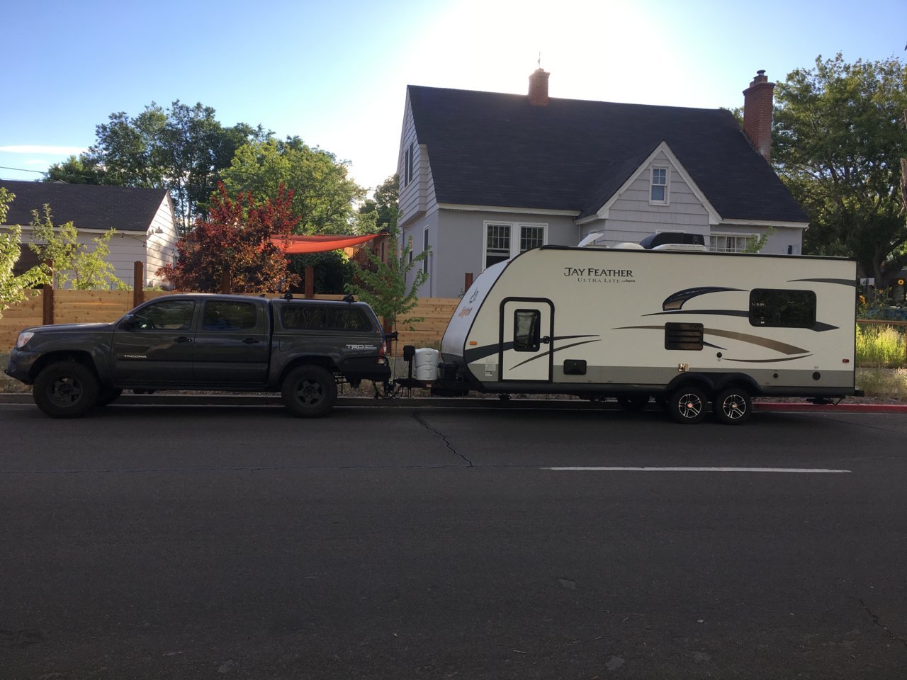

    Here's the trailer hitched up without the WD hitch. The batteries and propane aren't on the trailer and it is unloaded so tongue weight is probably close to 100lbs lighter than in the pic above.

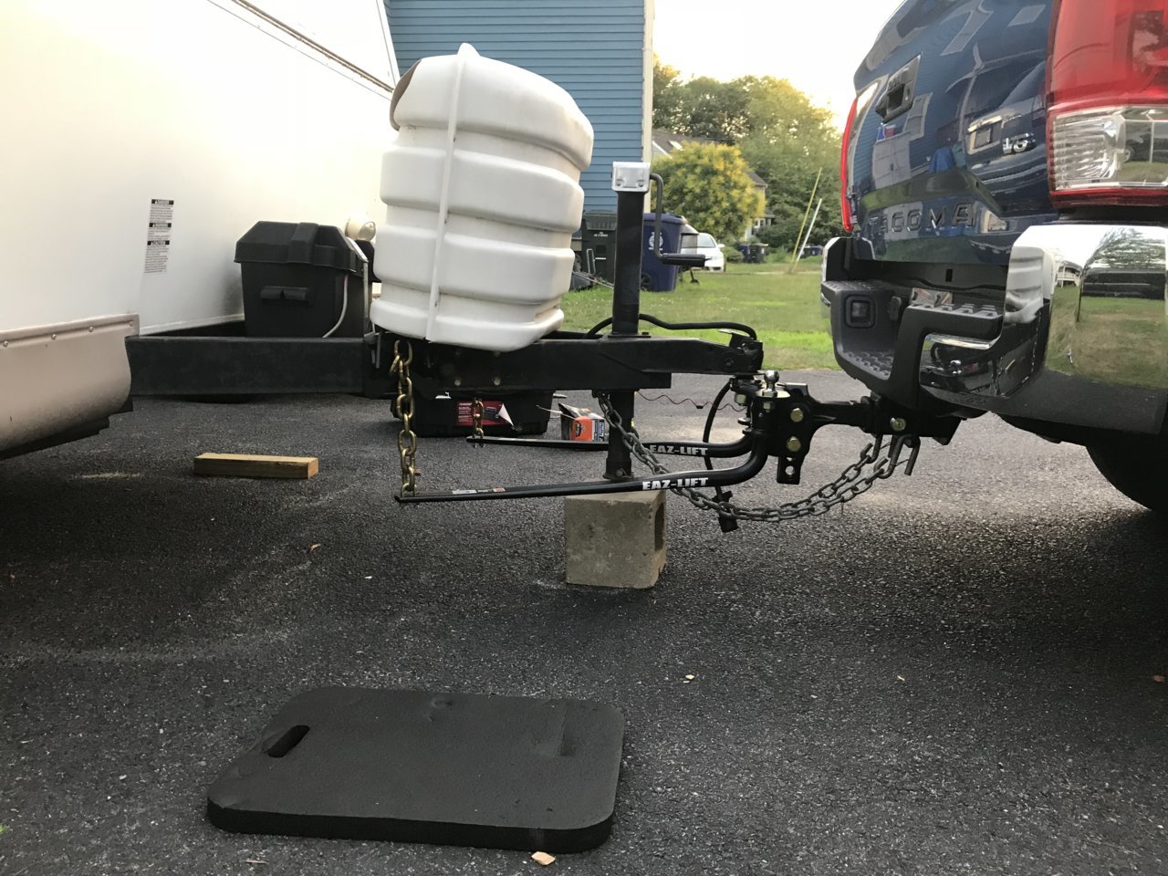

    I got the sway bars on today. But I think I need to rise the hitch up. I’ll snap a better picture tomorrow. The camper isn’t leveled or parallel with the truck. We are taking our first trip up to New Hampshire tomorrow. Pretty stoked about it. Can’t wait to feel the difference with the bars. ✌
