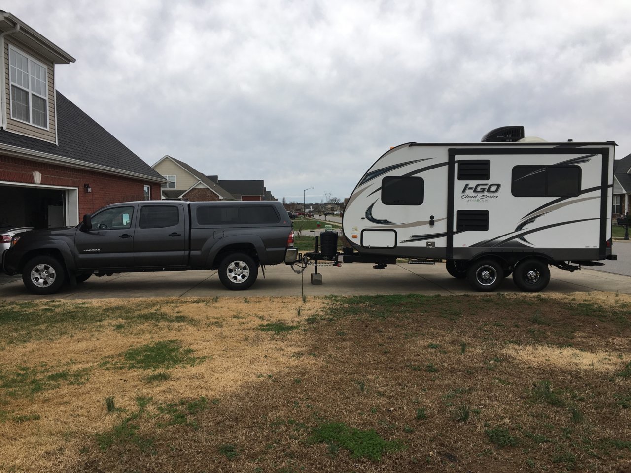

    IMG_0043.jpg My camper is 3400 dry. 19ft long. I use an Anderson WDH. It makes the ride smooth and it tows very well
