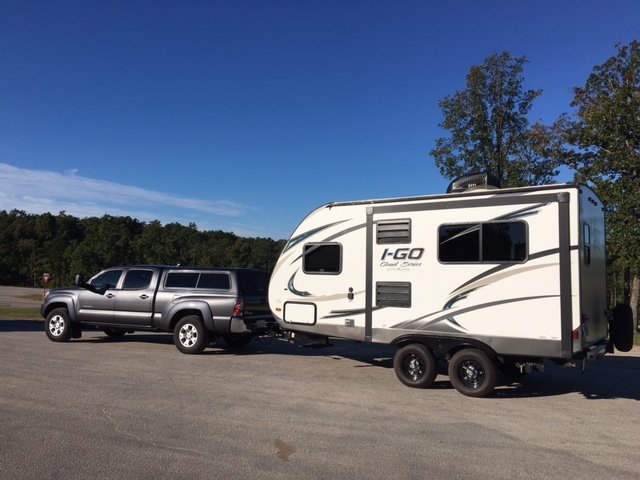

    My set up weighs about 4200lbs ready to camp. I have the Andersen WDH and a P3 brake controller.
