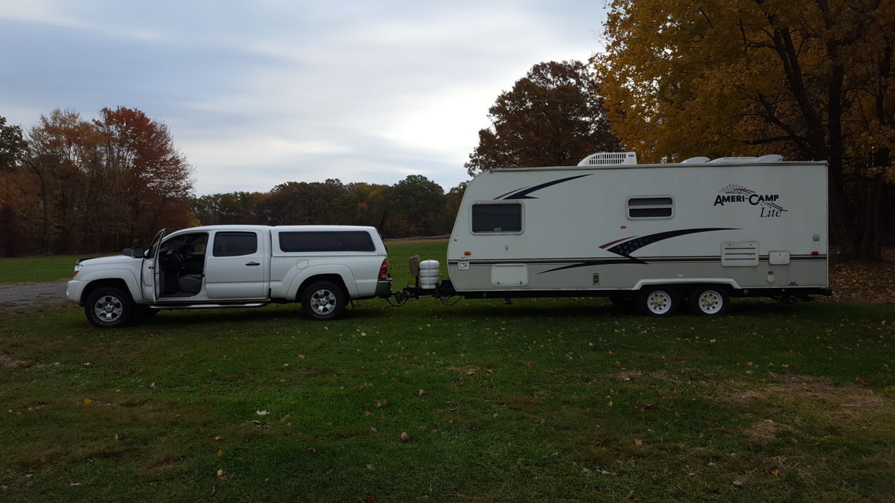

    I had a very similar set up. I'll try to find a pic when I'm done typing......
    There is no better, safer hitch than the Equal-i-zer. Once its set up correctly its easy on-easy off. Nothing you buy is going to keep the tail from wagging the dog any better. Not cheap....but what is the price you put on safety?
    I wish you were local, I'd sell you mine cheap. I no longer have my camper after using it for about 10-12 years.Truck camper 2.jpg
