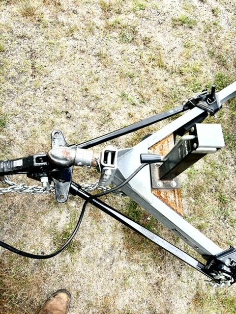

    This is the setup I use on the job. Not towing with a Tacoma per se, but today was pulling 9600lbs of trailer. Works well.

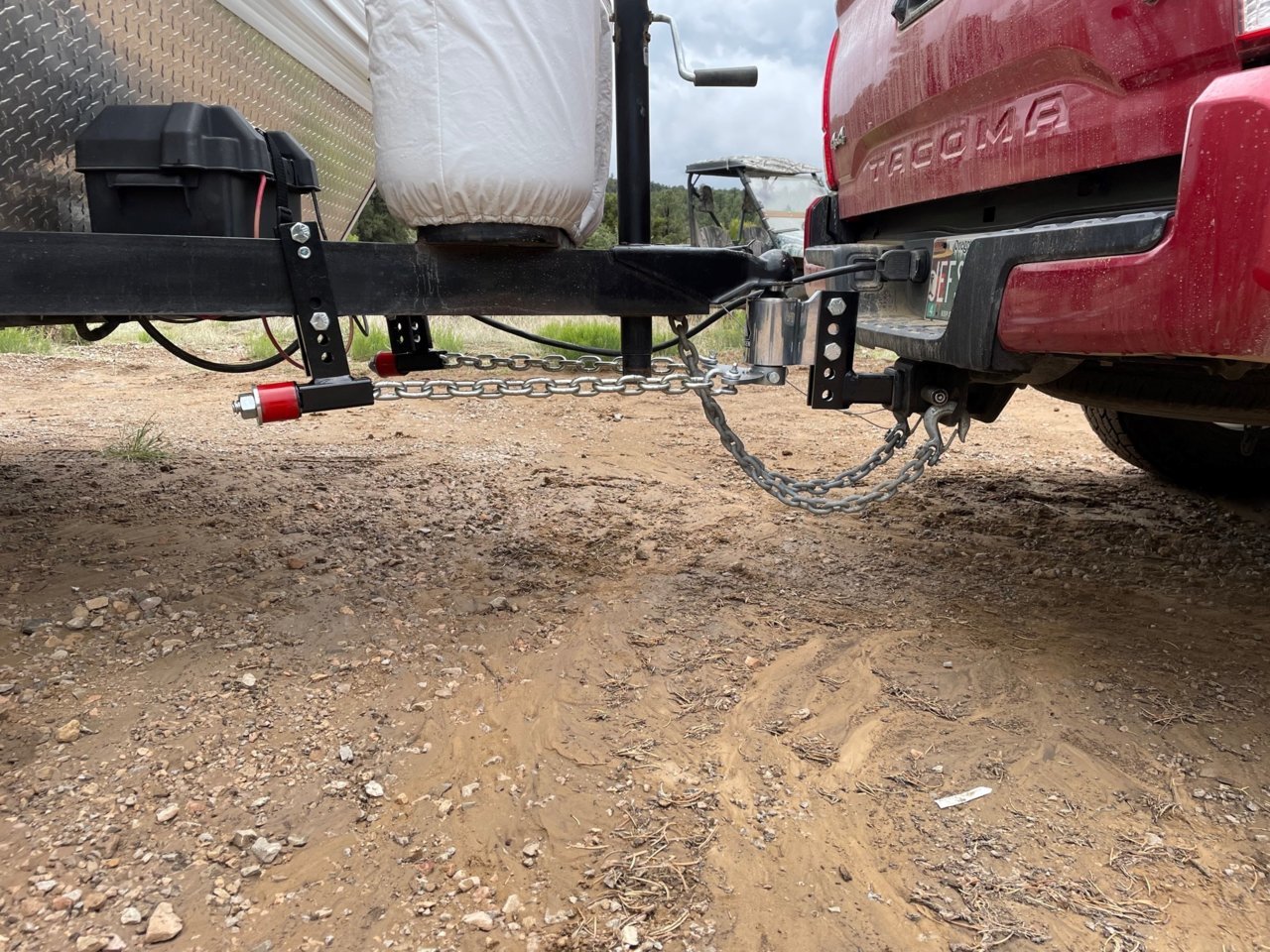

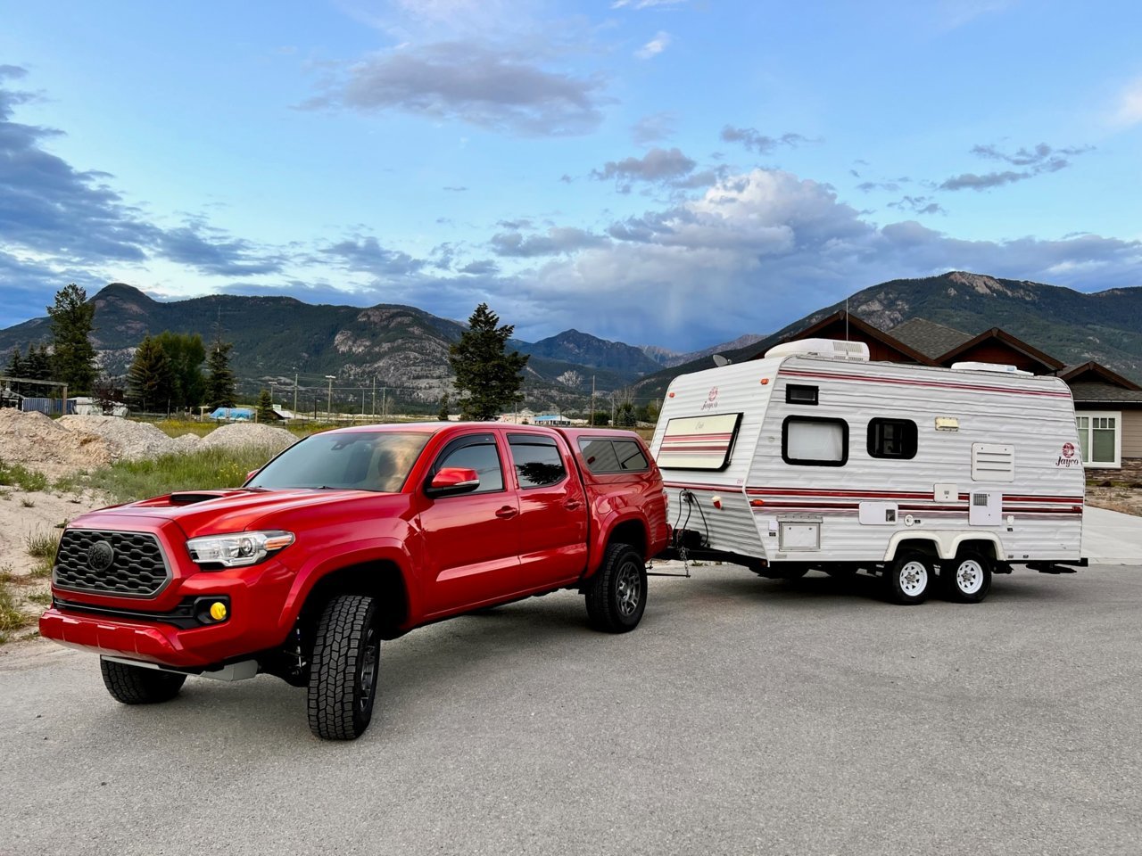

    Yes, I'll unhook the bars to back it into the site, but otherwise it would never be able to go down the road without it.
    I also added a friction sway bar, highly recommended.

    Basically this;
    https://www.curtmfg.com/part/17062
    Ours came with the trailer when we bought it used.
    In that pic I've got it one chainlink too tight, you can see the bars are not horizontal and I was losing traction on the rear tires.

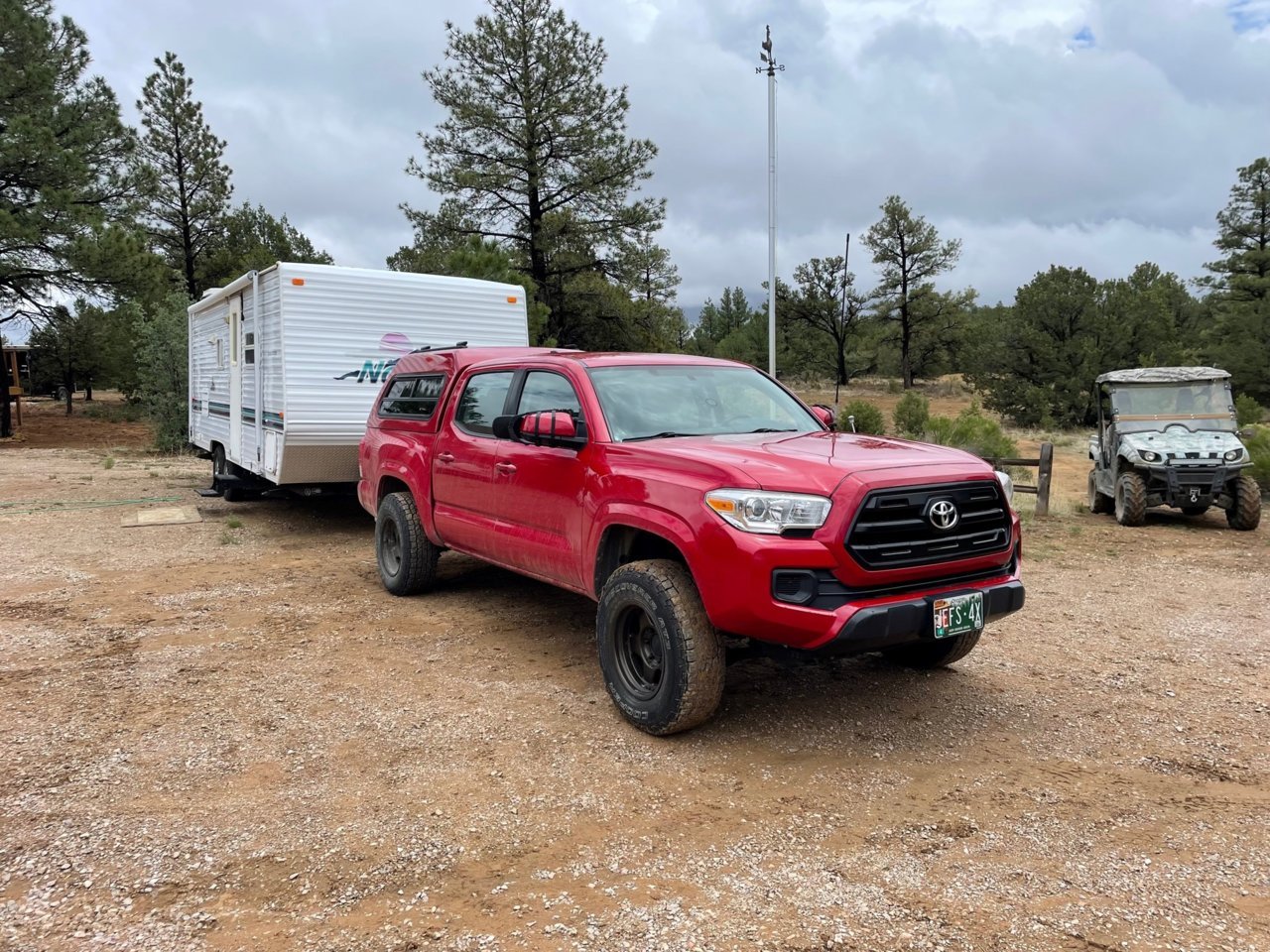

    Greetings,
    Just returned from a 3400+ mile trip to Jasper, Banff, Glacier & Grand Teton. Pulled a 26' trailer with a dry weight of 4400 lbs. Throw in clothing, 3 kids, a dog and another adult for our mass.
    Did it using using an Anderson WDH. Worked great. https://andersenhitches.com/product/weight-distribution-hitch/
    No need to unhook bars before backing. No grease all over the place. Worked great.

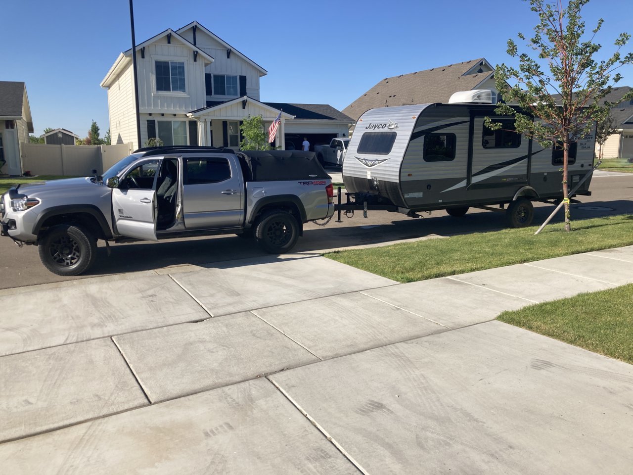

    I use a dual sway setup with my 20’ Jayco and it has been a blessing driving freeways, especially with high winds. I recommend it as well as airbags with Daystar cradles. Works great on or offroad
