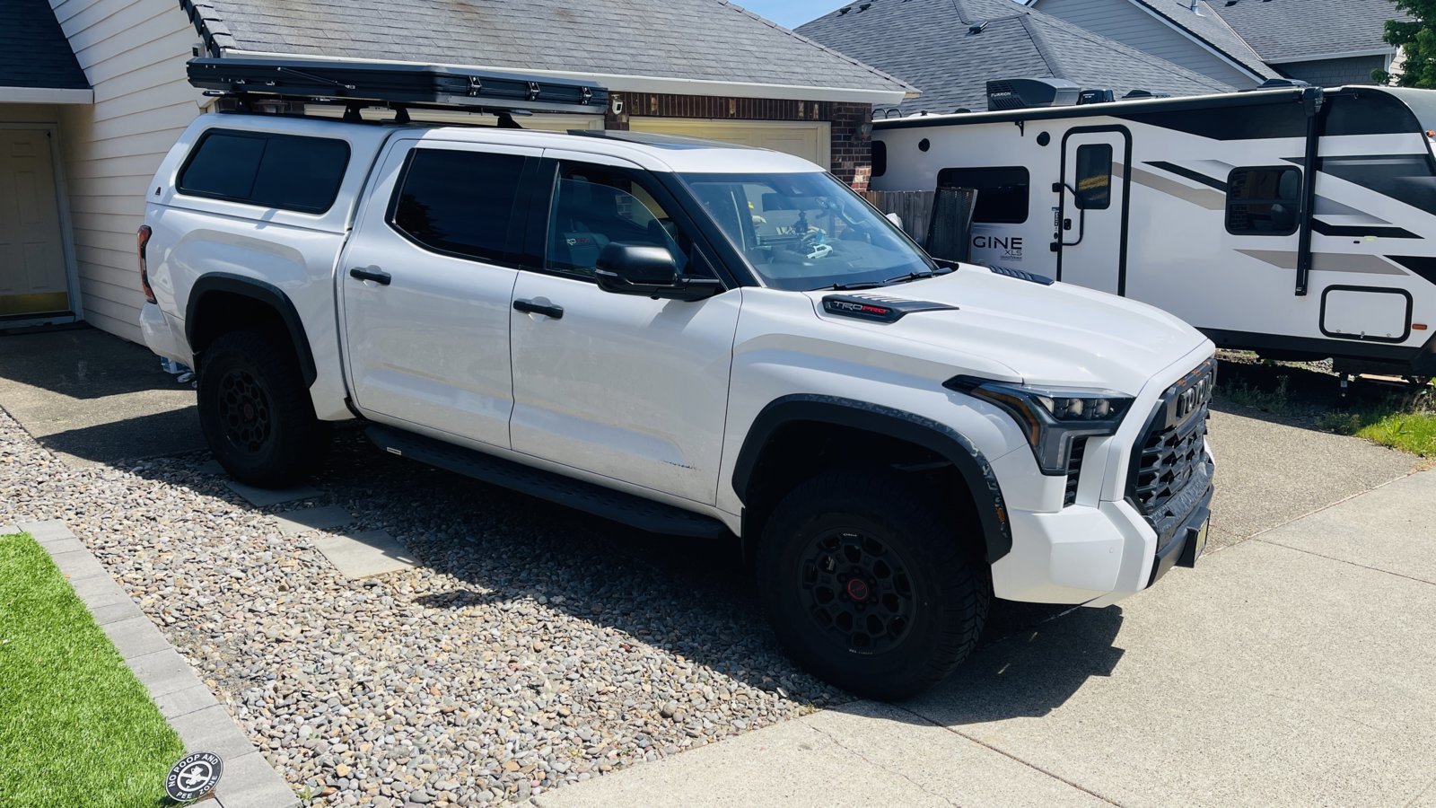

    I don't have a Tacoma but I wanted a RTT on my topper and came across this conversation. Based on the information I read here, I think my setup should be fine... here's my setup. It'll only be one of my kids (140lbs) and my wife (160lbs) up there.
    RTT is TopBee on Rhino Racks (2 cross bars) on a Leer Topper 100XR.
