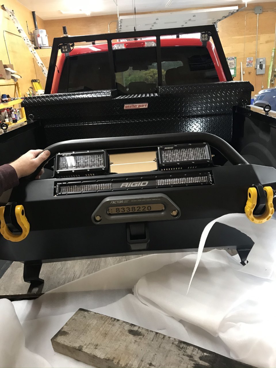

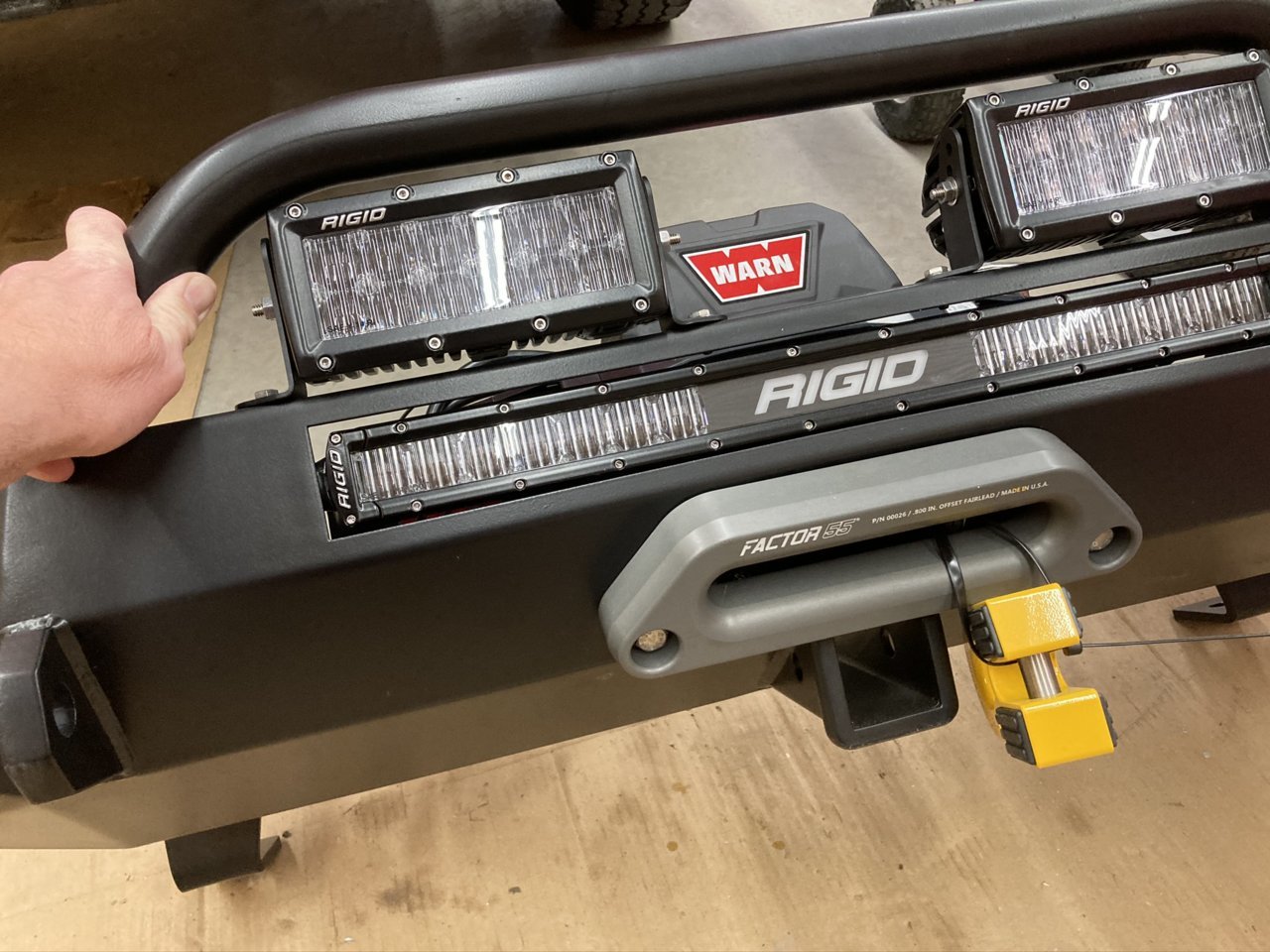

    Greetings!
    I’ve got a Slimline Bumper and Warn winch ready to install on my 2019 Off-road. The weight of it is hefty to say the least! I can barely pick it up and carry it. There have been no upgrades to the suspension, the tires were upgraded to LTs. Also a TRD skid plate was added.
    My question is how will that extra weight affect the handling of the truck? Any thoughts or suggestions you’d like to share? TIA
