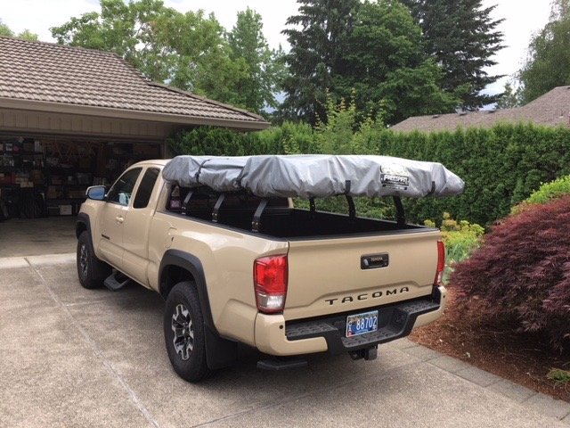

    Welcome to the forum. My RTT weighs 120 lbs, I’m just over 300 and the wife is somewhere around 130, that approximately 550 lbs. I use three Front Runner rails.
