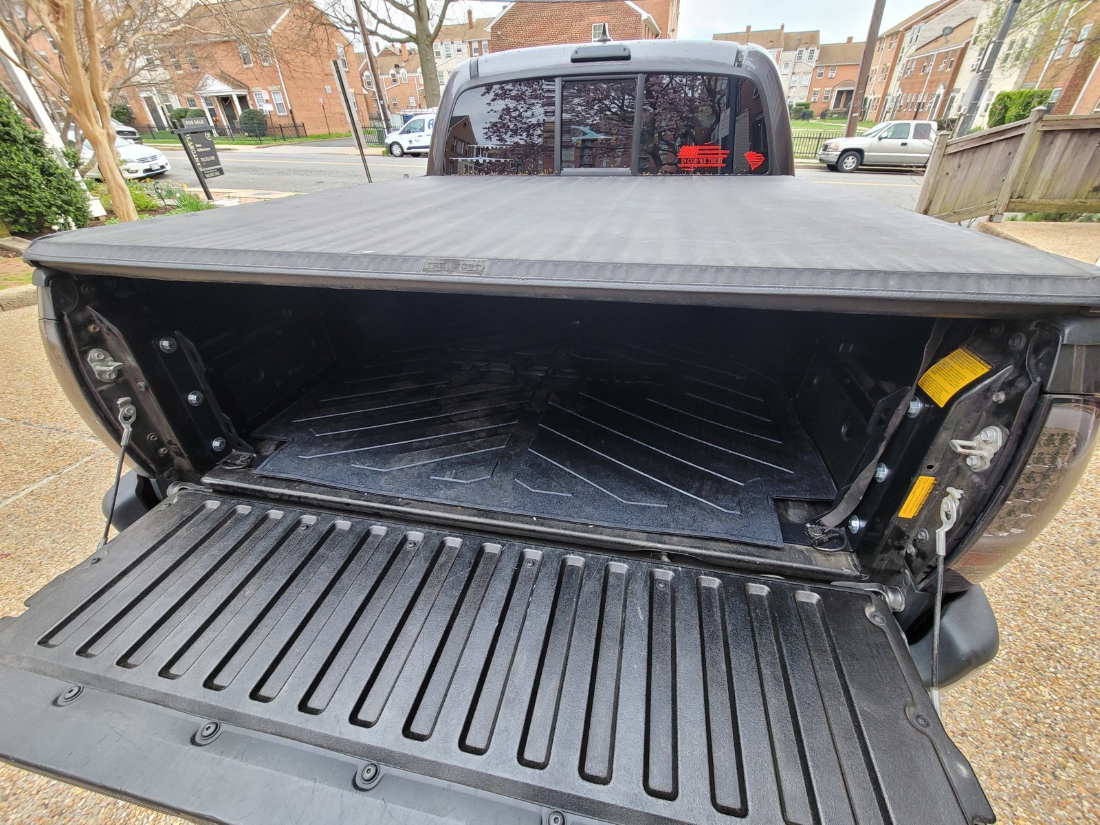

    May want to upgrade the bump stops. ‘These are Timbren.
