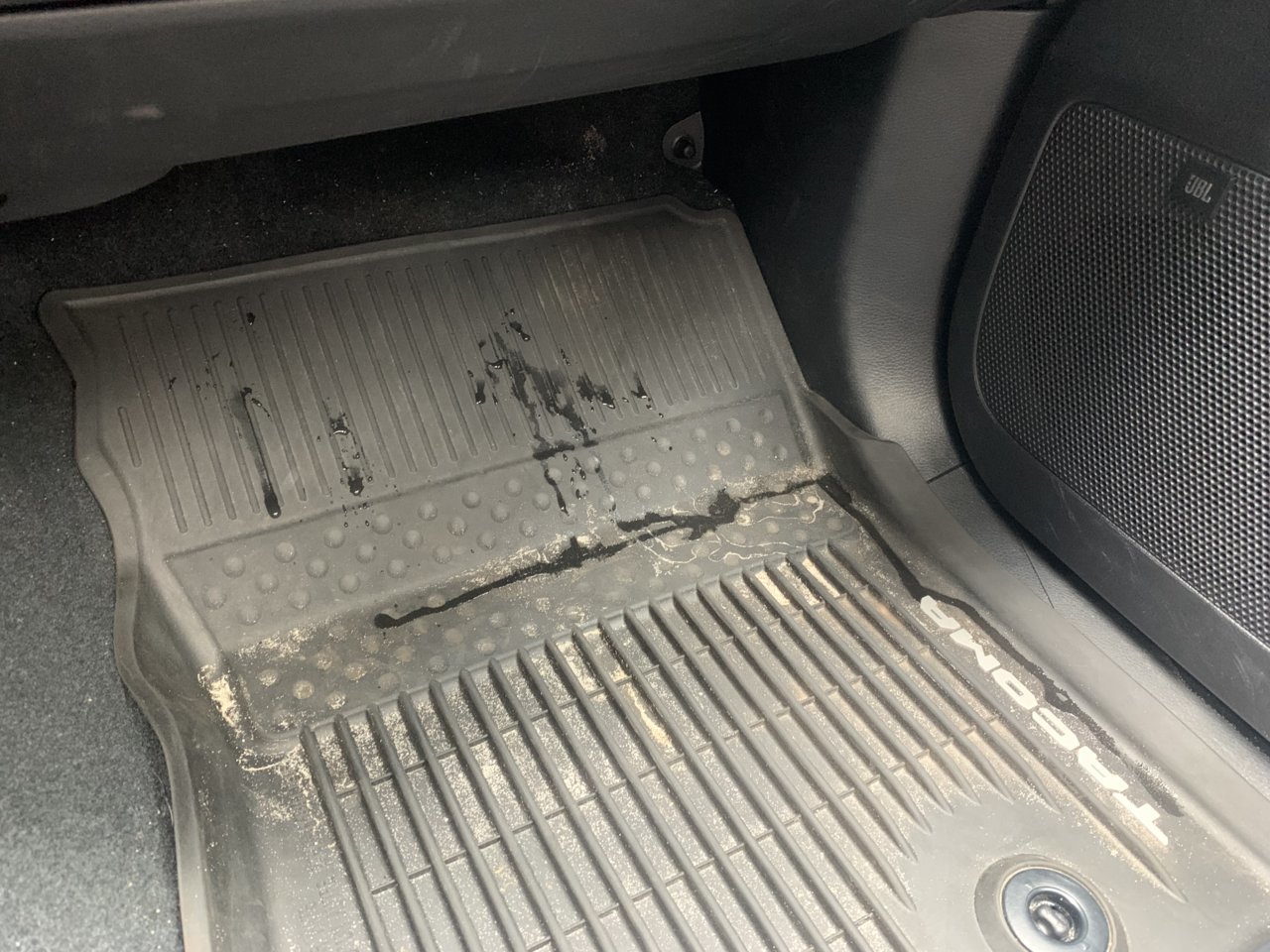

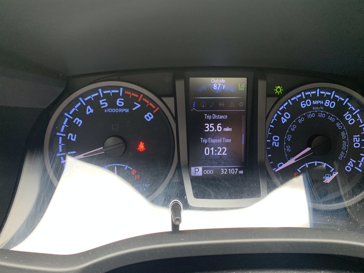

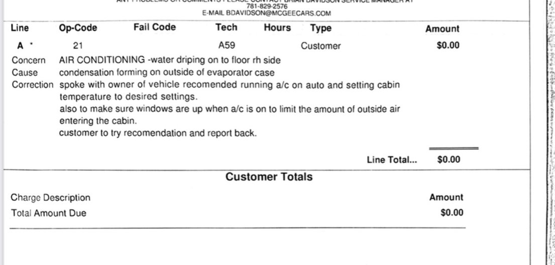

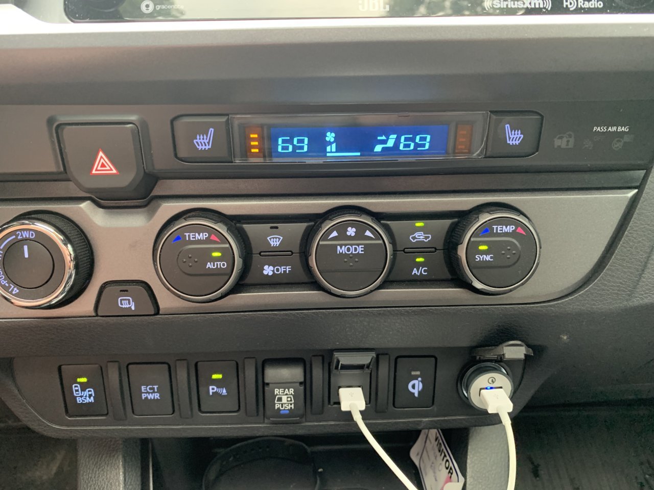

    I got the truck back last Wednesday and haven’t had time to post.
    The dealer service “director” called me to talk through the issue and asked me to try something for the next few days. Bottom line, they couldn’t find anything “wrong” but were able to duplicate the condensation by leaving it idling for hours. Didn’t even move the truck from where I parked it, even though I explained it happens much worse while driving and told me it wasn’t that bad.
    The service director asked me to only use the ac in auto mode and adjust the temp for comfort, not the fan speed manually and to only use recirculate mode and always keep windows closed. Said this will eliminate the problem. Never heard of this in any other vehicle, cannot find any mention on OM and completely disappointed that was the best solution.
    Fast forward, I have tried his recommendation and haven’t noticed any significant improvement, see picture of drips using his settings. I have called the service department the last 5 days they were open and cannot even leave him a vm because his mailbox is full, asked secretary and other service advisor to leave a paper note on his desk. About to try another dealer but really don’t want to start from scratch diagnosing. Open to any suggestions for dealers between Plymouth and Boston
    Any ideas on what else to look at? I tried to find the other post that started the other day with a similar issue but wasn’t having any luck. My biggest concern is electronics in the dash getting wet and being expensive down the road.
    Thanks for the help and ideas and sorry for long post.

    I have done a water test with the hose, sprinkler and car wash and no water has come into the truck. Only time there is water is when ac is running. I was hoping for an easy answer with the windshield but no luck.
    I don’t have a GoPro but not sure I could get it close enough to see where it is coming from. My next thought was to remove the glovebox but looks like I have to play with the airbag to do so…maybe someone knows better.

    Update from dealer today:
    Dealer agrees the refrigerant lines are what is sweating behind the dash. They have had the truck in the shop all day but cannot “find something to insulate the lines with”. When I asked what was there for insulation from the factory he said no insulation is included from the factory. I am curious what the paperwork looks like and will be surprised if Toyota pays for some Home Depot pipe insulation to be installed. I imagine they are into the dash pretty deep to access these lines.
    My only experience with ac lines in the cab is on older Internationals and they all had foam pipe wrap to insulate. Does anyone have any experience or pictures of these lines so I can verify what it should have? Maybe it not being insulated is the problem from the factory in the first place. I really do not want to end up with these lines wrapped in shop rags so the drip doesn’t make it to the floor anymore. Any help is appreciated.
