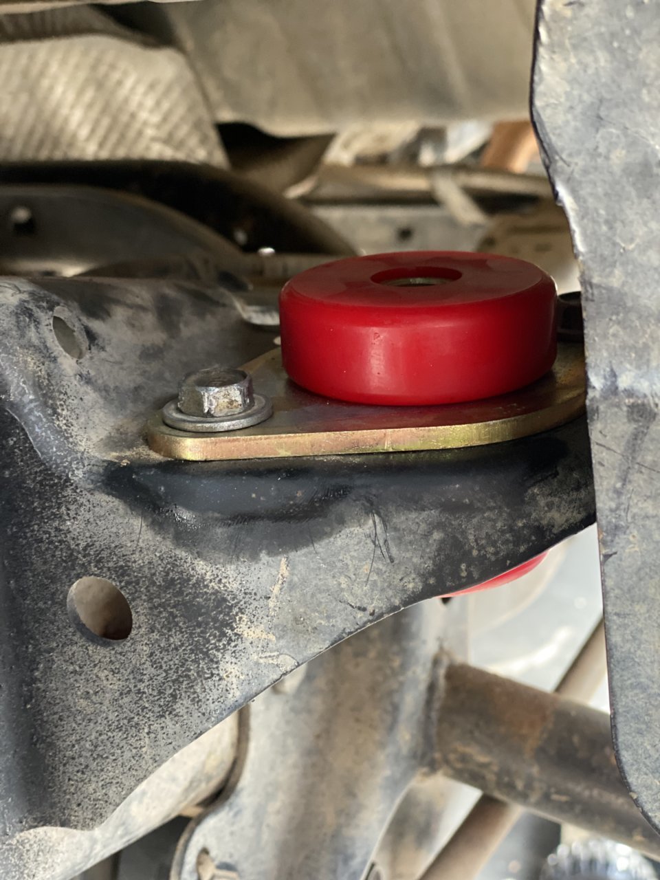

    So i just got under and looked.
    I’m guessing it’s the front cab mounts. You can tell right where the slider comes out under the cab that it has be t a bit from the cab hitting the slider.
    it must be a bad cab mount.
    I know the sliders could flex while wheeling but i don’t think that’s the case which leads me to believe its the cab mounts.
    now, do they just need to be tightened? Or do i completly replace all of them?

    If it's the cab mount bushings, tightening them won't fix it. Energy Suspension makes a poly body mount bushing kit, p/n #8.4109, that should take care of it.

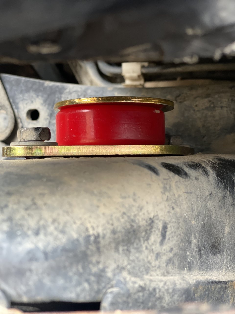

    Well it’s been awhile, but ordered the new mounts, bought a Proeagle and got everything installed. I couldn’t be happier that the annoying noise is gone!
