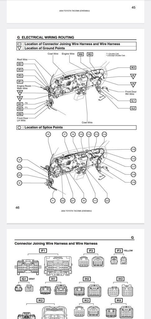

    Ground point IE AND IG are in both front kick panels.

    I dont have keyless entry on mine but I want to say only the turn signals and combo meter signals are supposed to blink. You must have something back feeding from the left rear into that ground circuit. All the exterior lighting uses those 2 grounds.

    Connector BN7 is also shared by the rear lights and its located under the drivers seat do you have a wet carpet from a water leak or spilled something?

    Okay guys - IT’S FIXED!!! So after chasing wires and checking continuity all over, and finding nothing, I went back to the forums. I reviewed the wiring diagrams again that had been posted in this thread, and other TW threads.
    Someone else pointed out that the DRIVER (LH) taillight was grounded to the PASSENGER (RH), and then the passenger side was grounded through the wiring harness itself (which is on the opposite side of the truck). WHY Toyota would wire things this way is beyond me.
    SO - I pulled the perfectly working passenger side taillight to inspect. Lo and behold, one of the ground wires on the passenger side harness had been rubbing against the body of the bed and was shorting out. A little electrical tape later - ALL FIXED! Crazy crazy crazy crazy little thing caused so much havoc. Thank you all for helping, hopefully this helps someone else in the future.
