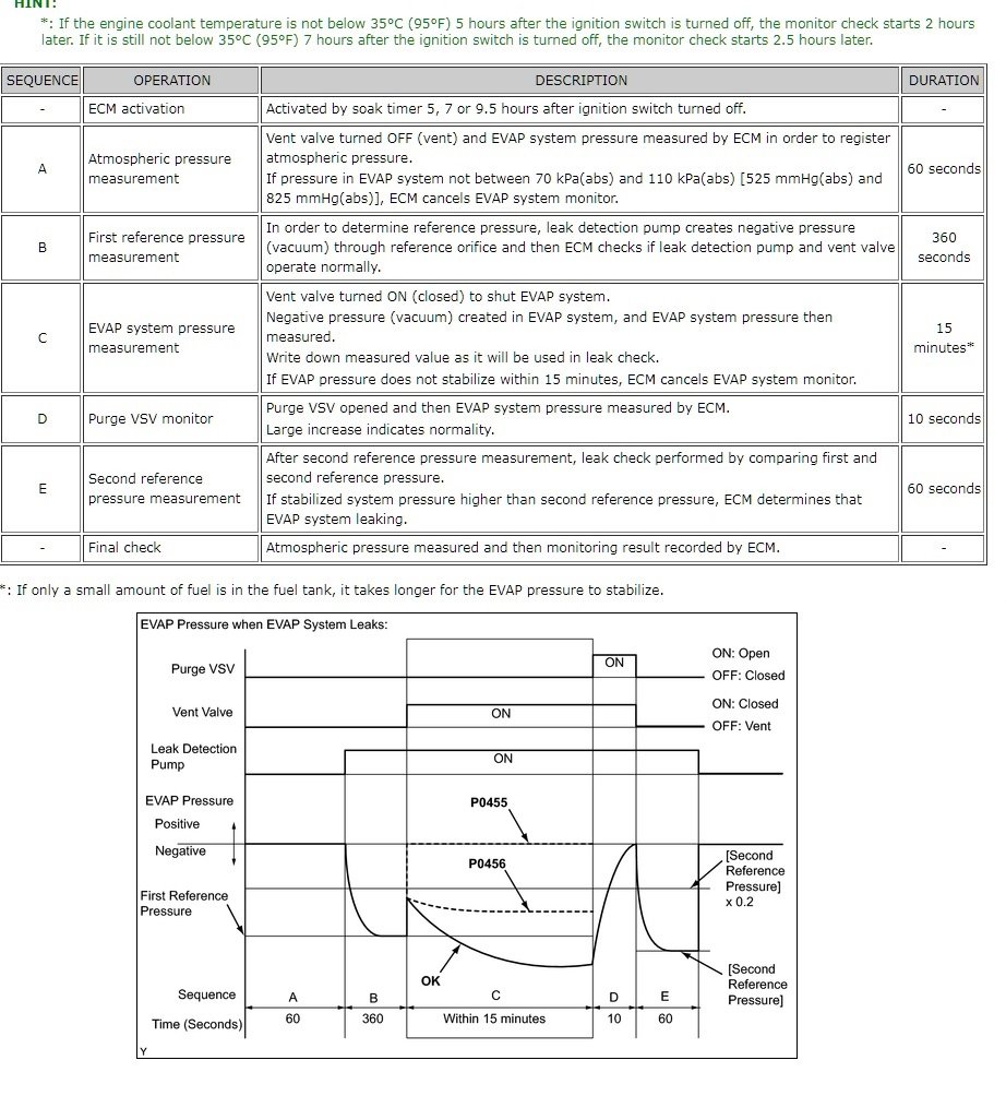

    1. Key-off monitor This monitor checks for EVAP (evaporative emission) system leaks and canister pump module malfunctions.
    The monitor starts 5 hours* after the ignition switch is turned off. At least 5 hours are required for the fuel to cool down to stabilize the EVAP pressure, thus making the EVAP system monitor more accurate.
    The leak detection pump creates negative pressure (vacuum) in the EVAP system and the pressure is measured.
    Finally, the ECM monitors for leaks from the EVAP system, and malfunctions in both the canister pump module and purge VSV based on the EVAP pressure.
    HINT: *: If the engine coolant temperature is not below 35°C (95°F) 5 hours after the ignition switch is turned off, the monitor check starts 2 hours later. If it is still not below 35°C (95°F) 7 hours after the ignition switch is turned off, the monitor check starts 2.5 hours later.

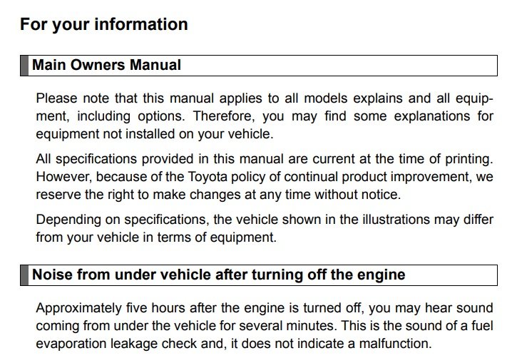

    Yea alot of people are alarmed by it the first time they hear it, Toyota has been using this design EVAP system on many of their vehicles since the mid 2000s.
    It's actually in the owners manual as well.
