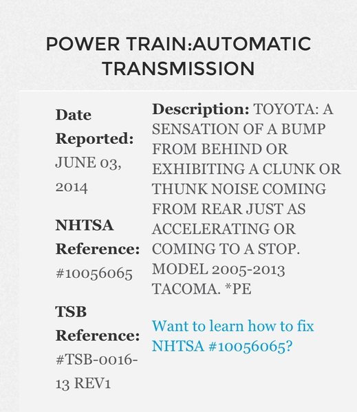

    Don't know if it helps, but I recall reading a TSB about similar symptoms:

    115
    Marietta, GA
    05 DCLB 4x4
    Sounds like its the TSB that was posted above. I read about it a while back, seems to be pretty common. My truck always does the same thing... annoys the shit out of me.
