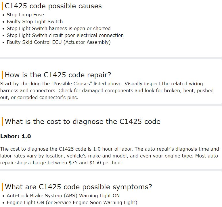

    Is it throwing any codes at you?
    If it does it might be C1425 which is a "Open In Stop Light Switch Circuit"
