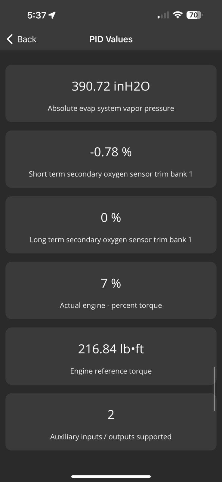

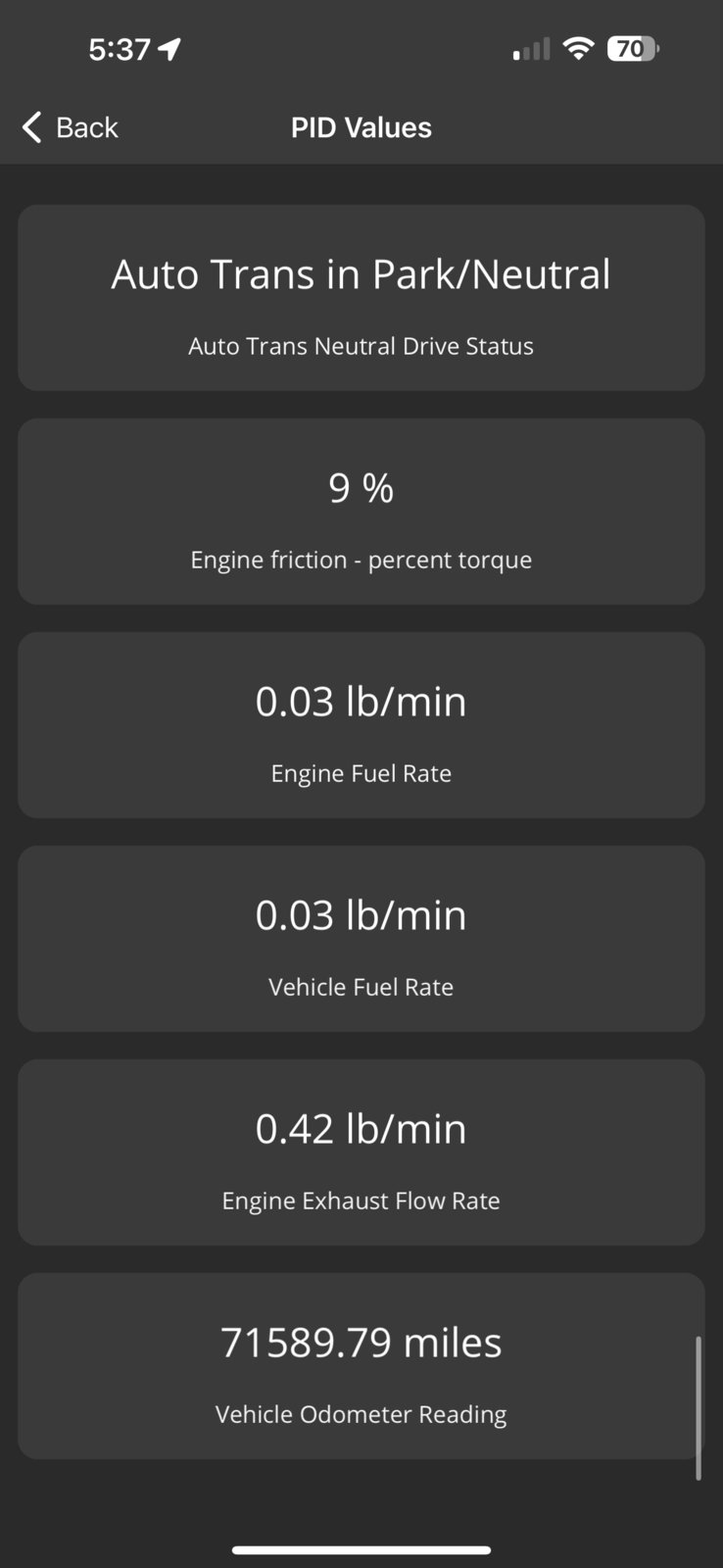

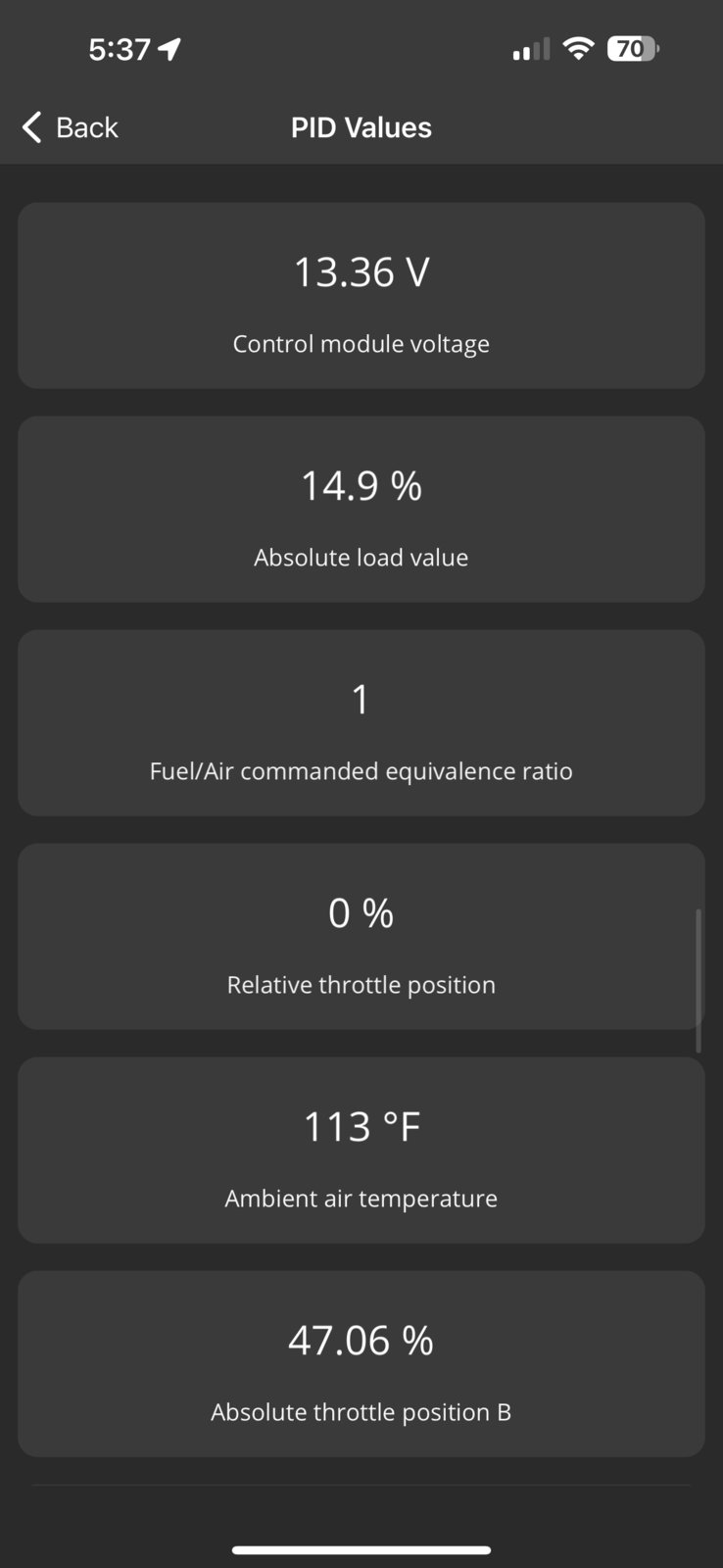

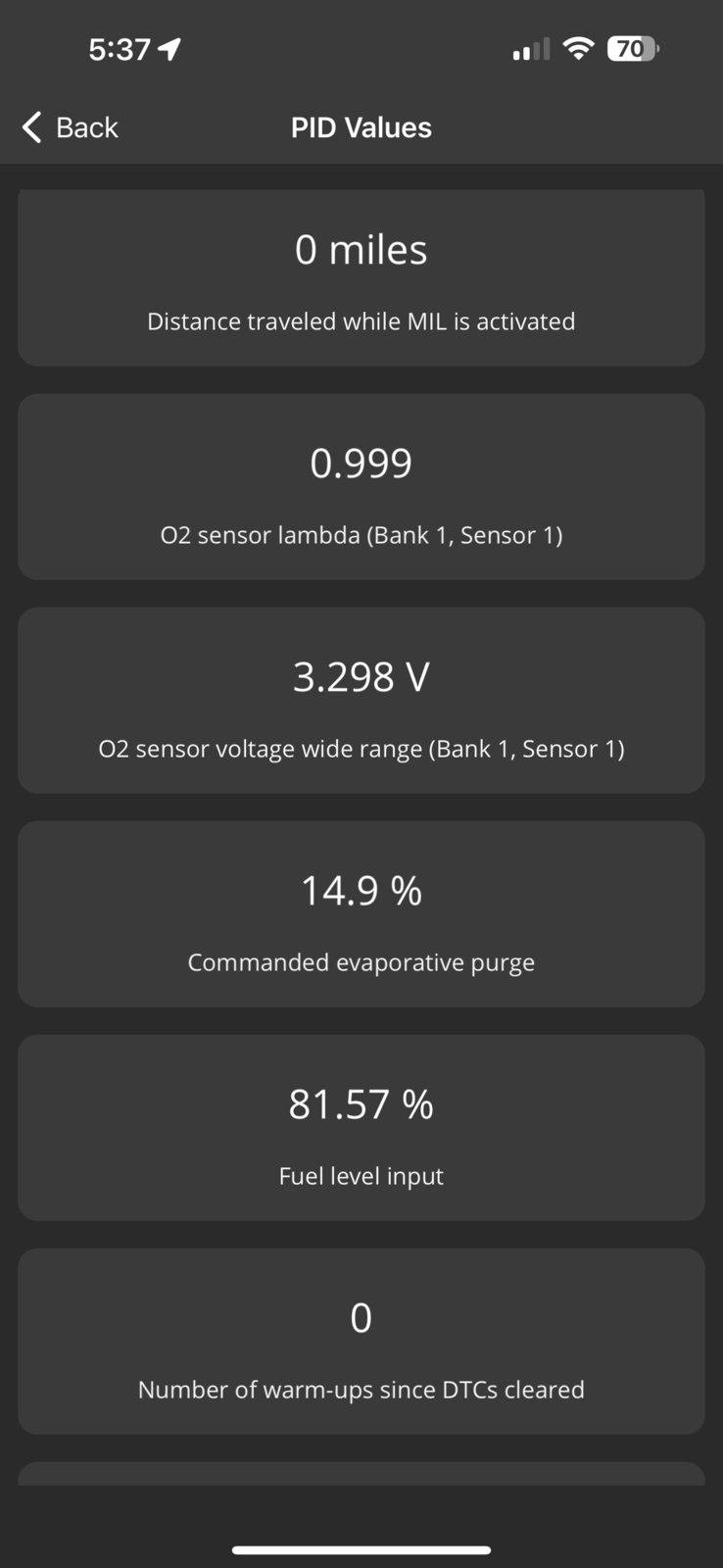

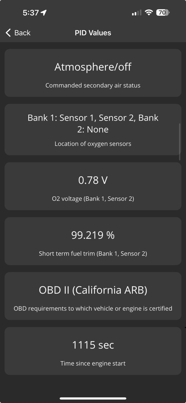

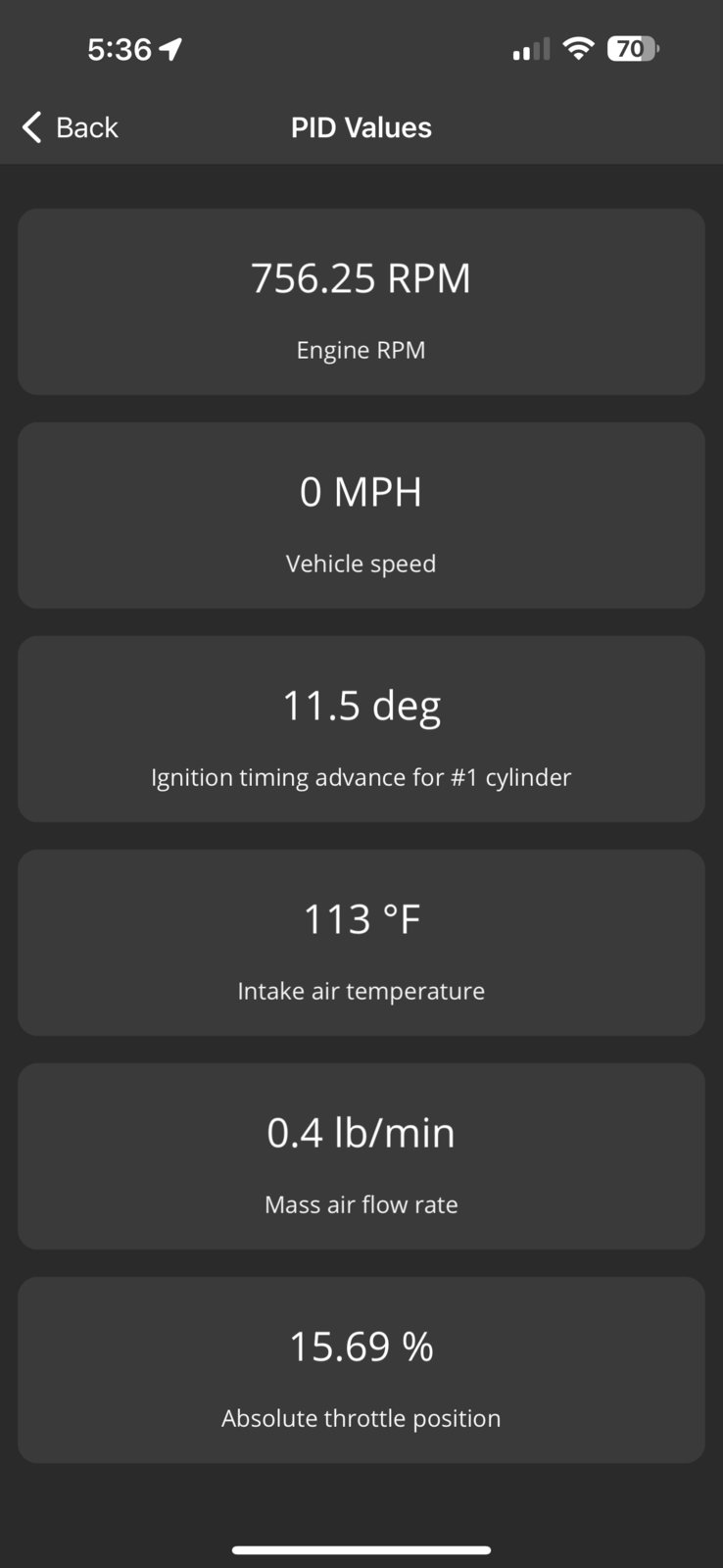

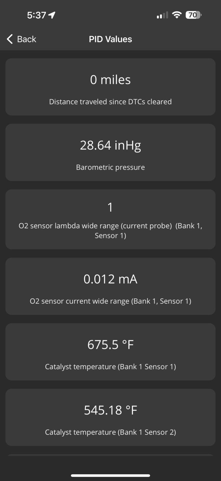

    My 3rd gen 2.7l has developed a weird idle when in gear and creeping. I’m getting a rhythmic vibration when I let off of the brake to creep forward in situations like drop off line at my kids school. Does anybody see any issues with what I pulled from OBD fusion? See screenshots below. I appreciate any help or advice.

    Yes that was live data. You're not going to believe what was causing this. Something I never put together was that the RPMs never dropped during this so it couldnt have been engine related. Turned out it was my tires causing the weird shaking when coming to a stop. Never did I ever think that would be the cause. My tires had around 65000 on them so it was time to get new ones which I did and the shaking went away. Never thought tires could cause that shake at that low of speeds but that was definitely the issue.
