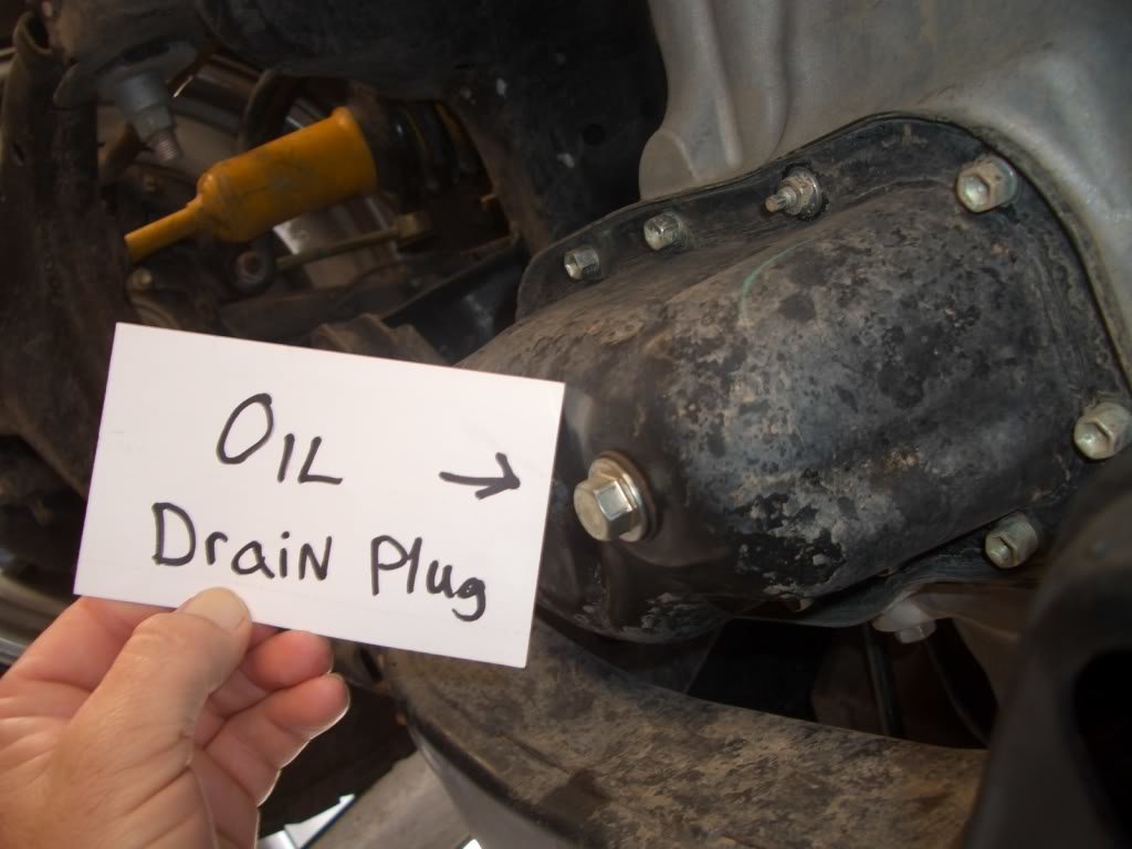

    Sounds like you drained your AT fluid, and overfilled your oil.
    https://www.tacomaworld.com/threads/halp.33318
    oilchangeplug006_5f73c0c053c234615142f5744855e371044a1036.jpg oilchangeplug004_d4f8ba80e4ffe1ec2c82b39feb247f80435a47df.jpg

    If you get your oil changed at a quick lube place it might be a good idea to get a paint pen and write "trans fluid" next to the transmission drain plug.
