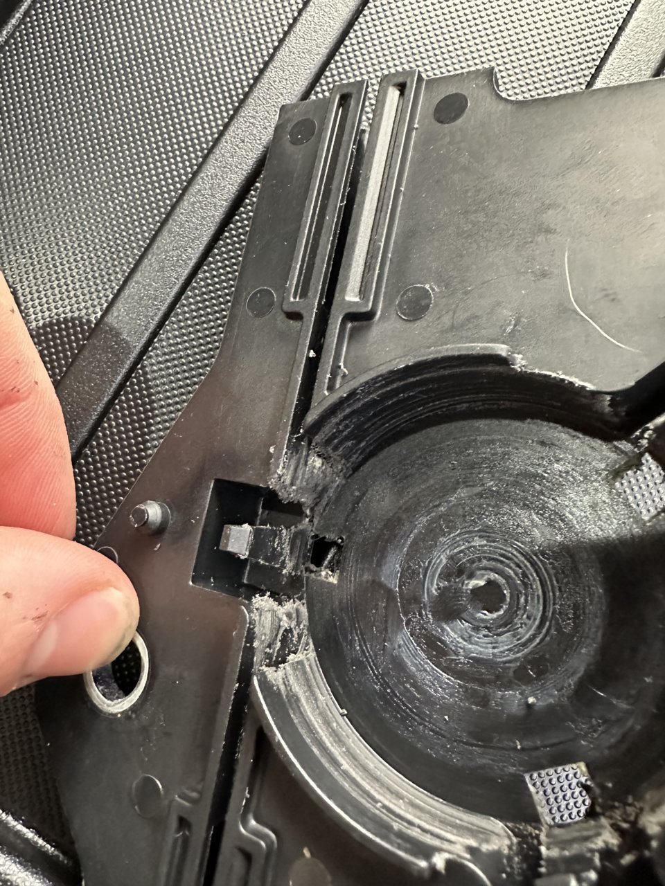

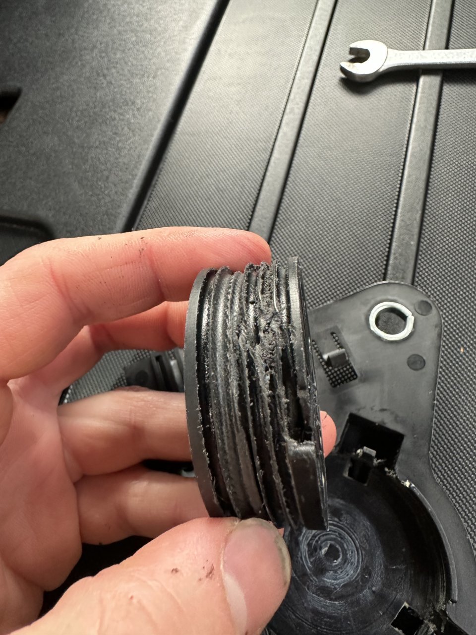

    Update: After long enough, I found the time to take the rear window mechanism apart and I quickly found the problem. So I guess the window was broken at some point, because I saw broken glass all under the plastic storage trays. Originally I thought there might’ve been glass in the track like some of you said, but I was putting my ear to different parts while someone pressed the switch, and I found out that the noise was coming from the regulator. Took the regulator off the motor, and quickly found my problem. The cable guides in the wheel were completely shredded, I saw the plastic dust everywhere the second I took it off. Also dug grooves into the housing too.
    I ordered a new window regulator, part number 69088-04010, which ran me around $43. Comes with a new regulator and cables which is good. My one cable end was really chewed up and twisted, the end that went into the wheel.
    Pictures are below. Just placed the order for that and another part I needed, will update when I have the parts and put it in! Thanks!

    Wow, that would definitely be the source of noise.

    Just maybe :rofl:
    I wonder how it happened though, I wonder if the shop who replaced the window may have taken it apart and screwed with it, and maybe lost some sort of piece inside the regulator causing it to grind. Or they could have dislodged a cable or put it in wrong, or the cable dislodged itself which seems rather unlikely. I just don’t think it happened itself, since it seemed like someone had to have messed with it for it to do that.

    I wonder if this could of happened from trying to open a frozen rear window. I don't dare try to open mine in the winter now.
