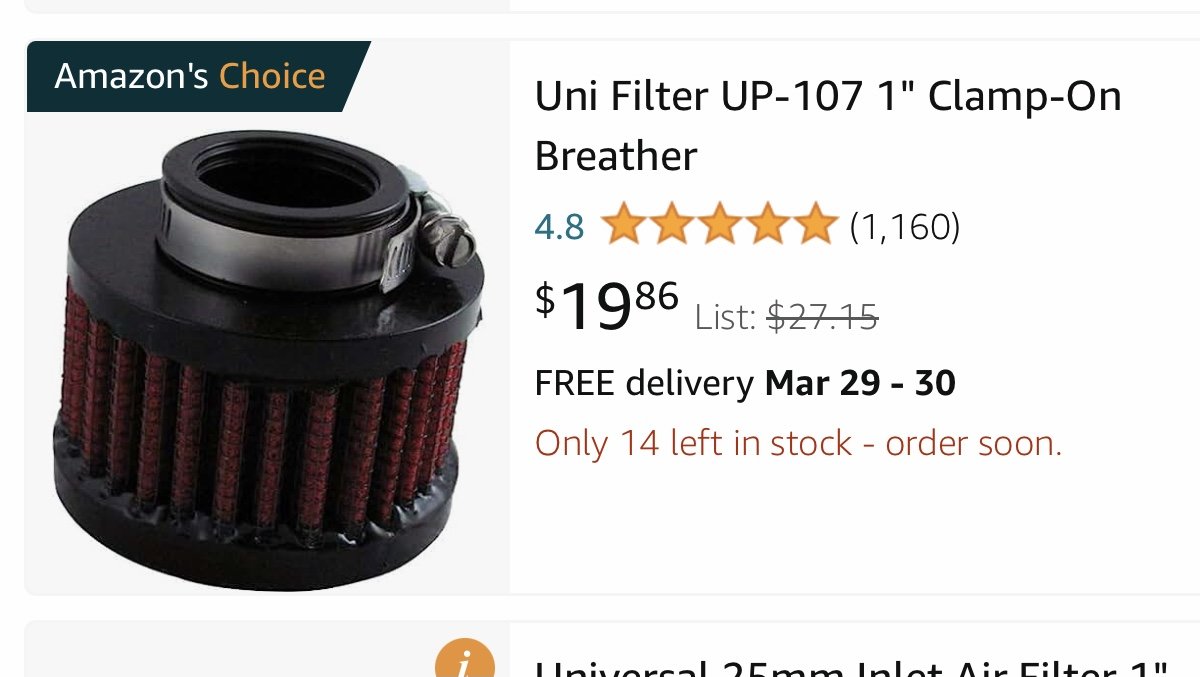

    You may want to look into doing the Uni filter mod as a preventative measure to keep the foam filter from getting sucked into the valves.

    I checked my foam filter and it's ok BUT i would like to upgrade. The only Valve breather I can find is a K&N, would that be too restrictive? I don't think that you can oil it either?? What's your thoughts?

    I don't think so, it should be very similar to the Uni.
    No need to oil it, it's just there to keep bigger stuff and bugs out it's not an engine air filter.

    Maybe I am over thinking things but, I have a breather that is meant to insert into a valve cover that would fit. Would that be adequate enough to filter the dirt?
