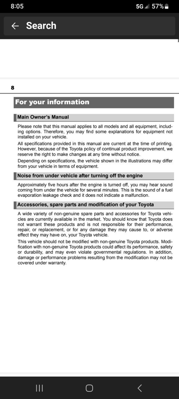

    I have a 2018 manual transmission Tacoma. Yesterday I heard a noise like a small electric motor or something coming from under the rear of it (click the link below - let me know if that doesn't work). The truck had been off for about five hours. I turned it on and backed it out of the garage, let it run for a minute or two then parked it back in the garage and turned it off and there was no more noise.
    Any idea what it could have been?
    Thanks

    EVAP purge

    EVAP pump.
    Normal. Nothing to worry about.

    did you read the manual?
