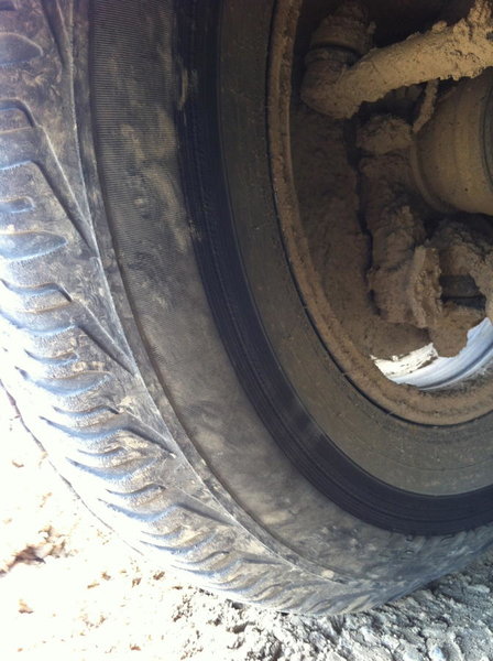

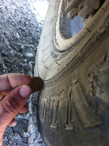

  16. Jun 15, 2012 at 11:05 PM

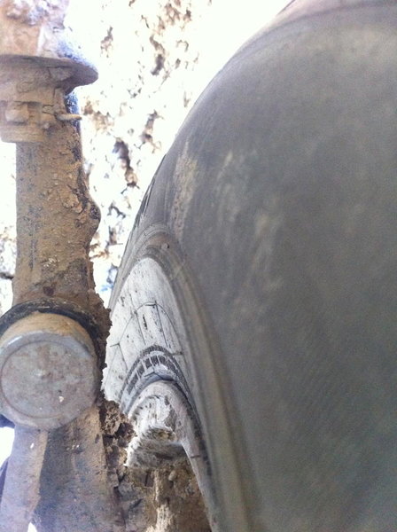

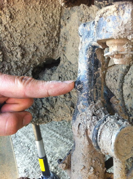

  17. Jun 16, 2012 at 12:18 AM
    #37
    Jimmyh
    Jimmyh Well-Known Member
    May 16, 2012
    #78991
    14,243
    SC
    2012 Prerunner SR5
    I would worry about the sidewall as those are some deep grooves. Esp on the drivers side.

    ProForce
    ProForce IG @proforce.expeditions OB#5411
    Oct 12, 2009
    #24205
    7,078
    Anthony
    Alaska
    09 MGM TRD Sport DCSB 4.0 Auto 2wd
    Too many to list. See build page. Link in signature
    I know what the problem is now.. I just installed 265/70/17 BFG TA KO on my stock TRD Sport rims about 2 months ago. Everyone says these tires won't rub but I get the exact same marks on mine. Yesterday I had my front wheels off to check my brakes and found the spot that rubs. It the LCA. I will post pics in a minute...
    These are in both sides but my driver side is worse just like yours. This is hard to see with the tire on. And as far as that little knob or knuckle goes, mine also looks like it is rubbing and is shinny but I can't find where it could possibly be rubbing. They were shinny with the stock tires too so it can't be anything bad.
  19. Jun 16, 2012 at 7:35 AM

  20. Jun 16, 2012 at 7:35 AM
    #40
    Swamp Donkey
    Swamp Donkey Well-Known Member
    Jul 15, 2011
    #59966
    179
    Fort St John B.C
    2011 4cyl SR5 auto 4x4
    Simply amazing. I took more pics than what I posted. Will have to do some Dexter like forensic studying of them to see if it was also rubbing on my lower control arm. I wonder if it is from going around a corner at full turn and hitting ruts and bumps in the road? Or did something get caught in there. Just because I have 2 totally different grooves.
