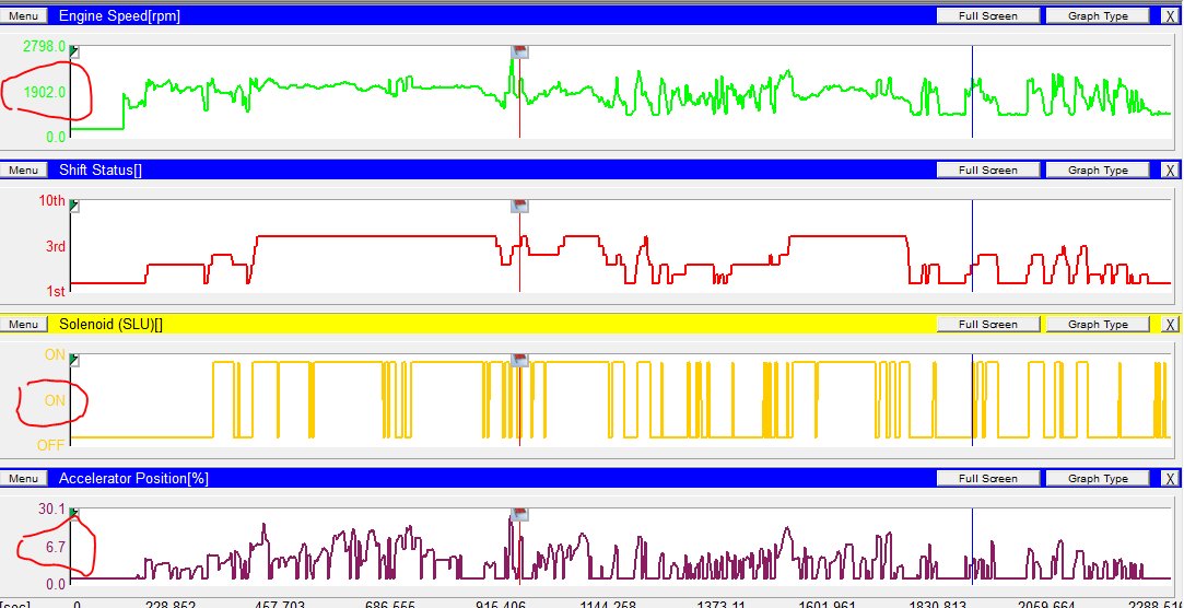

    Torque converter solenoid (SLU) kicks in, your rpms drop by 200. New models even have it in 2nd.
    Imagine this happens every day while maintaining acceleration on a steep hill... And this part won't fix itself by imaginary learning process.

    here is the illustration.
    the upshift to 3rd happened, SLU turned on at 1902 RPMS and accelerator pedal 6.7 %

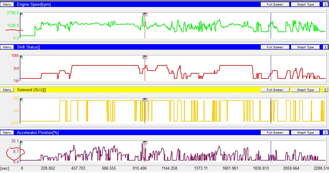

    Next techstream frame:
    Rpms went down to 1528 with accelerator at 8.7%. There is 374 rpms loss in a second while accelerator is being pressed.
