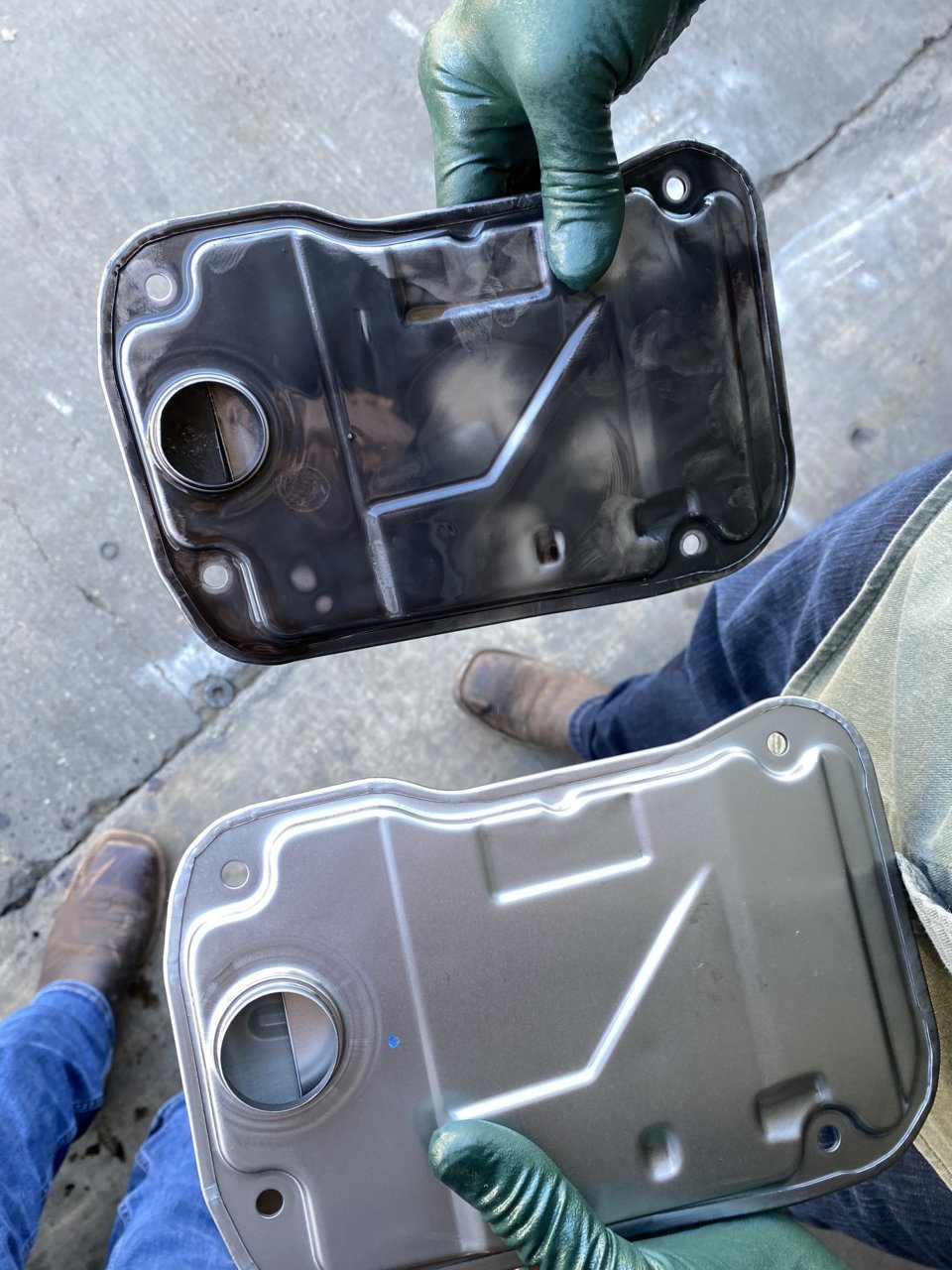

    Went to change the fluid and filter today and this is what I found. I’ve only put 2k on the truck since I got it. We’ve come to the conclusion that the clutches for gears 4 and 5 are burnt out. I don’t want to rebuild, so I’m gonna just buy a new transmission.

    Reman? Used? Should be plenty of used ones lying around at junkyards
